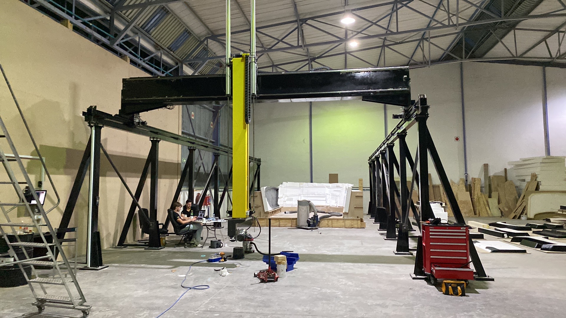

Hi guys
I am new to this forum and Linuxcnc.
I have a big 5 axis Cnc router that just been fitted with a Linuxcnc controller. We are having a issue with the Machine, when running 5 axis simultaneously the machine is super slow but then running test G code the machine speed is absolutely fine. So we have established it can only be a problem between the CAM and the post processor. The first Post we used was an old one that did not have time inverse so I downloaded the latest one from fusion for Linuxcnc, and the guy who installed the system for me modified the post for me I haven’t tested it yet, but we have tested a G code sample that was running G93 and it did not work. If you guys have any input or knowledge of how we go about to solve this problem, I would be really great full.
another issue is every time the machine finished a job and the head does not return to 0 the machine will give me a joint mode error and it will loose the z 0 position aswell as the tool offset, so I need to home the machine every time?

Damn, that is a big machine!
And that is really not the place to have a table with people!
This is fuzzy to me but there is a video of something similar that i remembered a while back
Maybe it helps...

try to compare the feedrate between the test and the exported code, the linear movement is probably fine as far as the ‚‚F‚‚ values at the end of the command lines starting with G1 G2 G3 are concerned..however if the same feedrates also have rotating axes I think it will slow down machine. because linear axes imply distance/time and rotary axes deg/time.
