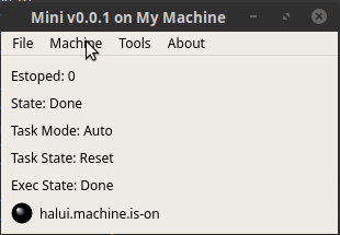

24 Mar 2019 15:00 #129475
by KCJ
Replied by KCJ on topic How to add HAL pins to QtPyVCP?
The only HAL widget we have so far is the HalLedWidget for indicating BIT HAL pin states of existing pins. To use it place it on a window and set the hal_pin_name property to the name of the pin you want it to reflect.
This widget does not create a new pin, but works much like HALMeter to show the states of existing pins. This widget is going to go away and I am going to add a support for reading HAL pins from the widget rules. I am also going to add support for read/write HAL widgets that create their own pins much like the pyvcp widgets.
HAL LED Demo indicating the state of the halui.machine.is-on pin.
