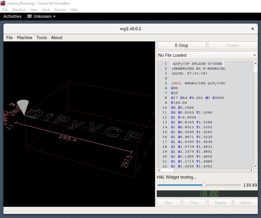

Kurt,
Again fantastic work. With the HAL functionality you have now truly created a fully customisable VCP environment!
A really simple test.
custom_postgui.hal
Result:
Nice!!
Scott
| HalSlider - objectName: | bed_temp_SP | |
| HalLabel - objectName: | bed_temp_PV | |
| HalLCDNumber - objectName: | bed_temp_SP_LCD |
custom_postgui.hal
net bed-temp qtpyvcp.bed-temp-SP.out-f => qtpyvcp.bed-temp-PV.in
net bed-temp => qtpyvcp.bed-temp-SP-LCD.in-fResult:
Nice!!
Scott
Last edit: 14 Apr 2019 20:05 by scotta.
The following user(s) said Thank You: KCJ
