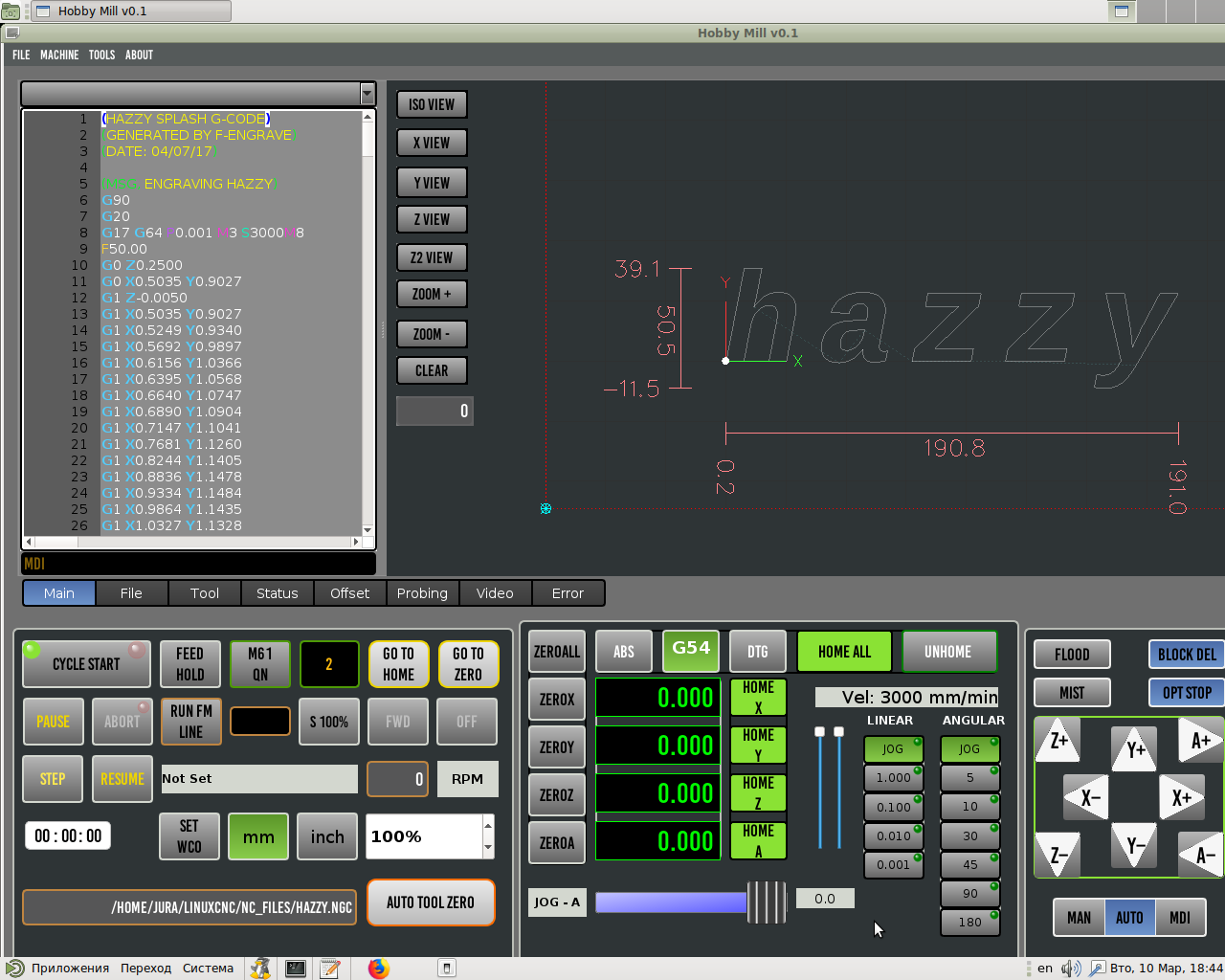

Hello! Please tell me how to parallelize JogIncrementWidget to create JogAngularIncrementWidget so that they work independently of one another, like in the qtdragon interface for example. Thanks in advance!

Thanks for attention! I am creating an interface on QtPyvcp based on different interfaces for myself. I give Qtdragon as an example in the jogincremental part.
I want to find out if this is possible in qtpyvcp, if possible, who knows how to implement this.

Thank you so much for your attention! It is very well implemented in Qtvcp qtdragon xyza. I created two action button Group. Implementation of increment_linear is not difficult, and increment_angular I can not overpower. No english
and python I will not master. Beat bi is great to add increment_angular_Widget to Qtpyvcp. I am very pleased that you were interested. Thanks to you, I almost created an interface for myself. Thanks.

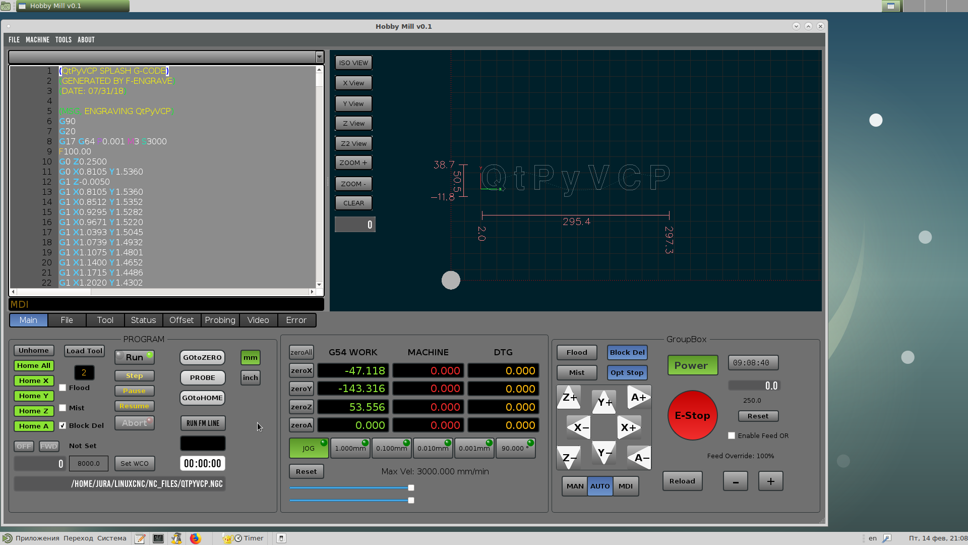

Hello. I created a clone of JogIncrementWidget called JogAngularIncrementsWidget.
I registered it in the Info file. Intervals with Display INI are displayed correctly in both widgets. But I can’t make them work independently and work out the specified interval from clicking the axis button. Help me please . Everything is in the attached widget but I don’t know how to register them in these widgets.

It looks like you are confusing QtPyVCP and QtVCP files.
The INFO.txt file and the image you posted looks like they are based on QtPyVCP, the jog_increments.py file you posted is from QtVCP, which uses a different code base.
Kurt

I don’t confuse anything, jog_increments.py file is for example. JogIncrementWidget QtPyvcp does not work correctly. Preset intervals work while holding the axis button even 1mm. In all interfaces, it works from the click of a button. I am an old illiteracy pensioner and I thought that the correct algorithm of work was laid down in the jog_increments.py file. Please tell me how you can do this in QtPyvcp so that JogAngularIncrementsWidget
acted only on axis A.
