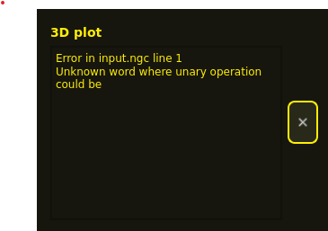

Hello Rodw,
I’m also using the Plasmac post from SheetCam. I followed your advice and changed the SheetCam setting to output .ngc instead of .tap. Unfortunately, as long as the Monokrom filter is enabled, it doesn’t work—I get the error:
“unknown word where unary operation could be.”
This happens both on my actual machine and with the Monokrom simulation configuration. With QtPlasmaC, I don’t have any issues. Maybe over the weekend I can share a G-code test file that fails for me.
Is there a way to manually apply the Monokrom filter plasma_gcode_preprocessor to a G-code file outside of Monokrom, just to see what the output looks like?

10 Dec 2025 15:02 #339946
You might be able to view the file-as-run in the GUI though, and see something odd around (I stress "around" as the reported line number can be off by several lines)
Unary operators are things like SIN[] COS[] etc so I would be looking for unexpected square brackets.
Replied by andypugh on topic MonoKrom - QtPyVCP GUI for PlasmaC and Mill
Does Monokrom have an option to save the current G-code file? (I can see that it might well not have, as you can't typically change the file in the GUI, so there is no point).Is there a way to manually apply the Monokrom filter plasma_gcode_preprocessor to a G-code file outside of Monokrom, just to see what the output looks like?

Okay it is possible to pre-process the g-code manually like this:
1) Launch an instance of Monokrom (sim)
2) Navigate to the Monokrom Simulation Config Directory. Open terminal there and set environment variables
3) Call preprocessor in terminal with the input.ngc processed by the SheetCam PlasmaC Post
The output is the processed.ngc. The first few lines are below:
This is why I get the error in input.ngc line 1: Unknown word where unary operation could be. The first line contains "Filter name: from-ini func: <function from_ini at 0x7ff0a03176a0>".
~/linuxcnc/configs/sim.monokrom/plasmac$ export CONFIG_DIR=$(pwd)
~/linuxcnc/configs/sim.monokrom/plasmac$ export INI_FILE_NAME=$(pwd)/xyz.ini3) Call preprocessor in terminal with the input.ngc processed by the SheetCam PlasmaC Post
~/linuxcnc/configs/sim.monokrom/plasmac$ python3 plasma_gcode_preprocessor.py input.ngc > processed.ngcThe output is the processed.ngc. The first few lines are below:
( Plasma G-Code Preprocessor )
( 00.30 )
;inputs
#<ucs_x_offset> = [#5221 + [[#5220-1] * 20]]
#<ucs_y_offset> = [#5222 + [[#5220-1] * 20]]
#<ucs_r_offset> = [#5230 + [[#5220-1] * 20]]
#<array_x_offset> = 0.0
#<array_y_offset> = 0.0
#<array_columns> = 1
#<array_rows> = 1
...This is why I get the error in input.ngc line 1: Unknown word where unary operation could be. The first line contains "Filter name: from-ini func: <function from_ini at 0x7ff0a03176a0>".

Replied by Joco on topic MonoKrom - QtPyVCP GUI for PlasmaC and Mill
That bug should be resolved in recent builds of the framework. Its not a monokrom bug. It came out due to an errant print statement.
"What's the first rule? Do NOT use print statements in the code. Use LOG.debug"
