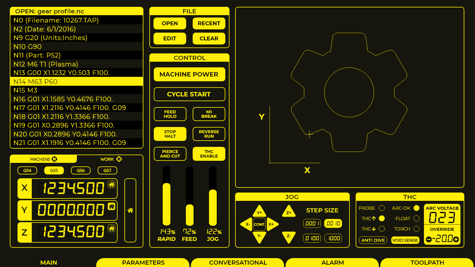

hello everyone.
I want to make a new gui for my PlasmaC Machine.
PlasmaC axis and gmoccapy work just fine, I just want to make an exclusive GUI. Can anyone guide me.
Moreover, other thing I want is that my system boots directly to the Plasmac, just like Pathpilot. If we want to desktop, there should be some key combination.
Pathpilot is based on linuxcnc if that can do it, linuxcnx should also.
Thanks in advance.
Update: 01/10/2020
MonoKrom is the decided name.
@KCJ is working hard in qtpyvcp.
05/10/2020
added VCP for Mill MonoKrom-Plasma & MonoKrom-Mill
You can install semi-working GUI from github
This is the result so far.
After discussions monochrome yellow is the way to go.

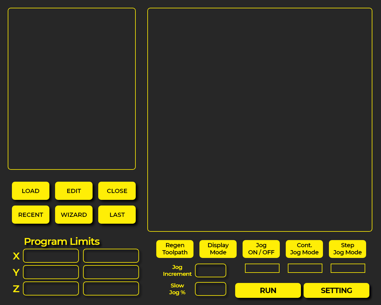

6 years 1 month ago #182819 by pinder
Replied by pinder on topic qtpyvcp Gui for plasmac
This is a sample of GUI
I am targeting touch screens. After working out the GUI I will also share physical control panel plans.
