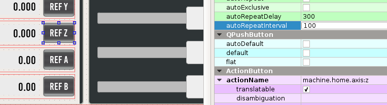

I just installed probe_basic and ran into the problem, that when pressing the Ref Z button, my CNC references the X Axis. When I change the .ini file to gmoccapy being the UI it does not do this, so I asume it has to do with probe basic. When pressing the home all axis button everything works and each axis is homed in the correct order.
Is this a known bug or does anybody know how to fix this?

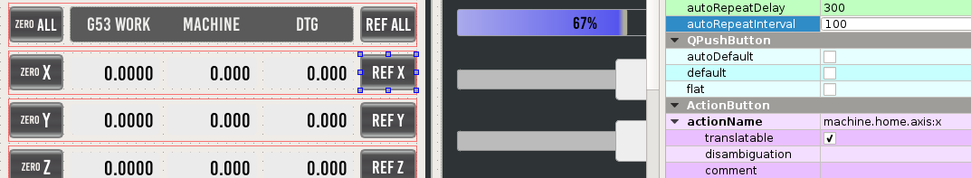

03 Feb 2021 02:07 #197509
by Lcvette
Replied by Lcvette on topic Ref Z references X axis
- mf290997
- Posts: 20
03 Feb 2021 02:09 #197510
by mf290997
Replied by mf290997 on topic Ref Z references X axis
The issue is only present when pressing the REF Z button. Where can I find these configs shown in the screenshot? or can yo check if the REF Z button says machine.home.axis:z?

03 Feb 2021 02:14 #197512
by Lcvette
