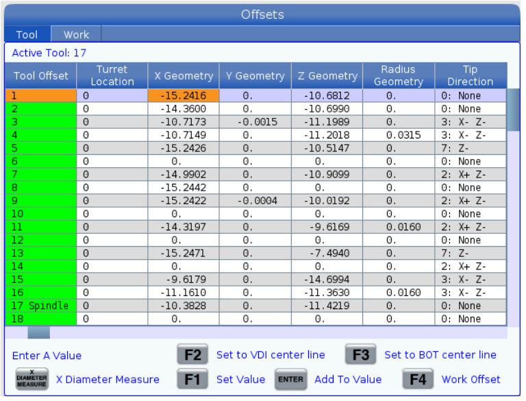

I'm not a 'lathe' expert, but having run my Fanuc live-tool XZC turret lathe for a year or so now I thought might add something about lathe tools...
In some cases, you can have multiple tools on a single turret station. This is more common on larger, newer lathes but its not that rare to set up a couple tools on a single holder for other lathes. Imagine having a tool holder (VDI, BMT, Capto, HSK, etc.) with a spot drill, tap drill, and tap all on the same block. Makes for very quick cycle times - much like a gang tool lathe - as well as freeing up an otherwise used turret station.
Controls are different, but on my somewhat elderly Fanuc 21TB there are 12 tool stations. However, there are 16 'slots' on the tool data page. Slots #13-#16 are used (by me) to offset a tool or have multiple tools in the turret station.
Example 1: T0101 calls turret slot #1, offset #1. If I have an end mill (or multifunction tool) and want to drill with it I want the tool center to be at X0. If I want to use the tool as a boring tool, then the control point is now the cutting corner/edge and I need to offset the tool 1/2 the diameter. In that case I would program T0113, with slot #13 being the first 'unused' offset in the table. The control point is now based on the different offset.
You could, of course, hand code all of this with a single offset, but for a CAM program it's simple. F360 permits posting tools with an offset different from the turret station for that reason.
Example 2: Similar situation as above, where you have a single tool holder with a drill and tap next to each other. T0101 is the drill, and T0113 (or whatever open offset slot you chose) is the tap. The program drills, then a "tool change" applies the new offset and the tap operation is done.
Obiously, it's not just an X offset, but Z offset as well. And Y-axis lathes are even more likely to have multiple tools in a single block.
How this multi-tool or single-tool, multi-offset is used dependent on the lathe control, but the above is how it works on my Fanuc. Regarding LCNC generally, and Probe Basic Lathe specifically, there may an opportunity to account for the above use cases. I find it cumbersome to remember which offset to use for different tools (or control points) in the turret, and like just about everything on a turret lathe can be a 'pucker moment' when you are proving out a program. Did I use the right offset?
Having a lathe tool table function like a mill ATC table with tool numbers connected to turret positions would require a change in thought process for 'lathe people' used to gang-tool or older controls (like mine). And post processors would have to change, of course, but I think having a single tool number which represents all the data - turret position, X/Y/Z offset, nose radius, wear, tip orientation, description - might be helpful in the long run.
I'll end with a screenshot of the Haas lathe tool table. No description field, but you just call "T1" and all the data for that tool is applied. No remembering different offsets for each station.
Just food for thought...
-Ralph

Correct, i also have 21T with multi center tool slot tool blocks. They are all still called by a turret position number which is my reasoning. In other words, T1 will always be turret position 1. You can have multiple offsets for that turret position, but it's still going to be the same turret position.
With mill, you can have carousel pocket, unique to number, unique tool offset. This made it nice to have a graphic showing what tools were currently loaded in the carousel. For help in knowing what to to call to change our etc..i just don't see that being mytv of an issue with lathe.
I'm not against it, i just don't see how it's useful. I'm not above saying i could be wrong, wouldn't be the first time..lol.

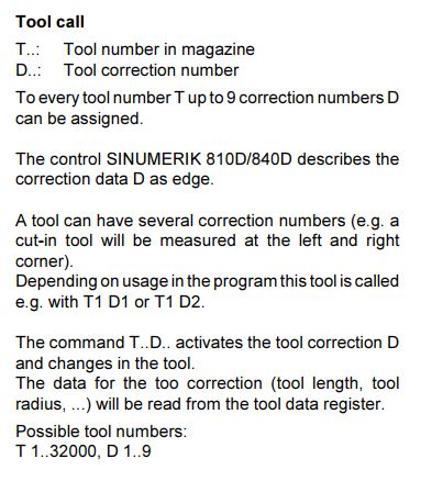

I'm frequently wrong, and this could certainly be one of those times.
Yes, we're in agreement - turret slot #1 is always tool #1... on an older control.
My thought was to get away from the (old) Fanuc model - which I can't stand. It just seem so ripe for disaster.
Consider the Siemens 840D tool table. There are tool numbers availble for each slot, but there are also "D" numbers. These are separate offsets associated with each turret position. You can have up to 9 D-numbers for each slot, and there's no need to remember "did I assign offset #13 to the #1 tool secondary position, or #14?" No random offset number needed to shift a turret position.
So a 3-tool gang block would be:
T1D1(spot drill)
T1D2(drill)
T1D3(tap)
It's different than the Haas setup (one number for all data), and I think I like it better.
BTW, what's your 21 control on? Mine's on an older Emco 325-II.
Siemens tool table function:

Hardinge Cobra 42...
whatever lcnc had is what probe basic works with, so not sure if it can do what your saying and if not, the gui can't add that functionality as is just accessing lcnc.
