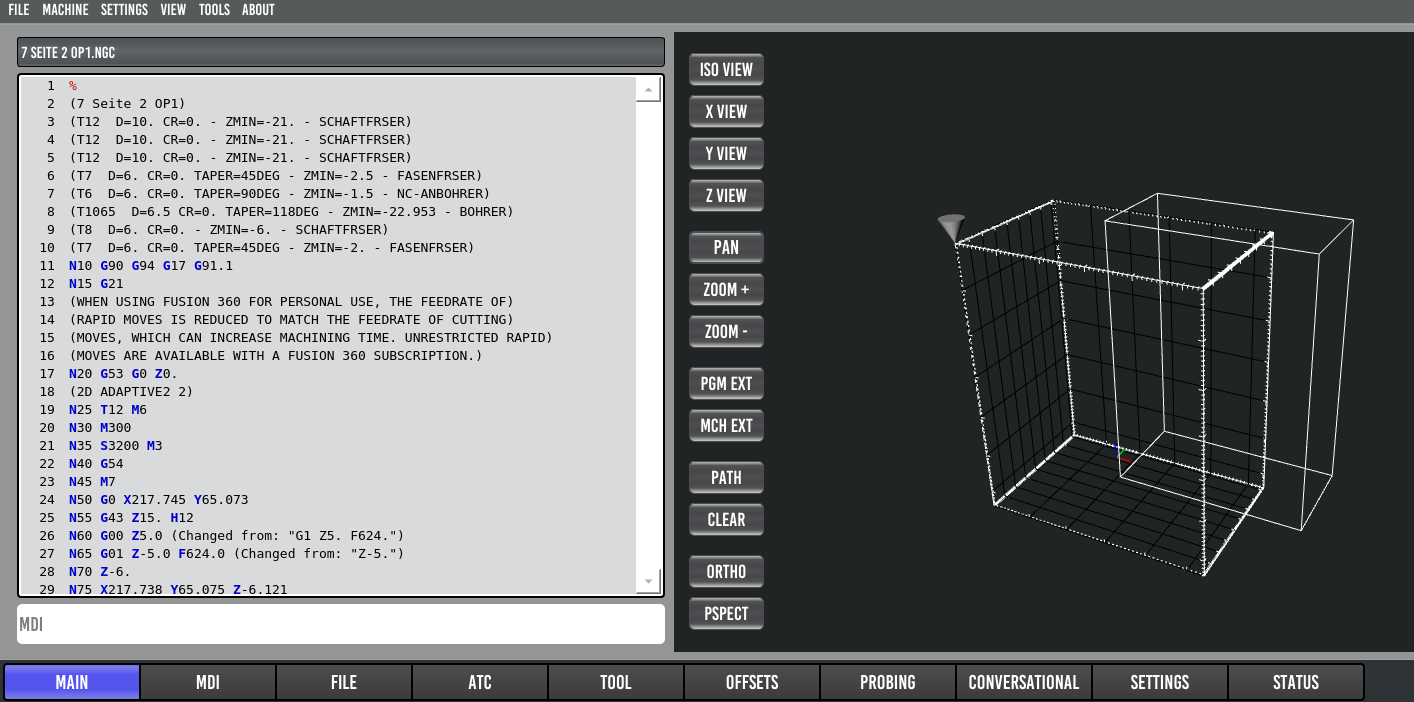

Hey guys,
I have a relatively new installation of probe basic for my DIY CNC router. I like the layout of probe basic, but the 3D area on the main screen won't show the toolpath that I have queued up for some reason like it does with the Axis GUI. It just shows where the tool moves in 3D space without previewing the toolpath. Does anyone know what's going on here?

I have the same problem. Linuxcnc 2.8 Probebasic 0.4.0 with "quick-install". No preview is shown of loaded gcode, only "recorded" movement with yellow lines.

here some infos:
Linux cnc 4.19.0-11-rt-amd64 #1 SMP PREEMPT RT Debian 4.19.146-1 (2020-09-17) x86_64 GNU/Linux
Linuxcnc 2.8.1
Probebasic 0.4.0
Quickstart
everything else is working fine
ProbebasicSIM shows same issue
Program boundarys are recognized, but no tool pathshown:
Linuxcnc 2.8.1
Probebasic 0.4.0
Quickstart

I just installed to test and no issue with the vtk as you describe so I'm going to venture it's a compatibility issue, can you provide your machine specifications and your video card and driver and openGL version.

Intel(R) Core(TM)2 Quad CPU Q9400 @ 2.66GHz
4gb RAM
NVIDIA Corporation C79 [GeForce 9300 / nForce 730i] (rev b1)
Kernel driver in use: nouveau
Kernel modules: nouveau
OpenGL version string: 3.3 (Compatibility Profile) Mesa 18.3.6
in axissim gcode-path shows up normally
tried nvidia drivers, which killed my system, had to reinstall linux
4gb RAM

axis uses a different backplotter that is not compatible with qtpyvcp, qtpyvcp uses vtk for backplotting and there are some known compatibility issues but it was previously thought to only be with openGL versions older than 1.5. I also know that rpi's have some vtk compatibility issues.
during the installation did you run the line in step 3? in terminal?
sudo apt install python-pyqt5 python-pyqt5.qtquick python-dbus.mainloop.pyqt5 python-pyqt5.qtopengl python-pyqt5.qsci python-pyqt5.qtmultimedia qml-module-qtquick-controls gstreamer1.0-plugins-bad libqt5multimedia5-plugins pyqt5-dev-tools python-dev python-wheel python-setuptools python-pip git python-pyqtgraph python-pyqt5.qtwebkit
and did it succeed or have errors?
