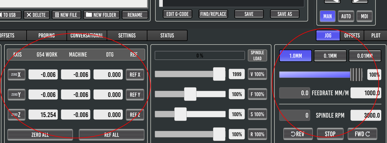

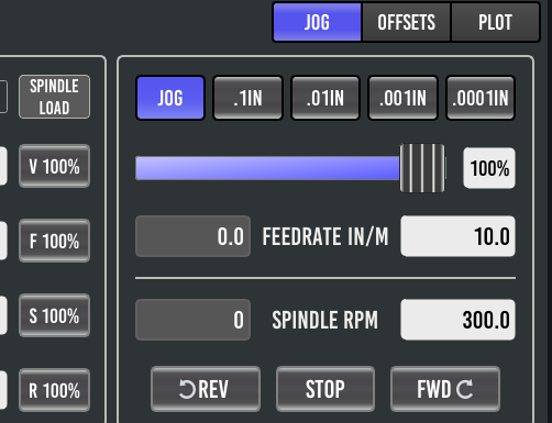

I have Probe Basic installed and running. It runs the machine just fine, but there are a couple of things I need to change.The display shown below is what I have. The circled area on the left is the cord display, I need it to show the A axis.The circled area on the right show selections for the jog increment. I need it to show JOG and 4 increments like in the second picture.
This is what I want for the jog increments.

Your INI file has INCREMENTS twice under [DISPLAY]. Comment out the first one (without the JOG) and see if that fixes your second issue.
As far as the first one goes, I can't see an error off the top of my head. Your INI file looks like mine did in all the sections before I robbed my 4th axis for an ATC - and my PB display had an A-axis DRO displayed.
I'll keep looking for whatever creates the extra A/B DRO's and let you know if I find it.

Spumco, good catch. That took care of the jog increments. I'll keep looking for the DRO fix. Please let me know if you find anything.

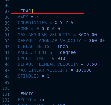

they automatically set the gui display based on the ini file, if you have only xyz in the ini, only xyz will display in the gui, if you have xyza configured in the gui, then you get xyza in the gui etc.. we made it fairly simple to display only what is needed via the already required configuration for linuxcnc.

His INI file had the right values to trigger the 4-axis display in PB. i.e GEOMETRY = XYZA, but was still getting a 3-axis display.
Thats why this was curious... PB wasn't acting as expected.

That makes much more sense now. Noted for future reference - [TRAJECTORY] and not [DISPLAY] that triggers the axis dros.
