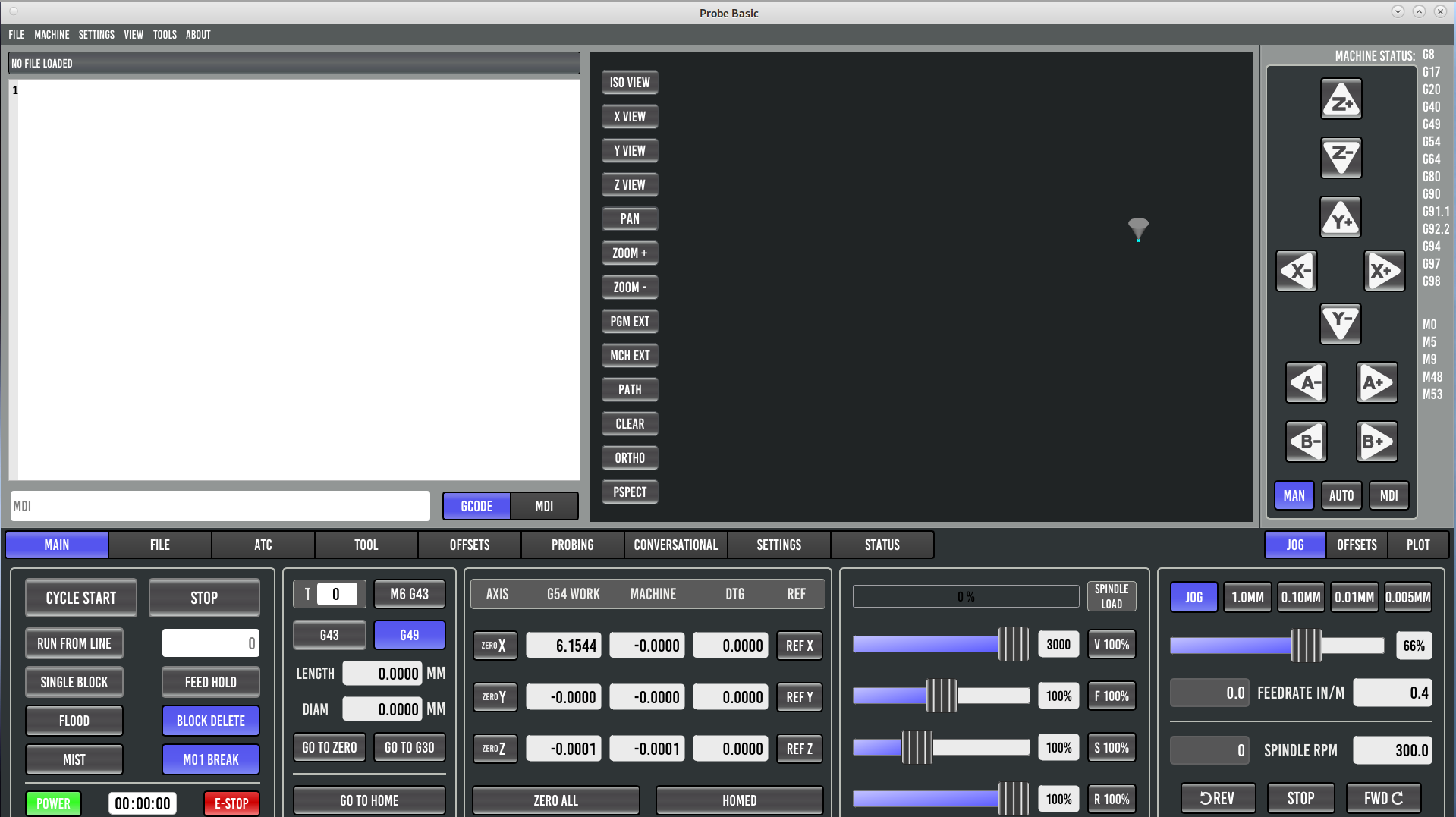

After seeing the last several posts I gave this another try. I have made sure I have AXES = 4 and COORDINATES = X Y Z A
in the [TRAJ] section
I still get the same result. The DRO only shows XY&Z the manual controls show XYZA&B. Even the sim on a fresh install only shows XYZ on the DRO and XYZAB on the manual controls.
I've installed and run Linuxcnc with Gmoccapy, Axis and QtDragon so I'm not stupid, but this is nuts. I know it can work, I can see that all 5 axis displays are available in the QtDesigner. I just can't get mine to display.
I would love to run this interface but I have to have the 4th axis.

Attached are my ini and hal files along with a screen shot of Probe Basic running on my machine.

the widgets responsible on show the correct DRO display had dependency on a deprecated stats channel called axes and got removed from linuxcnc master like 2 days ago,
i fixed the rule to get the DRO page by using this rule but i had no luck
int(bin(ch[0]).count("1"))-3 # this gives the count of bits at 1 from axis_mask
in a status label it shows the correct page number
but for some reason I'm unable to make it change to the correct page on boot so the first page is always shown

This is probably not the right way to fix this but it got me up and running. I now have the A axis DRO
All I did was change the axis_display_rule on the gui_axis_display_widget from status:axes to status:joints
At least now I can get the drives tweeked in.
