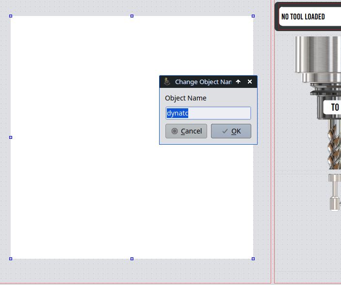

I tried on some qtpyvcp widgets, but still dont see a rules editor available.
Probe Basic example - the ATC widget doesn't show up on screen - it's just a blank white box. When I double click it, a change object name dialog pops up but no rules editor.
Screenshot attached.

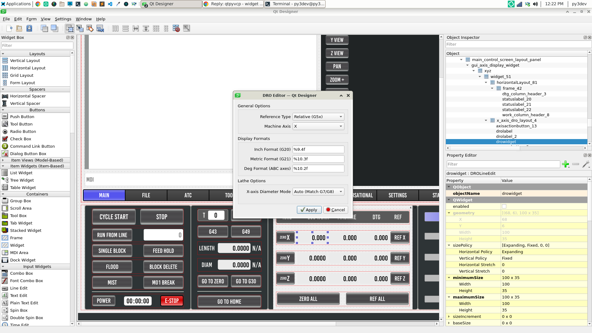

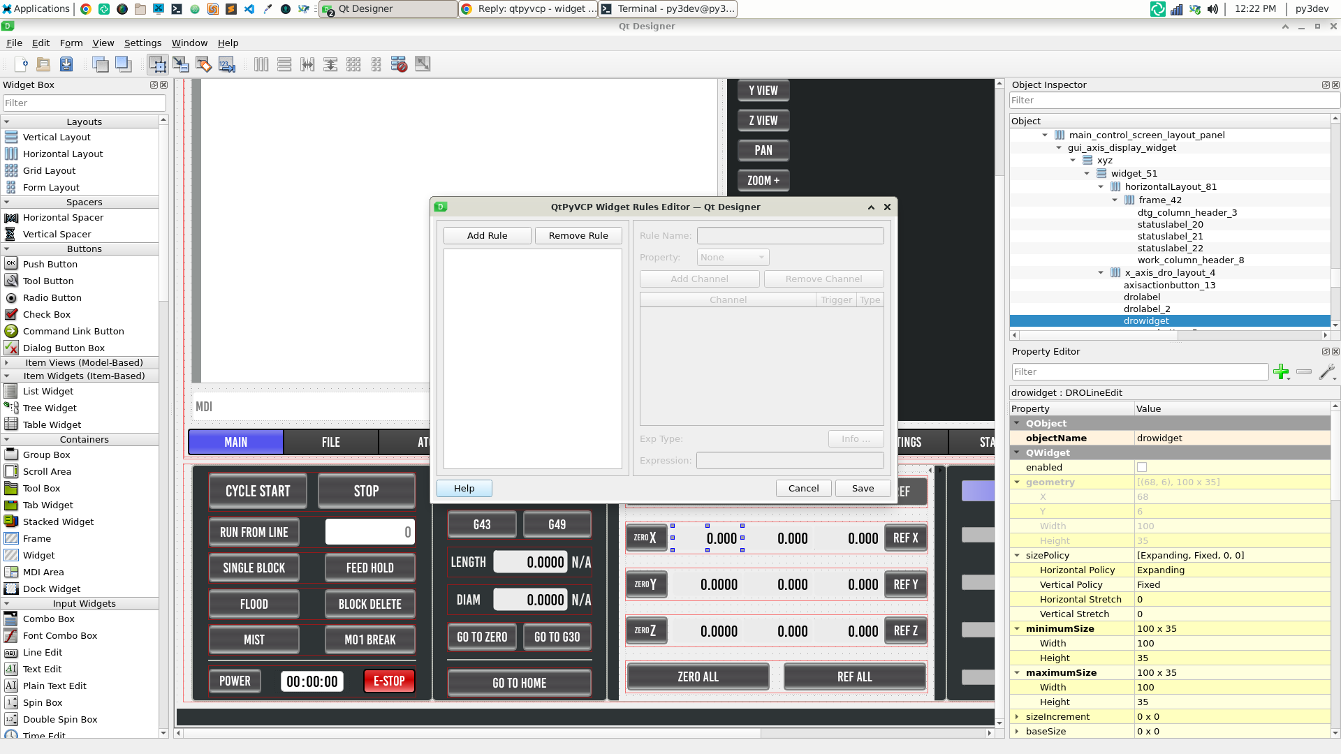

attached picture of the velocity rule

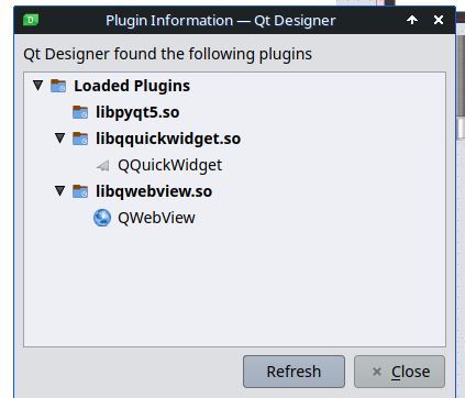

Attached screenshot of plugins loaded in qtdesigner if that helps.
