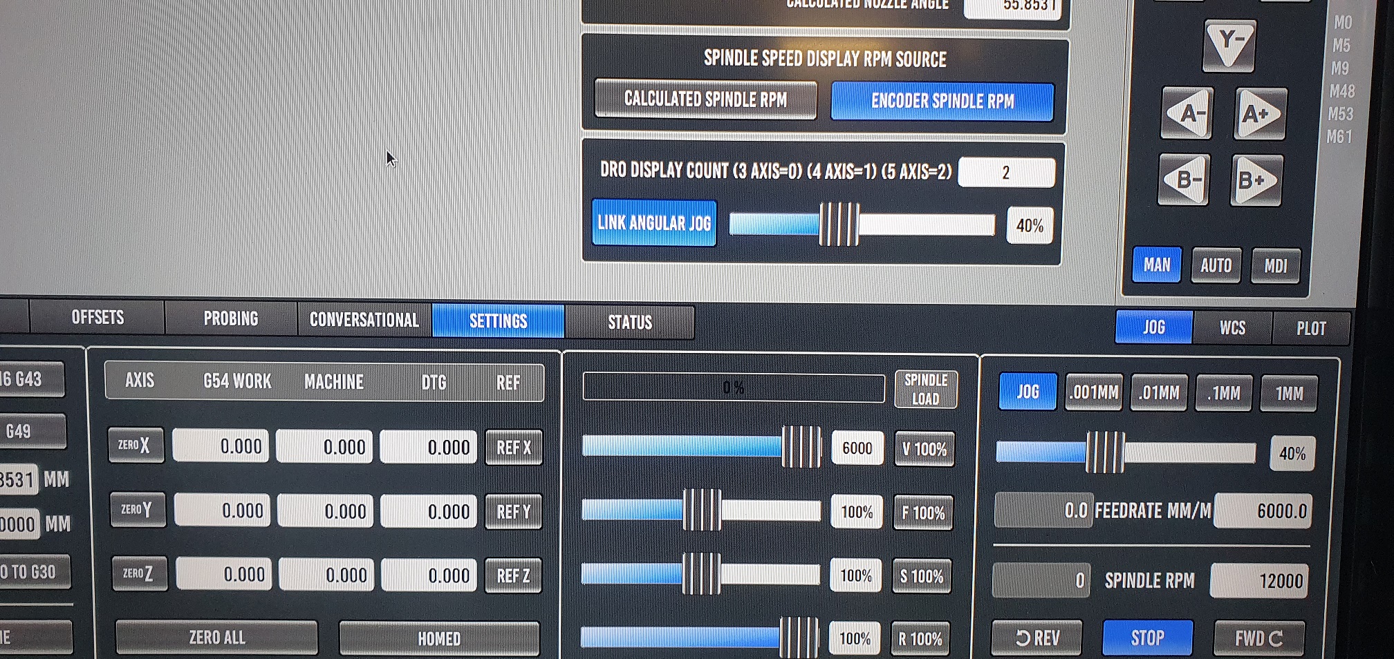

21 Jan 2023 08:42 #262564
by CNC_ANDI
Replied by CNC_ANDI on topic Rotary Jog low
Got the probe_basic screen...
Today i will check the config.
- CNC_ANDI
- Posts: 233
- Thank you received: 31

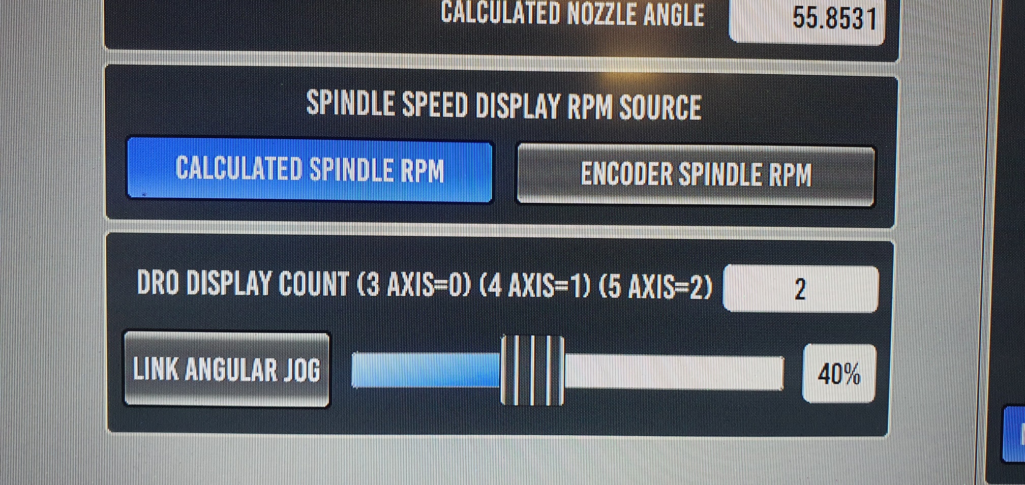

21 Jan 2023 10:34 #262566
by CNC_ANDI
ok got it work today....
so the dro displays dont work correctly. i´ve changed the number to 2 for 5 axis display, got work but when i close linuxcnc an reopen again des display changes ro 3 axis but the number 2 for 5 axis display was saved. now i most change the number an back again to get the 5 axis display.
- Lcvette
- Posts: 1682
- Thank you received: 784
21 Jan 2023 12:36 #262575
by Lcvette
Replied by Lcvette on topic Rotary Jog low
Yes, we are still working on a solution to that problem.
- Lcvette
- Posts: 1682
21 Jan 2023 12:37 #262576
by Lcvette
