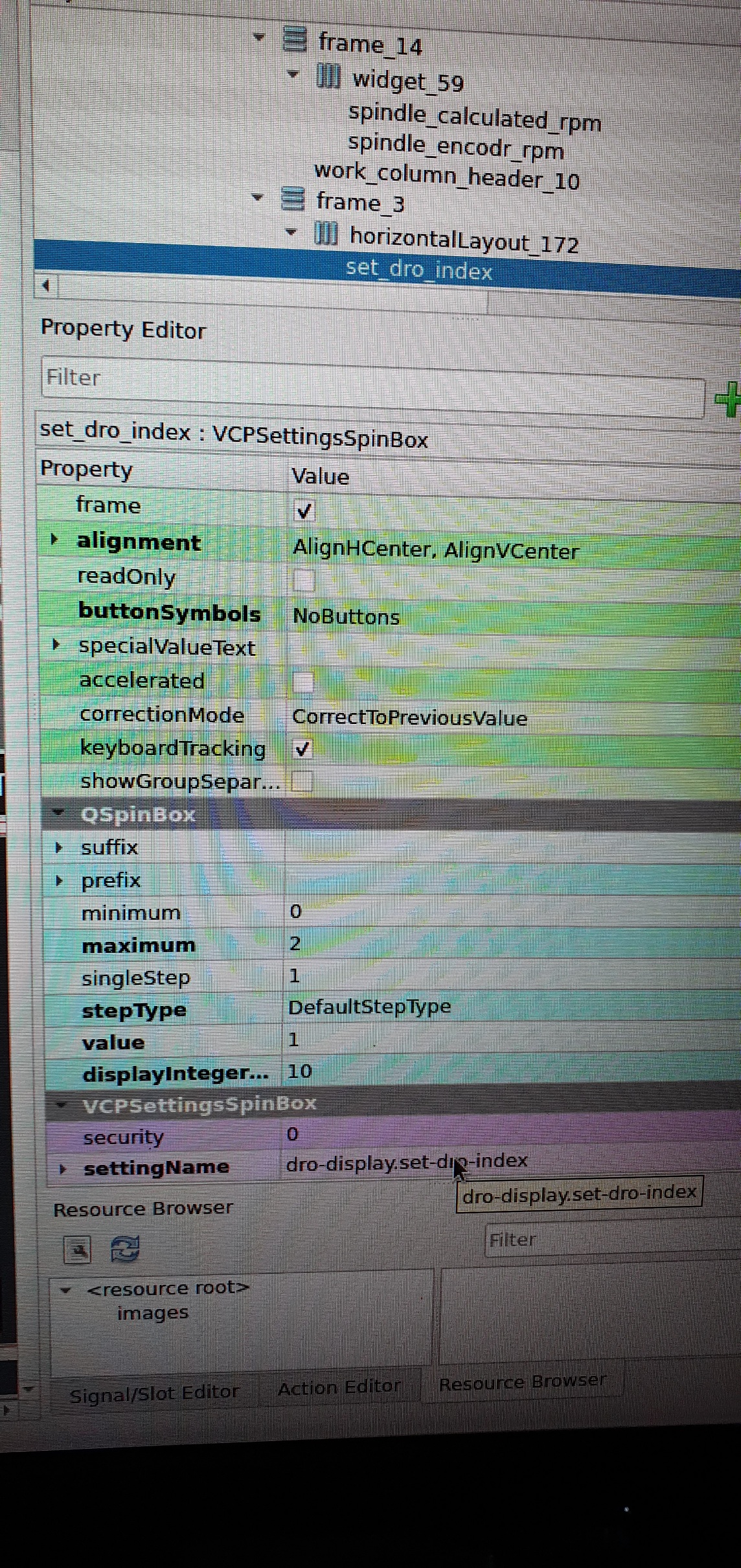

If you installed using the dev version you can resolve very quickly. In terminal run:
editvcp probe_basic
When designer opens, look at the dro display box, there are 2 arrows in the top right corner, click until your desired dro axis count is displayed. Then, save. If will now devalue to that drop page on start up.
editvcp probe_basic

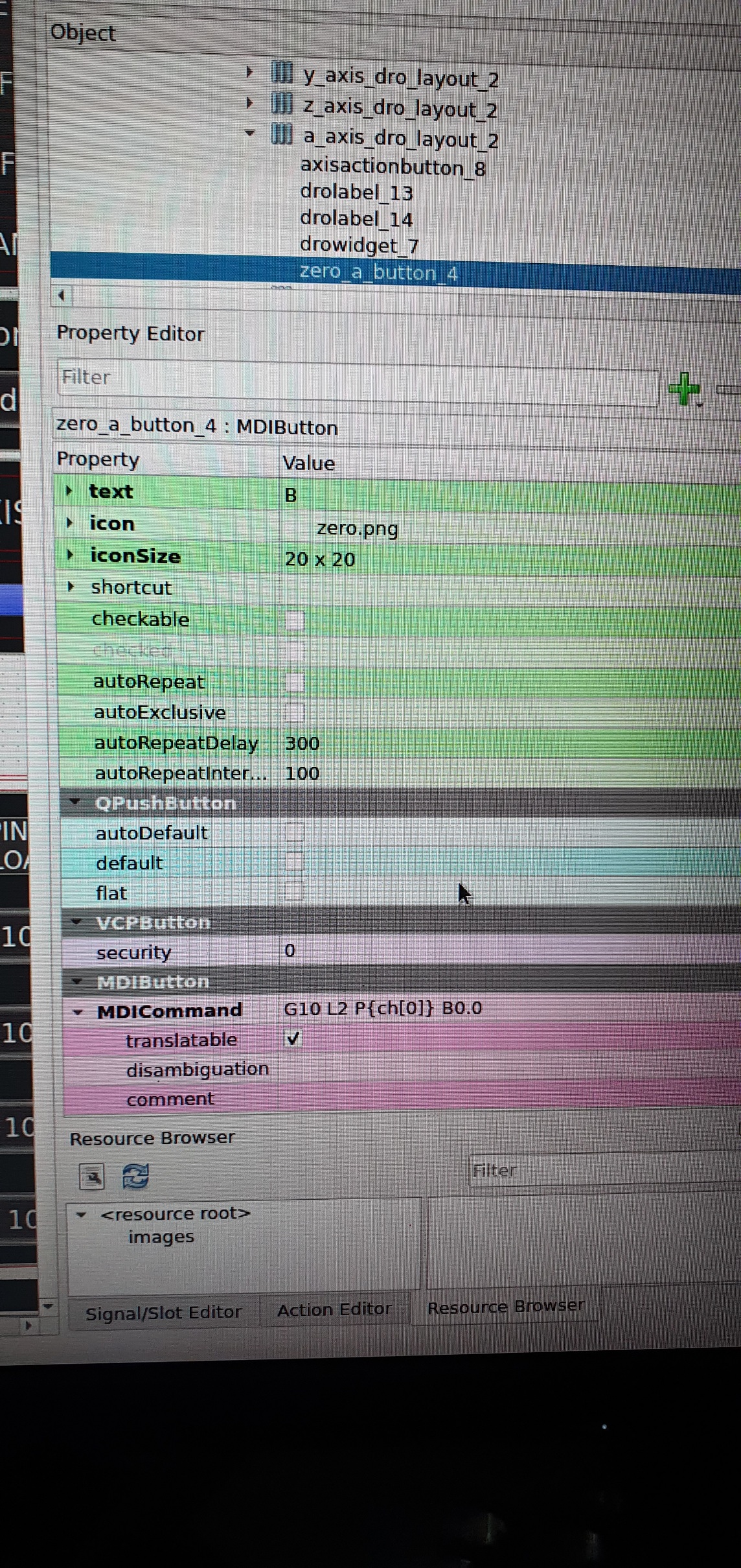

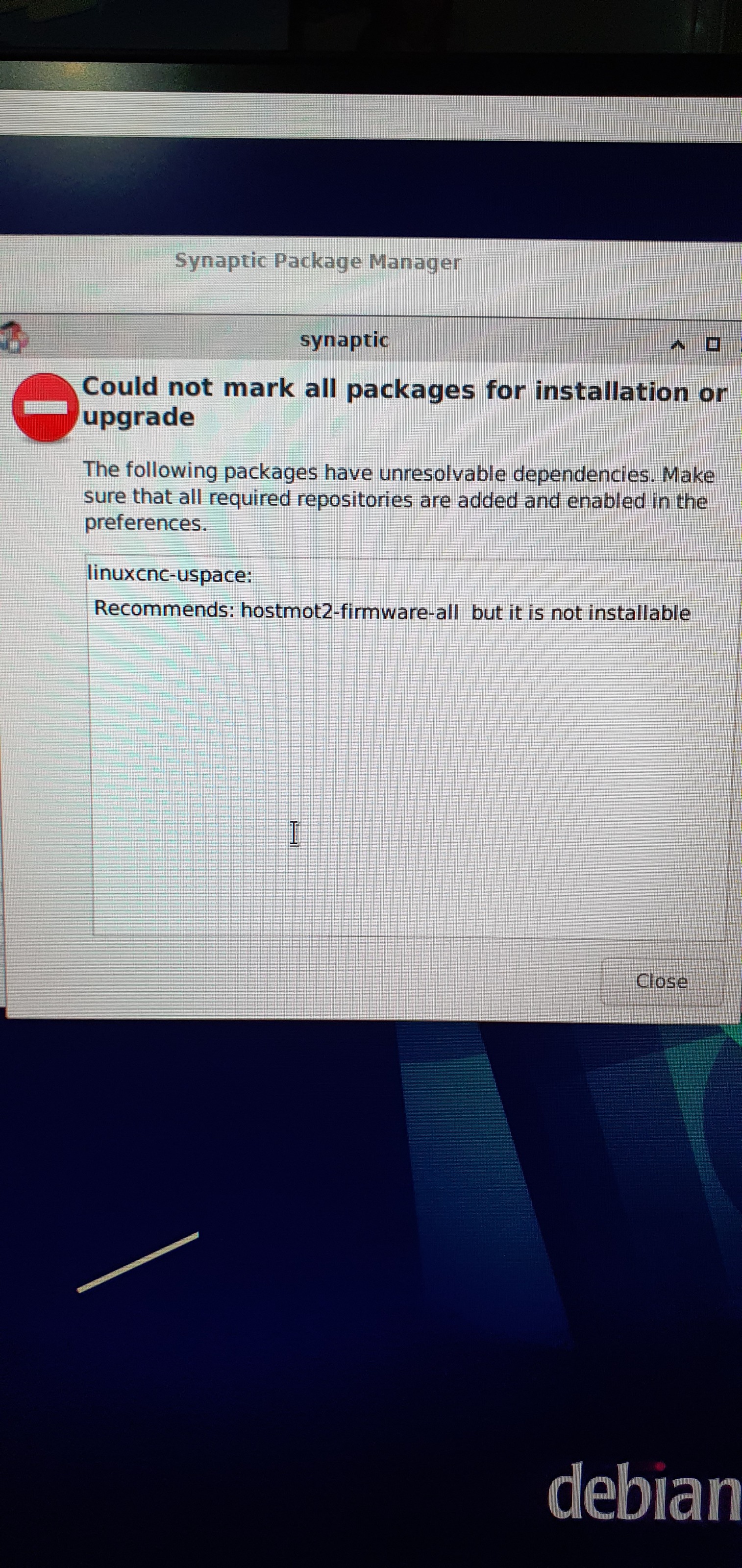

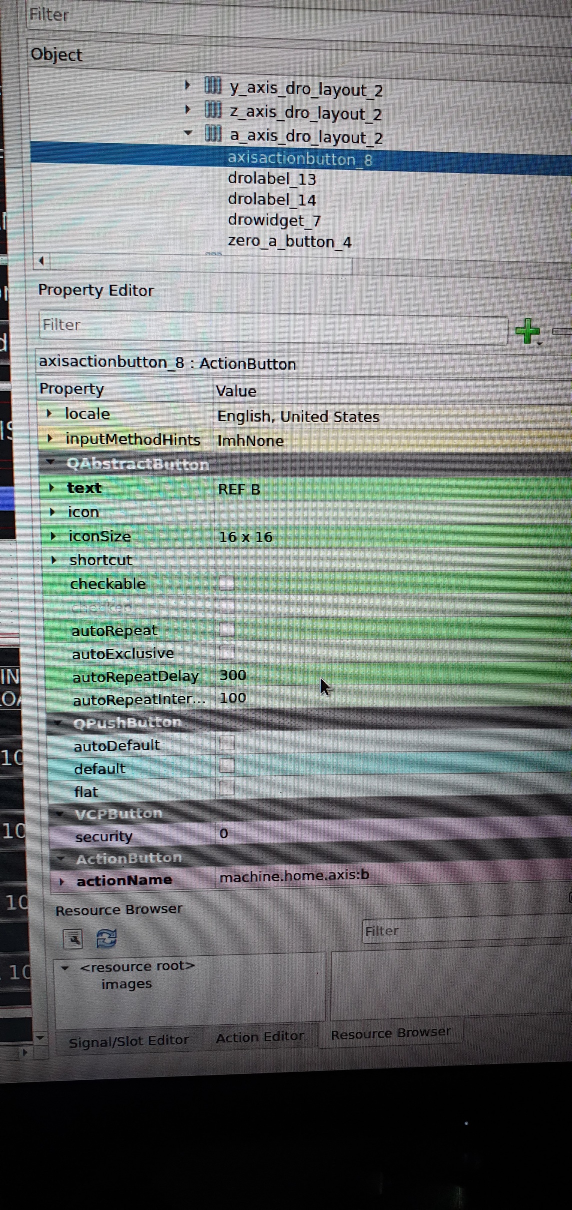

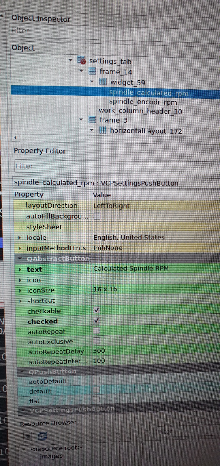

Hi, today i got editvcp to run.So i have changed the value from 0 to 1 for the 4 axis display and deselect encoder for spindle rpm and selected the other one.i changed at 4 axis display all a (for A Axis) to b (B Axis) to got a xyzb display....so will it work? Or i have to do more changes?Here are my
changes:
By the way... i've tryed to update linuxcnc-uspace from 2.10 pre0 to the latest pre... but got this error...
changes:

im not sure why you were changing all of that? to display the 4 axis dro page all you needed to do was click the stacked widget tab arrow to display the 4 axis dro page and then save the ui from the file drop down menu, it will then default to the 4 axis display. no need to change anything else. i would go back and undo those changes and follow the instruction above.
as for the update, you should be running 2.9 not 2.10, 2.9 is pretty close to be a lockdown version, 2.10 is not. it will have issues going forward most likely that will require compatibility bug fixes that you will not be able to access.

Hello thanks i will see how i can down to 2.9.
The standart dro is xyza. But i need xyzb.
I've made backup from the original ui so i can change back.
