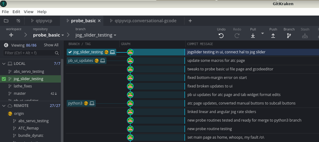

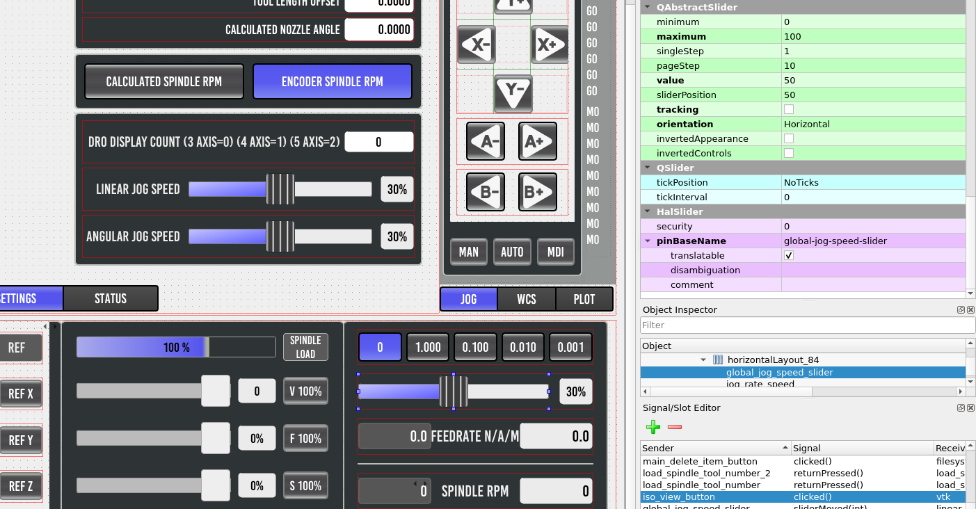

- Lcvette
- Posts: 1682
- Thank you received: 784
21 Jan 2023 15:51 #262612
by Lcvette
Replied by Lcvette on topic Probe Basic - jog slider & status
I had a thought, so i tried this solution out... i moved the linear job slider to the settings page with the new angular jog slider, i then added a hal slider on the main page and connected it to both the angular and linear jog slider. now the two sliders on the settings page work independently but can be globally adjusted from the main page halslider. the hal slider can be connected as it is now defined with a pin name. this should give you what you are looking for. the caveat is i have no hardware to test it with. and upon startup, without a hal signal being sent to it, it defaults to the properties base setting of 50% which is what i set it at. you can also add a status label for it if you would like. I am not going to publish this to the main PB branch as it requires an external override to function and remain synchronized. but it is a fairly easy edit to make on your own. i laid it out like this:

21 Jan 2023 16:17 #262615
by Lcvette
- spumco
- Posts: 2180
- Thank you received: 905
21 Jan 2023 18:33 #262622
by spumco
Replied by spumco on topic Probe Basic - jog slider & status
so switch like the following?
cd /something/probe_basic
git checkout jog_slide_testing
git pull
Would that do it? I've got no modifications on my local installation to save.
git pull

21 Jan 2023 21:35 #262628
by Lcvette
Been so long since I did it that way I forget, but that sounds about right, or you can install gitkraken, it's super easy for keeping up with things and checking out and editing things safely

22 Jan 2023 13:13 #262673
by spumco
git pull then git checkout... worked to get the test branch.
I can see the global jog-speed pin now, but the float is an OUT pin so I can't connect anything to it. I can watch it change value in halshow when I move the slider, but it doesn't respond to external inputs.
I know you're busy with stuff, no rush. Thanks for having a quick go at it.

- Lcvette
- Posts: 1682
22 Jan 2023 21:33 #262701
by Lcvette
ok.... so.... @Turboss and I were brainstorming this and realized there is not a python interface for that function currently in linuxcnc. there is for spindle, feedrate and rapidrate overrides, but not for jog speed. Those being existing already within the python module are why those overrides just work and the jog does not. Because those are included we can connect them in the settings and status widgets and include them in rules for functionality both in the ui and physical world. This may be one of those requests you would need to make to the linuxcnc devs to include that in their python module code to be used on the ui side.
linuxcnc.org/docs/2.9/html/config/python-interface.html
