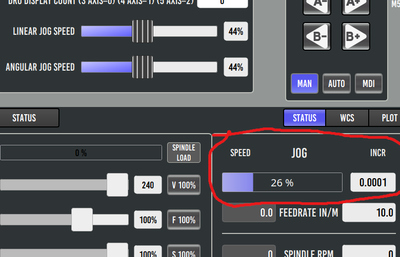

02 Feb 2023 13:31 #263543
by spumco
Replied by spumco on topic Probe Basic - jog slider & status
Success!
In QtDesigner I found HalLabel and HalBarIndicator widgets. Pretty easy to set up, and they both create HAL pins. Important part is that they are float-in pins. Took longer to fiddle with the layout and style stuff to get them looking decent than it was to connect in HAL.
I've not experimented with multiple copies so I don't know how the hal pin naming works when you add more than one of each type.
Restarted PB and opened HALshow... and the new pins showed up as I'd hoped. Basically the same process as adding an LED indicator on the screen.
Connected up in my postgui hal file:
And everything worked. Twiddling the MPG wheel results in the bar indicator displaying the jog-speed. The value is also sent to halui - which seems to have a higher priority than the qtpyvcp jog-speed value. The GUI slider only controls the GUI jog buttons.
Also had a go at displaying the MPG-controlled jog increments. I can read them from my MPG selector, but it's nice to have an on-screen confirmation.
Next step is getting rid of the on-screen jog buttons and replacing them with indicators or other status labels. Ultimate intention is to remove anything from the main screen that can cause machine movement (other than the probing tab).
Thanks for the encouragement.

05 Feb 2023 10:21 #263755
by Lcvette
Replied by Lcvette on topic Probe Basic - jog slider & status
Great work! I sure it will help many folks out with similar setup!
Just glanced at your screen grab, noticed it isn't synching with the on screen sliders? I thought this was what you were after? I'm confused. It appears from your last statement that your just wanting full external control? And just wanting readouts to show physical states?

06 Feb 2023 08:18 #263834
by spumco
You're correct - I had the GUI sliders set different than the external-pin slider specifically to show the fact that LCNC can deal with jog-speed values from two unconnected sources.
I don't know if there's any way to link the external value to the GUI slider value. Perhaps that can be done with widget rules, but I haven't played with that yet. Would be nice to do this because the external jog-speed pin isn't linked to angular-jog-speed and my 4th axis is really slow during external-button jogging.
If you've got an idea how to connect the value going in to the HalBarIndicator to the existing jog-speed sliders, I'm all ears.
And yes, my ultimate desire is to have 'full external control' - more or less. I realize this seems silly as PB is based around touchscreens - what's the point of undoing all the hard work you all put in to having a comprehensive touch-friendly GUI? As I've written elsewhere, I don't like touchscreens for critical/safety controls as there's no tactile feedback. I don't trust them (or mice or keyboards) not to trigger something unexpectedly - especially non-resistive screens.
