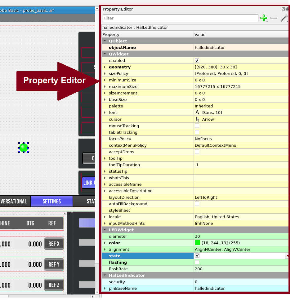

10 Mar 2023 17:32 #266352
by Lcvette
Replied by Lcvette on topic Qtpyvcp - Widget Rules guidance?
so it appears there is a "flashing" option in the properties editor, so you could just set it to flash in the off state maybe and be green in the on state and define those in the style sheet.

10 Mar 2023 18:05 #266357
by spumco
Replied by spumco on topic Qtpyvcp - Widget Rules guidance?
I was able to choose flash, on, or off in the style sheet, as well as set the blink rate and the startup state.
While I can set the color, I can't figure out how to set an "off" color (or flash/not). If I can set the 'off' color, I could set that to green, make it a flashing LED, and reverse the input state logic.
Any idea how to set the off color?

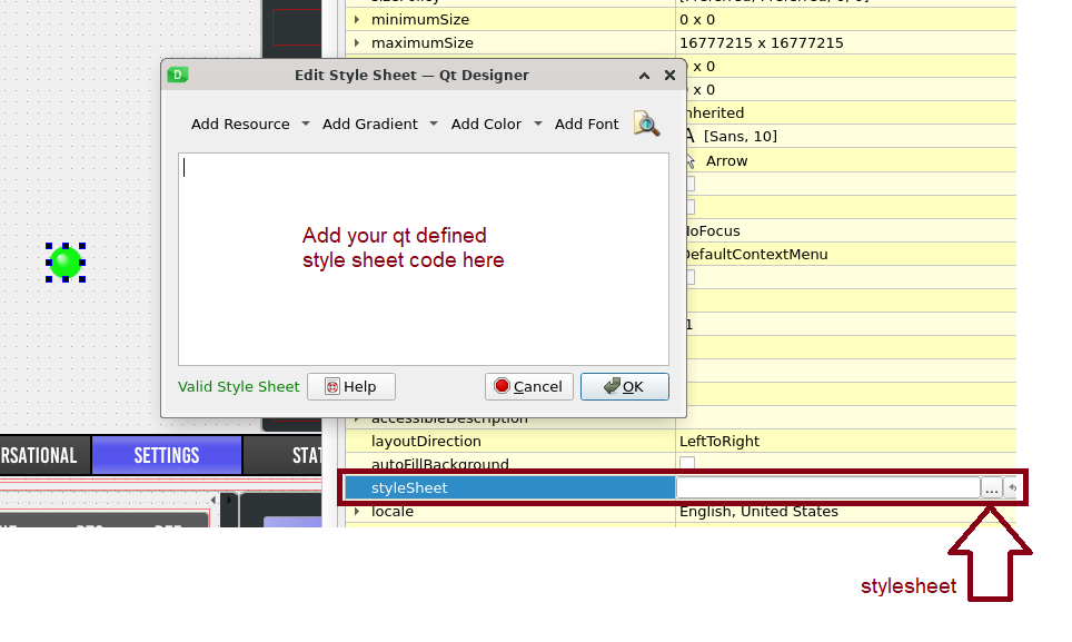

- Lcvette
- Posts: 1682
- Thank you received: 784
10 Mar 2023 18:15 #266358
by Lcvette
The flash and rate and color was a property defined in the py file to a user settable property. The stylesheet is the yellow portion where you add customized lines of code per the qt stylesheet guidelines.

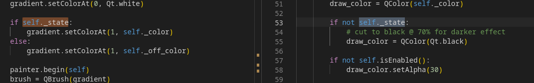

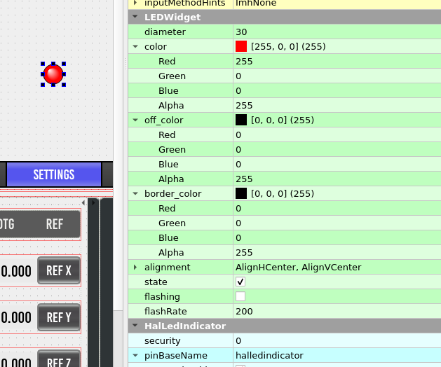

11 Mar 2023 00:16 #266374
by spumco
I was about to throw tantrum because I know noting about editing .py files, but I decided to brute-force it.
I think I managed to get it without breaking anything serious.
If you d/l the file and substitute it for the original led_widget.py it should work. Note that this is in the base widgets folder and not the hal_widgets.
The file is a bit of a mess, but that should help see what I was fooling with.
Off Color and Border Color now show up in the Properties Editor window.
In my particular case, I can set
On = red
Off = green
Border = black
and then connect my input-not to the qtpyvcp.led-something.flash pin. If my air pressure sensor is low (no air), it flashes red/green, and once the air is good the led changes to steady-green.
Someone more clever might be able to figure out how to do a 3-color arrangement: color1 + color2 (flash), and color 3 (on or off). That way it could flash red/black, then change to green. Right now it looks a little silly alternating between red & green.
If you test & like it, please feel free to clean up the file (de-idiot, in other words) and incorporate in the mainline as you see fit.
