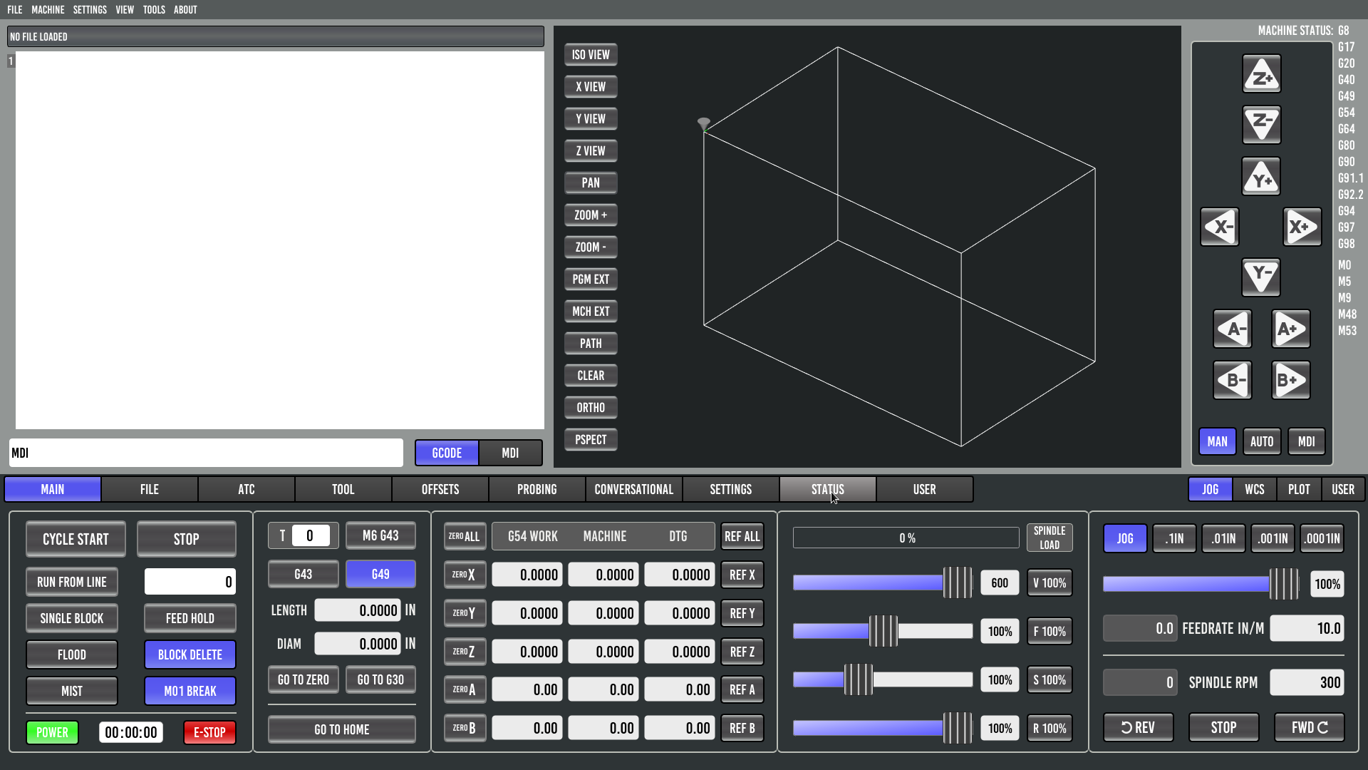

I have installed Probe Basic on two separate computers over the past days and ran into the same error on both of them regarding the default work offset.
My INI file contains the following section copied from the "Probe Basic Config Conversion Doc Lcnc 2.9+" thread.  My full configuration is attached to this post.
[RS274NGC]
RS274NGC_STARTUP_CODE = F10 S300 G21 G17 G40 G49 G54 G64 P0.001 G80 G90 G91.1 G92.1 G94 G97 G98
FEATURES = 30
PROGRAM_PREFIX = ~/linuxcnc/nc_files
PARAMETER_FILE = linuxcnc.var
SUBROUTINE_PATH = /home/cnc/linuxcnc/configs/MH50V-PB/subroutines/

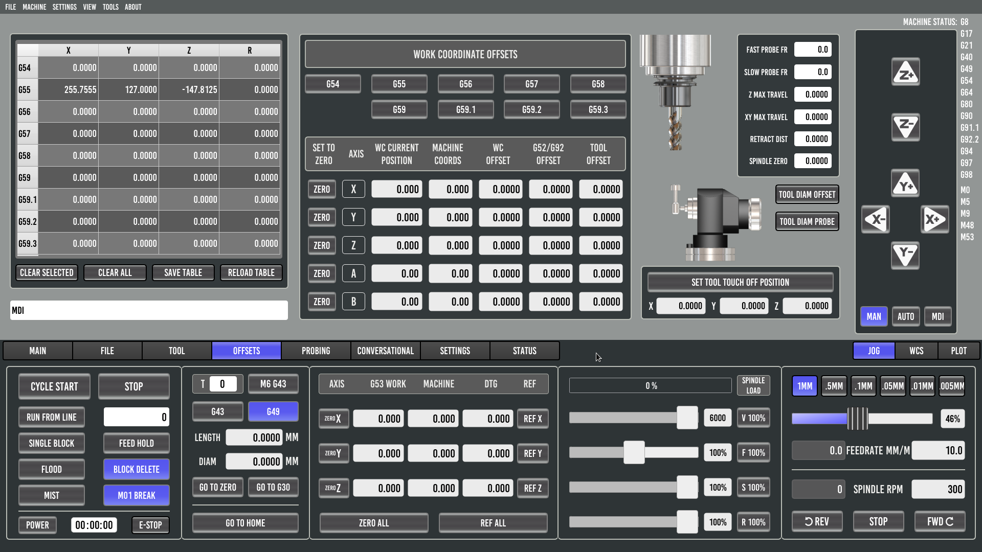

It's supposed to set G54 as the default work offset but it seems to only partially work. Here is screenshot of Probe Basic just after I've started it. On the right side of the screen G54 is clearly listed under "Machine status" however the G54 button under "Work coordinate offsets" is not toggled.

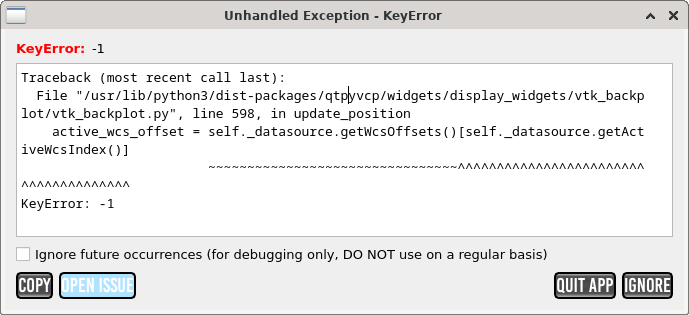

If I try to jog or home the machine this error pops up.

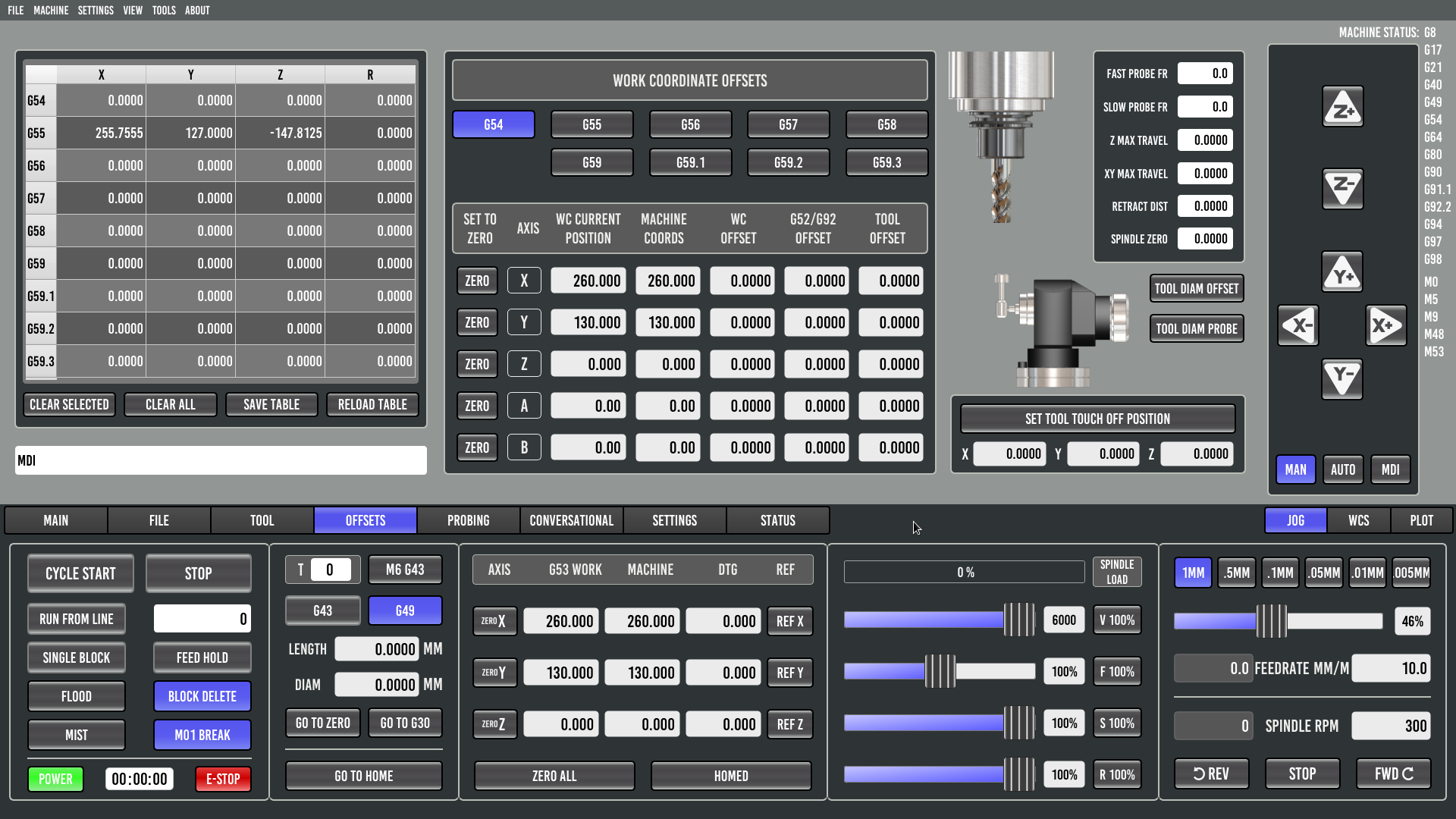

Even if I click on the G54 button after homing I get the same error during any movement.
If I click on any other work offset the error goes away and if I switch back to G54 afterwards that offset works fine too. Changing the default offset to G55 for example leads to the same behavior but with that offset not being properly applied or highlighted during startup instead.
So it seems that the default work offset specified in the configuration file is not properly applied during startup.

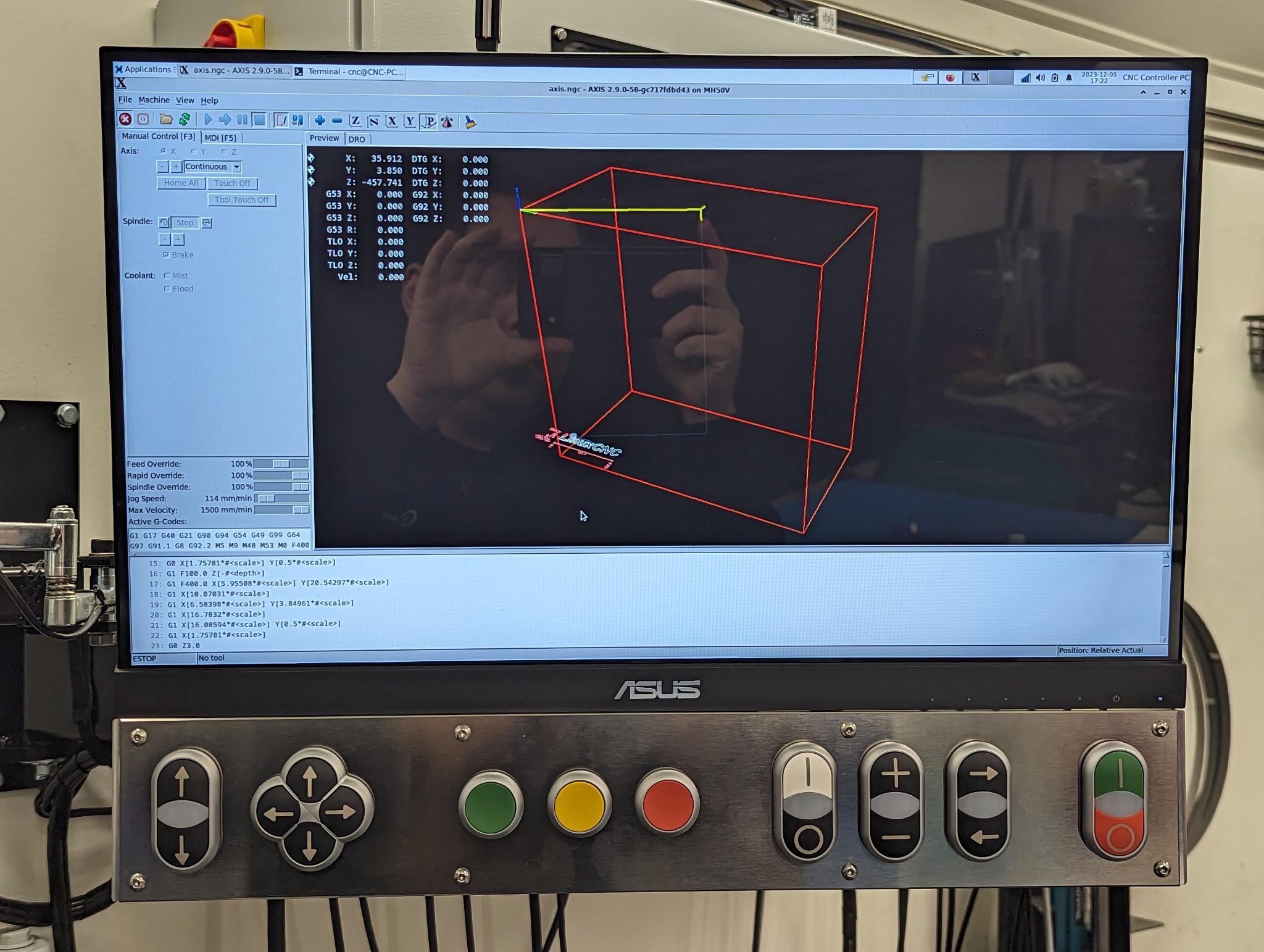

I realize that there are many variables in motion here so maybe there is something in my configuration that interferes with Probe Basic. I followed the recommendation in the guide and got everything fully working in Axis before converting the configuration to Probe Basic.

I don't have a pendant but I do have these hardware buttons wired directly to the Mesa cards and I'm using a latching e-stop setup with an external e-stop relay.
I got all that working using Axis and didn't realize it could cause problems with other user interfaces (I'm still a rookie when it comes to LinuxCNC).
First I'll try the simulator and if that works I'll start commenting out my added HAL code to see if I can put my finger on what's causing the issue.

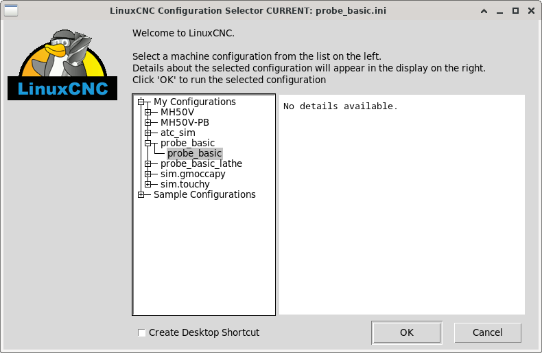

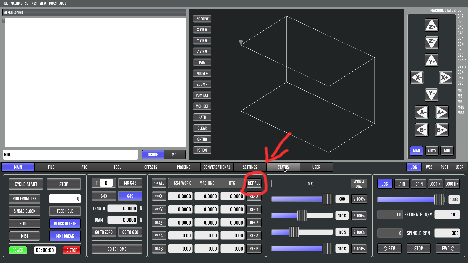

When I launch the Probe Basic simulator this way:
There is no "REF ALL" button visible. Trying to press the home button results in the following message being displayed in the lower left corner of the screen: "CAN'T ISSUE MDI UNLESS MACHINE IS ON, HOMED AND IDLE"
Am I launching the simulator the wrong way or is there something missing in the default configuration? (I haven't modified it)

10 Dec 2023 08:09 #287756 by tommylight
The following user(s) said Thank You: Unlogic
