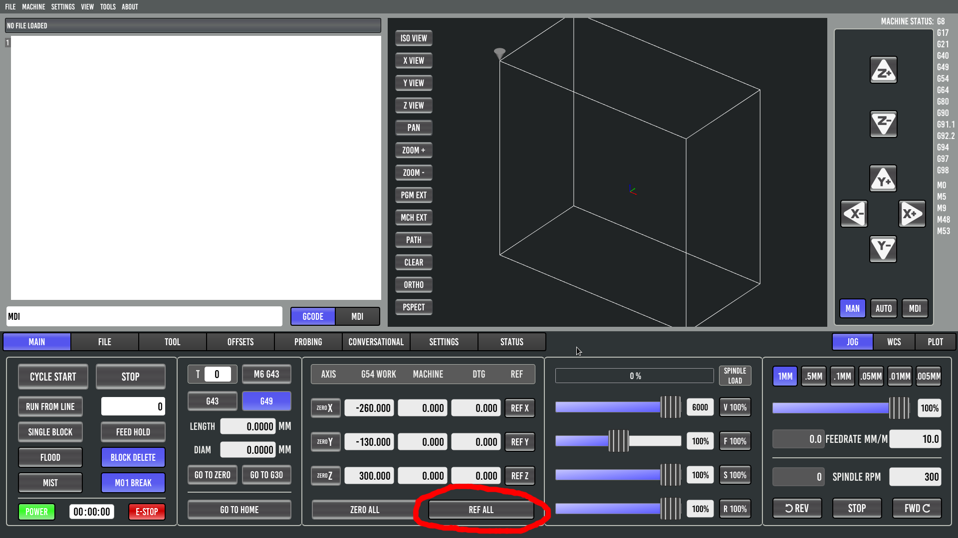

Thanks for a quick reply tommylight, now I feel silly
I was looking for the button in the location where it appears in my real configuration generated following the Probe Basic setup guide.
Pressing the button you pointed out makes the simulator work as intended
