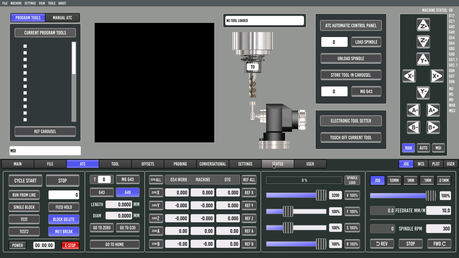

Hi, after a couple of months I'm back on my Brother TC201 retrofit, Will post pictures soon. As a newbie with probe basic (and LCNC) I did my best to configure it but without luck, I guess I'm missing a big chunk of knowledge somewhere but cant figure out. here is my config, actually the ATC tab look like in the screenshot. Please point me somewhere

Fixed setting up a new install on a desktop pc, the same configuration shows the ATC tab as it should.. now I need to figure out how to configure the ATC according to my setup :
1) I have a servo motor with 17 bit abs encoder with an unknown gear reduction due to this retrofitted ATC. Setup with an INPUT SCALE: 157.48 it takes from 0 to 255 units to make a full turn
2) How to implement it in Probe basic is there a documentation?
thanks for your time
