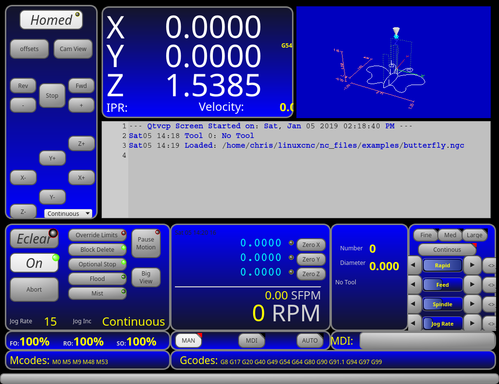

Sample Qtvcp Screens was created by cmorley

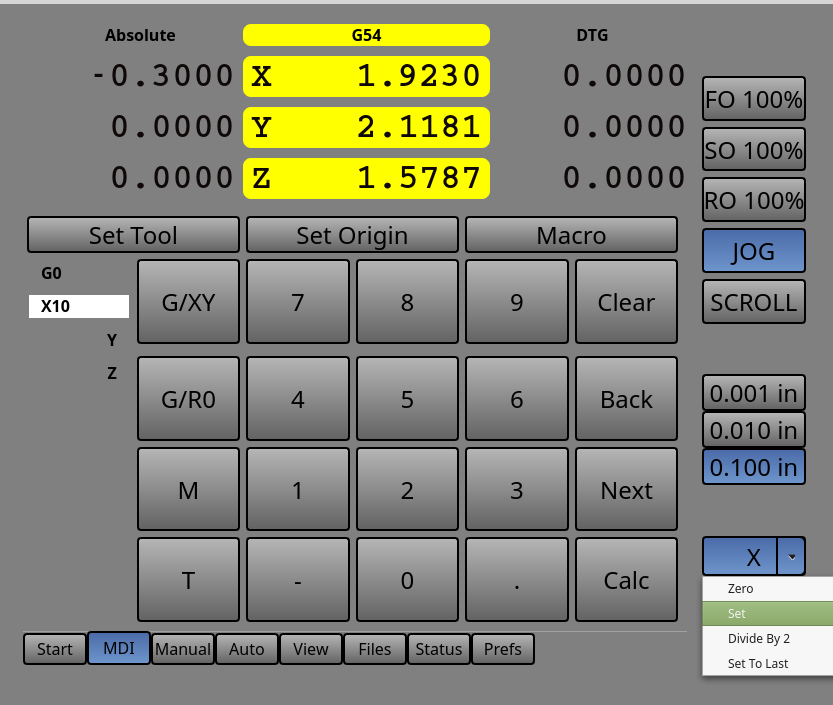

is there a Guide on How to setup from a Running Axis 2.9 Machine Config to the QtVCP Screen
This wouldst be Helpful to so many old Users

- Posts: 7368
- Thank you received: 2181
22 Jan 2020 04:18 #155417
Replied by cmorley on topic Sample Qtvcp Screens
I'll see what I can do. I will mention that since these are very new there is surely growing pains. Be careful to test things.

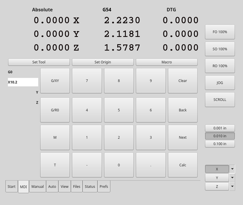

What are some of the system requirements for using these new Qt screens? Are there a lot of dependencies to install? What are the minimum screen resolution/sizes?
I'm often frustrated by the fact that most of the new GUIs developed won't even fit on a 1024x768 screen and heaven forbid if your stuck with 640x480.

22 Jan 2020 12:29 #155442

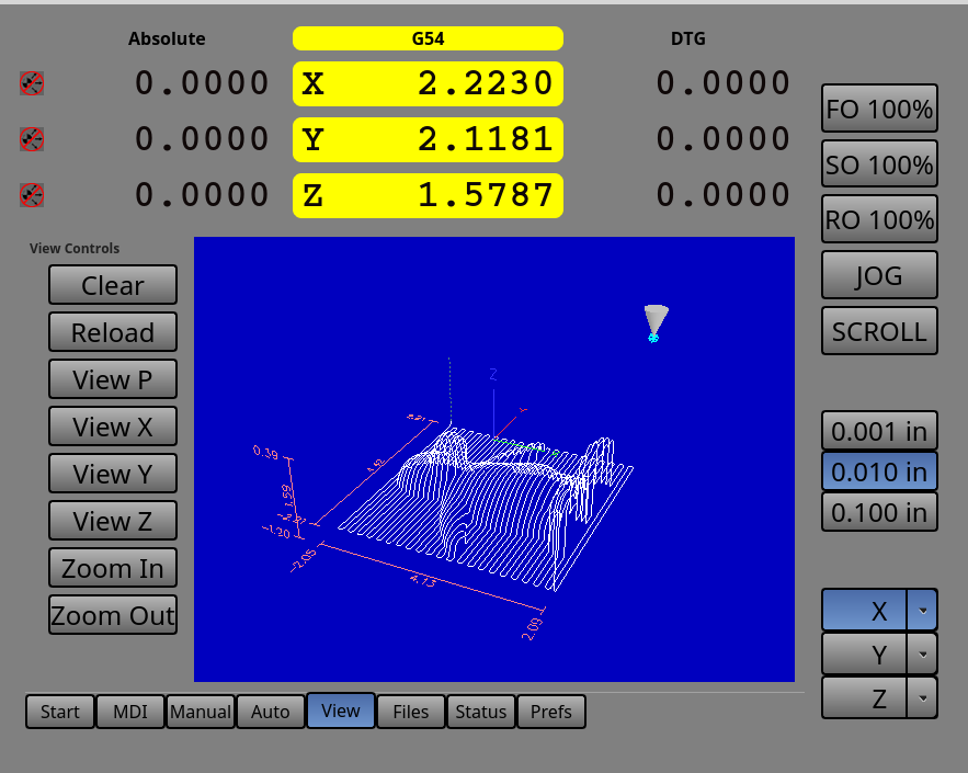

here are the libraries neede for displaying the screens:
To build build/modify screens requires a couple more libraries and copying a file, details here:
github.com/LinuxCNC/linuxcnc/blob/master.../designer/README.txt
Minimum screen resolution varies:
QtDragon 1440x860 - not resizable
QtAxis 508x 600 resizeable
Default 1027x790 non resixeable
QtX1mill 1024x768 non resizable
Qttouchy 833x705 resizeable
need for displayimg pyqt widgets:
python-pyqt5
python-pyqt5.qsci
python.pyqt5.qtopengl
python-pyqt5.qtsvg
python-opengl
python-opencv
optional:
espeak
espeak-ng-espeak
python-dbus.mainloop.pyqt

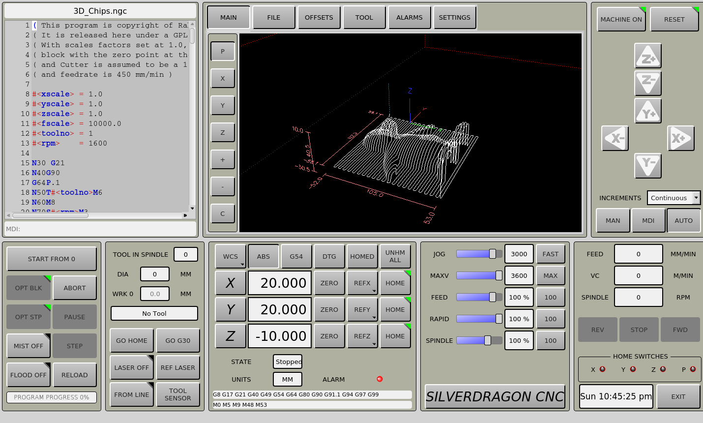

I have a new and improved version of QtDragon. It's not just a sample screen, but a fully functional GUI for 3 or 4 axes, VFD control, and probing. If you are interested in updating the current one, I will put together a package.
Jim
