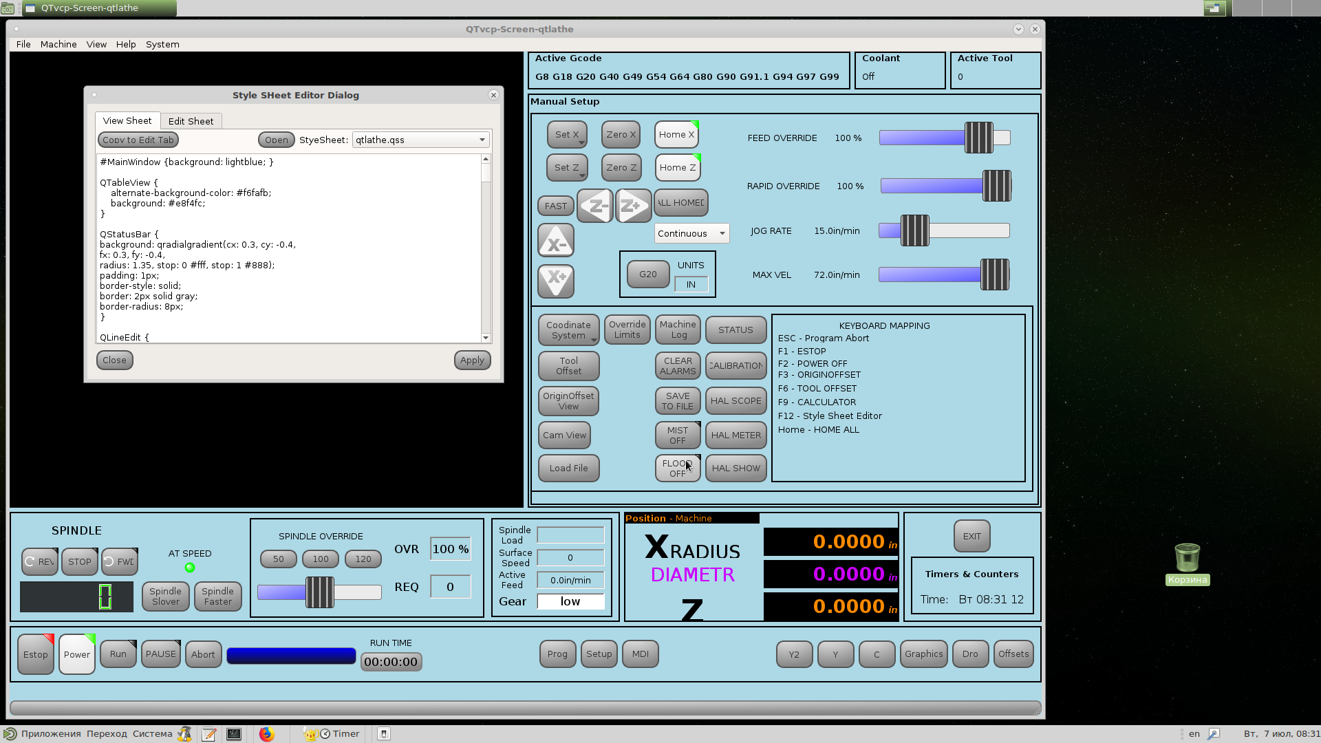

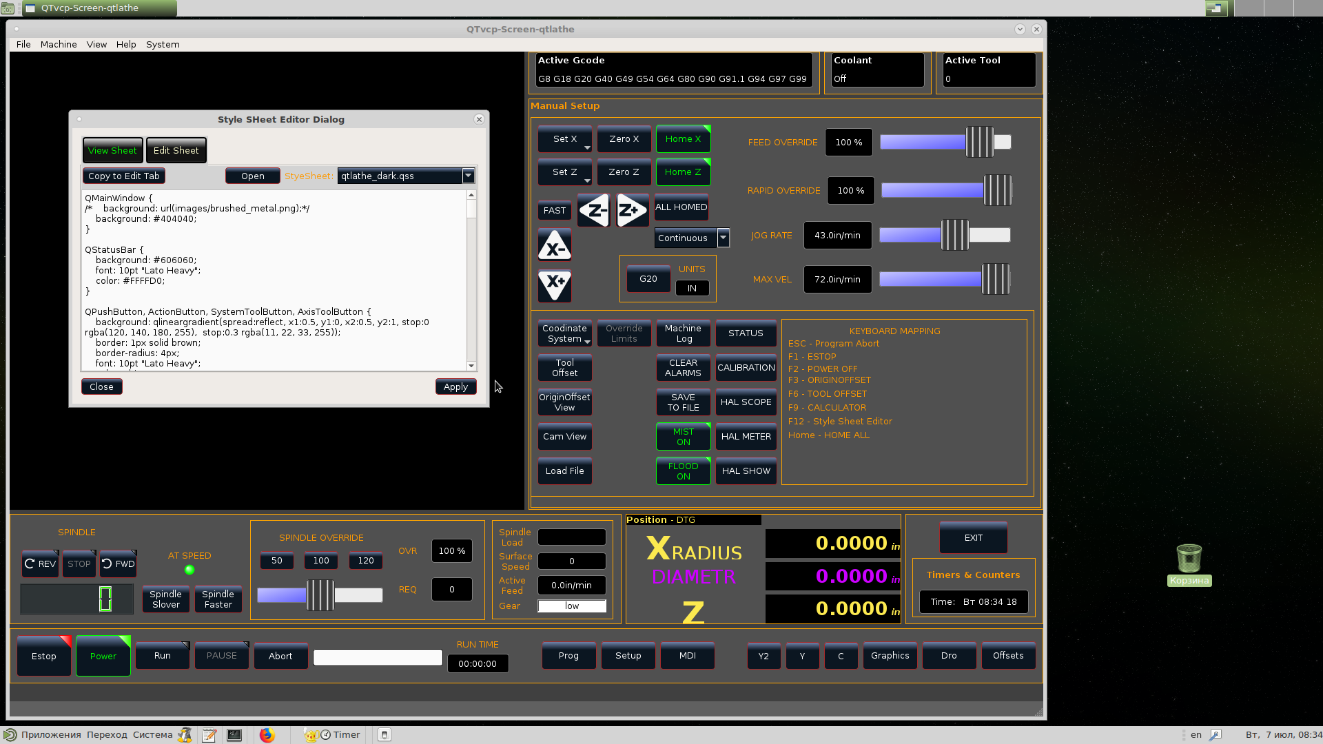

Replied by hottabich on topic Sample Qtvcp Screens
Especially for you 1920x1180. Take the folder with pictures from the previous distribution.
You are welcomed, and i am sorry for that, forgot i use 1920X1200 on all 5 monitors so i had plenty of space left.I leave room for system panels. Thank you for the attention!

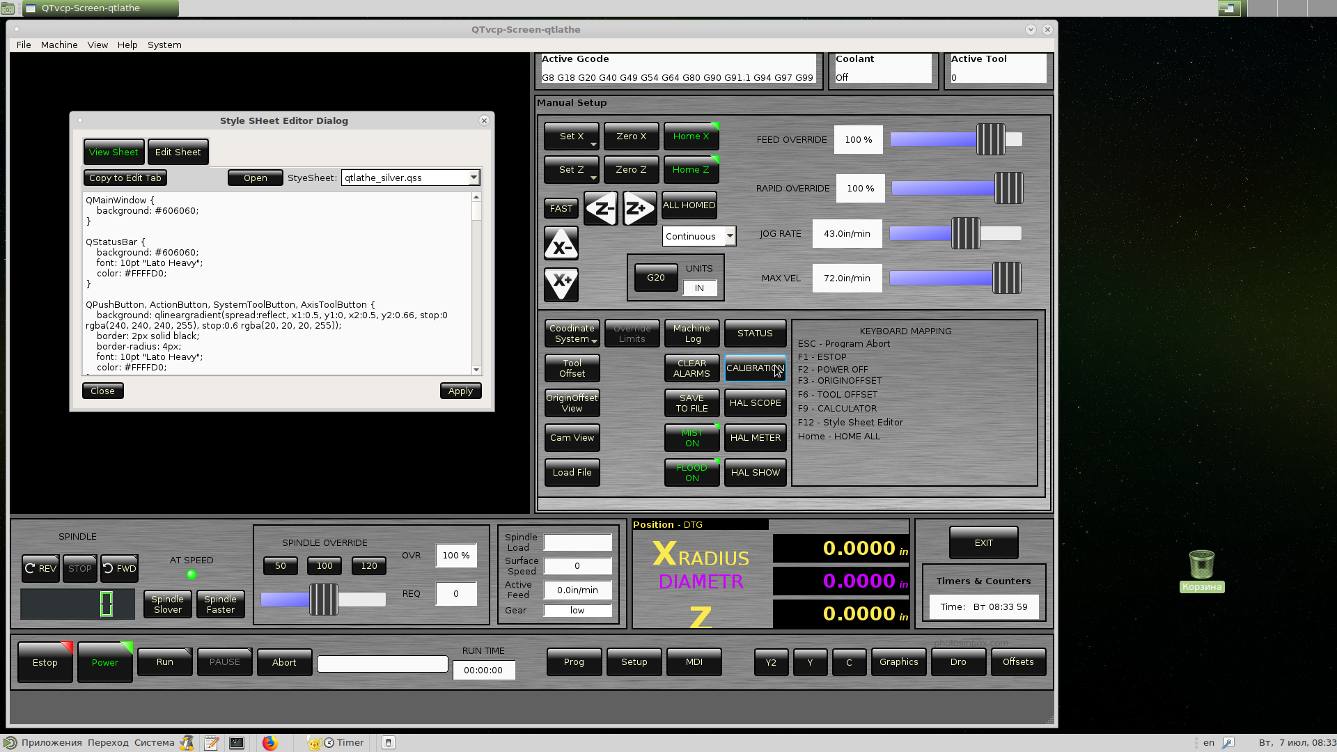

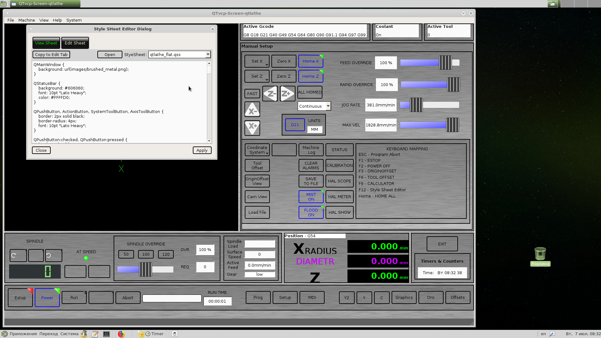

A little less than 1150 is not necessary? And it doesn’t seem to fit. I removed the jog-rate dimension and you can adjust vertically 1150-1180.

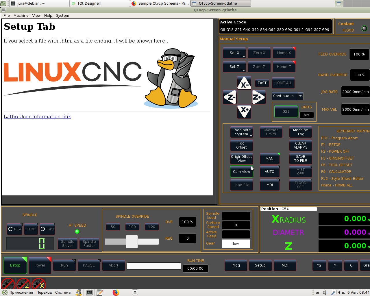

Hello! Most for beginners. Is it glcanon.py as in axis? Can the chuck and jaw dimensions be edited? You can also add a page for the html file, help. Thank!
Last edit: 06 Aug 2020 05:46 by hottabich.
- Posts: 7368
- Thank you received: 2181
06 Aug 2020 05:55 #177468
Replied by cmorley on topic Sample Qtvcp Screens
glcannon calls a function called user_plot()
by default it's a no operation.
i finally got around to adding some python code into qt5_graphics to see how difficult it was to create a stock/chuck representation.
Still working on details.
The chuck dimensions can be modified slightly or one can create a custom function to display most what ever you like.
i can look at the help page and MAN,MDI AUTO buttons..

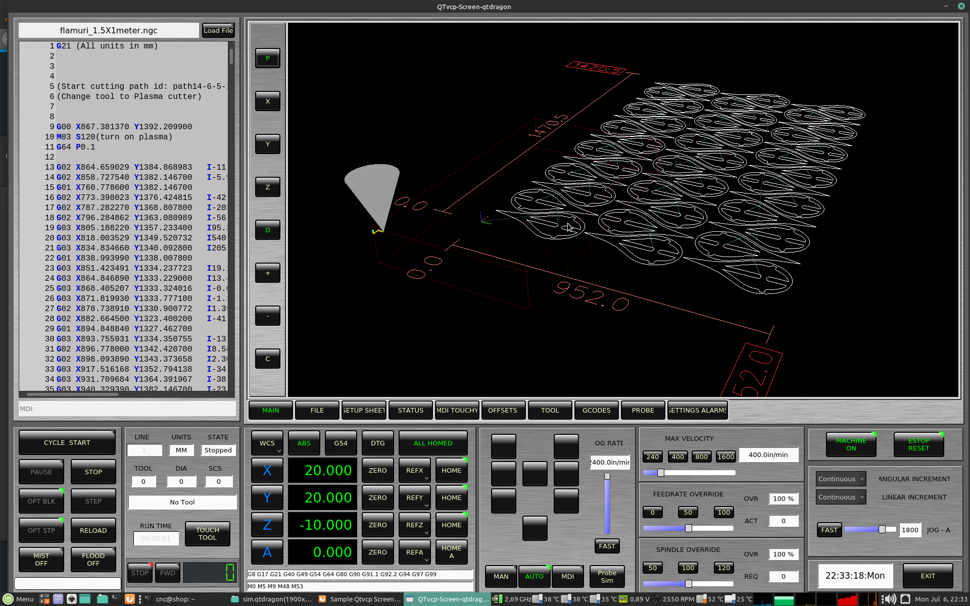

I did ask about this some years back, but due to time constraints i never did anything regarding this.
The idea was when opening an ngc file to open a jpg or png file with the same name as background, here:
forum.linuxcnc.org/10-advanced-configura...posing-a-pic?start=0
Replied by tommylight on topic Sample Qtvcp Screens
That is nice !Playing with extra opengl objects in the graphics screen:

Replied by bevins on topic Sample Qtvcp Screens
What is required for running the dragon theme? QT I am assuming but anything else?
How is it enabled? ini? Is there instructions for using this theme?
It looks nice....
It looks nice....
On one of the forums, I took a file that allows you to see the visualization of the cartridge. Please see if there is something interesting for you.Sorry if I don't understand something.glcannon calls a function called user_plot()
