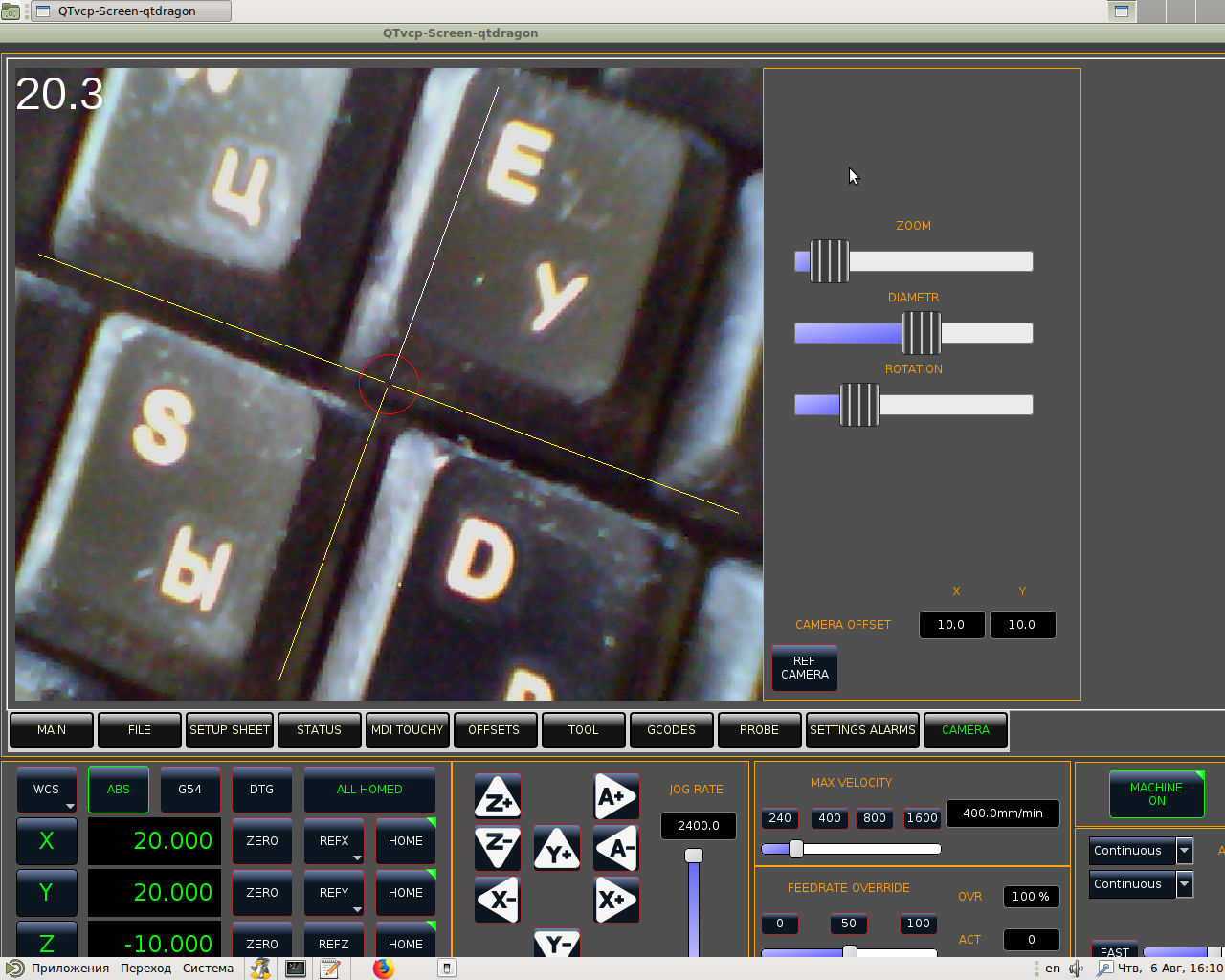

ForTommylight QtDragon + CamView. Probe help in images, images in configs sim.qtdragon.
Thank you so much Jim!

06 Aug 2020 15:51 #177528
Now i found a 20 year old camera so i will try to make that work.
Replied by tommylight on topic Sample Qtvcp Screens
Thank you very much, it works.ForTommylight QtDragon + CamView. Probe help in images, images in configs sim.qtdragon.

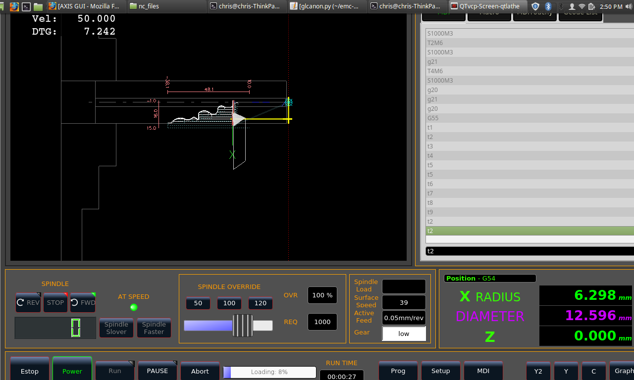

Replied by cmorley on topic Sample Qtvcp Screens
The glcanon you posted has weird indentation so won't run and makes it difficult to find what you changed.

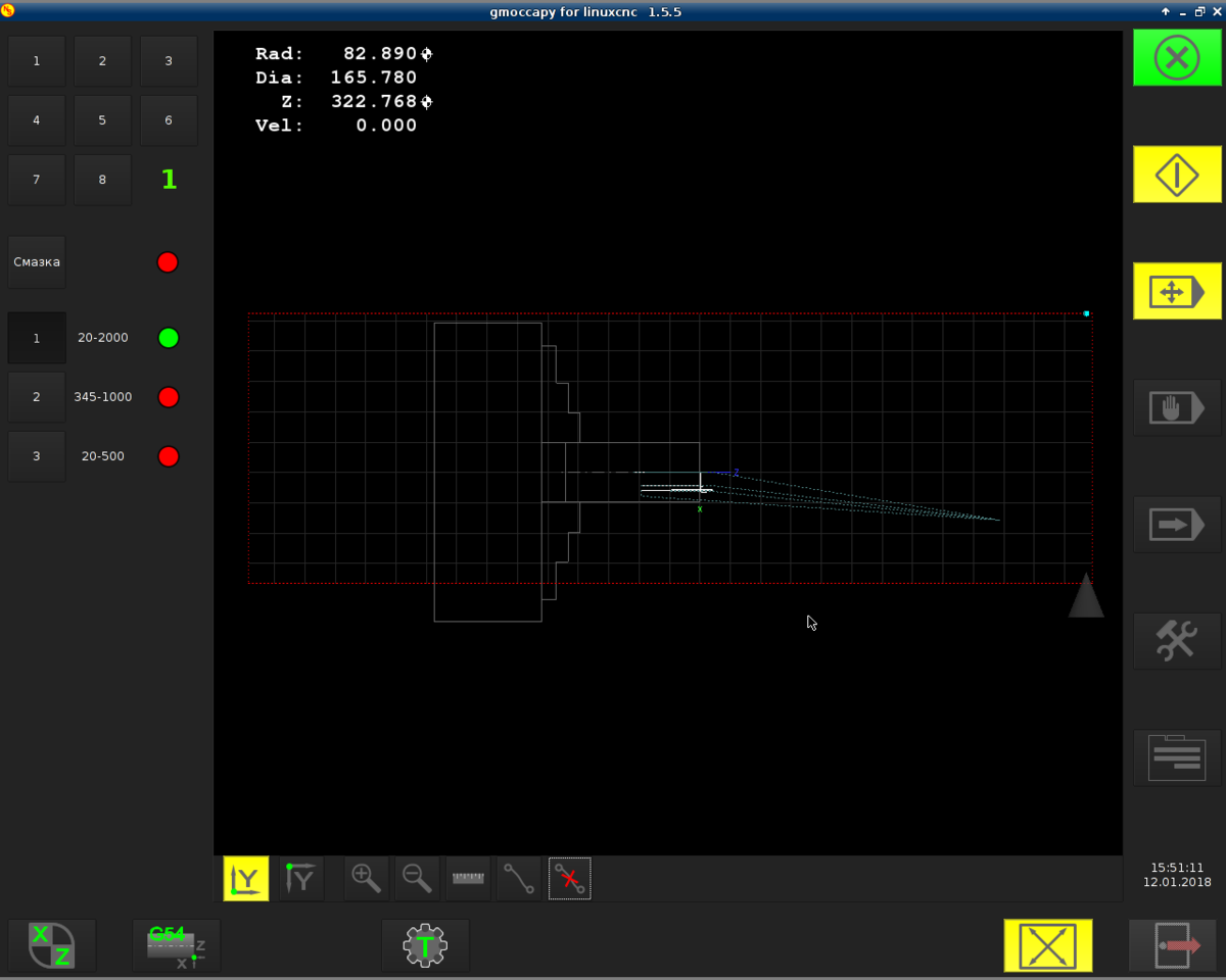

Thanks for your attention. I found the source of the file and the picture.The glcanon you posted has weird indentation so won't run and makes it difficult to find what you changed.
Last edit: 07 Aug 2020 09:44 by hottabich.
- Posts: 7368
- Thank you received: 2181
09 Aug 2020 20:45 #177776
I had a hardrive die so lost the chuck/stock work.
Looking at the sample glcanon you posted - looks like they use magic comments to define the stock size.
There are also HAL pins used for something...
Too bad the comments aren't in English (or that I could read Russian)
yes that's what i did - it's a pain for one word comments all over the place.
I did get it to work mostly:
The HAL pins seem to change the blank size - not sure if that is adjusting after the fact or to show the blank get smaller as it cuts -probably the former.
The blank can also show Id (as in the pic)
