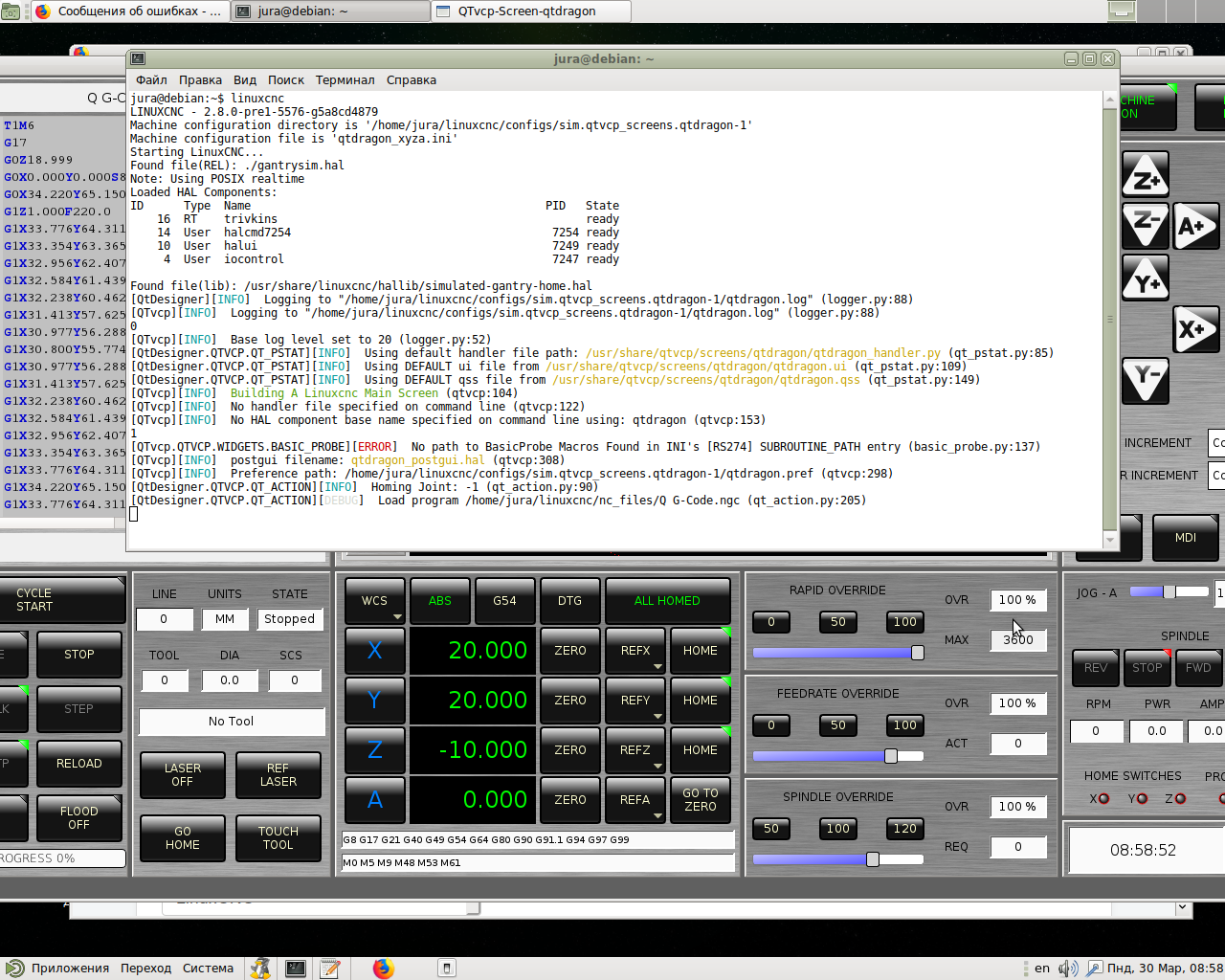

Here is the start and stop. Sorry, but I'm just the operator of my machine and am trying to switch to Linuxcnc with
Mach3.
Mach3.
Last edit: 30 Mar 2020 01:15 by hottabich.

cam you post the contents of this file:
/usr/lib/python2.7/dist-packages/qtvcp/lib/sys_notify.py
Also what language is your system in please?
Chris
Chris

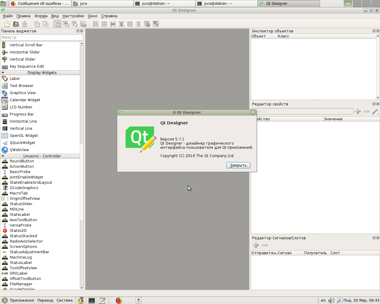

The language of the system is Russian. Screenshots: interface, terminal, qtdesinger.

the basicprobe error as Hottabich mentioned is probably because it couldn't find the probe routine files. you need to change the file path in the INI.
But that won't cause an error in the screen, it will just make probing unavailable.
I'd need to see the actual error and if it's the same as above i need to see the file I asked for.
Chris

Exit gtdragon.Is that what you asked for?
