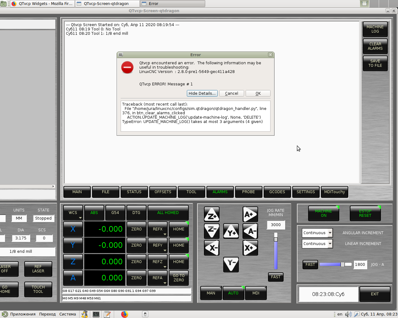

11 Apr 2020 00:30 - 11 Apr 2020 00:31 #163576
by hottabich
Replied by hottabich on topic Error Messages
ALARMS window clicked button CLEAR ALARMS error. I eat close the error window, the interface closes.
Last edit: 11 Apr 2020 00:31 by hottabich.
- Posts: 7368
- Thank you received: 2181
11 Apr 2020 09:43 #163619
Replied by cmorley on topic Error Messages
ok I'll check it out.

12 Apr 2020 09:40 #163763
change the line;
change the line;
def btn_clear_alarms_clicked(self):
ACTION.UPDATE_MACHINE_LOG('', 'DELETE')

- hottabich
- Posts: 574
- Thank you received: 96
13 Apr 2020 01:38 - 13 Apr 2020 02:12 #163847
by hottabich
Thanks! CLEAR ALARMS is working! Special thanks for chk_alpha_mode_checked!
Last edit: 13 Apr 2020 02:12 by hottabich.
