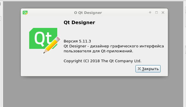

Replied by hottabich on topic No linuxcnc widgets in designer
I am taking libpyqt5_py2.so from PyQt 5.9 and QtDesinger 5.11.3 is it correct? Tried removing libpyqt5.so didn't help.

Replied by cmorley on topic No linuxcnc widgets in designer
libpyqt5_py2.so from PyQt 5.11 should be used with QtDesinger 5.11.3
Did not help. I will think thanks.

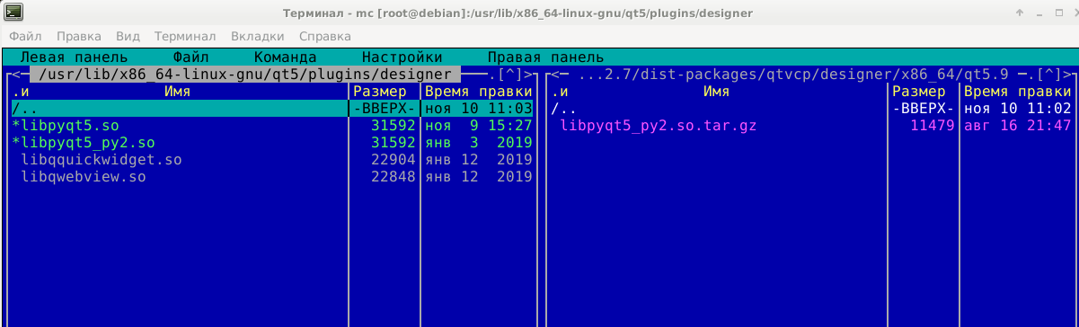

I found the instruction. The python-qt5-dev package has been installed but can't create a link. Please correct the instructions. Thanks!

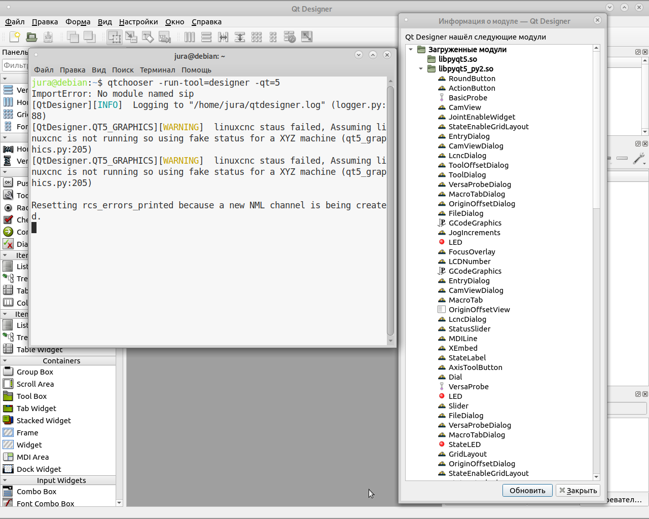

LinuxCNC 2.8.0 Debian 10 Buster PREEMPT-RT ISO. I recommend adding [code] sudo apt-get install mate-desktop-environment-extras [/ code] this will allow you to easily install additional programs in the environmentXFCE desktop. XFCE cannot be removed. Installation of the designer according to the attached instructions. Works
but with an error in the terminal. Who knows, tell me how to fix it.

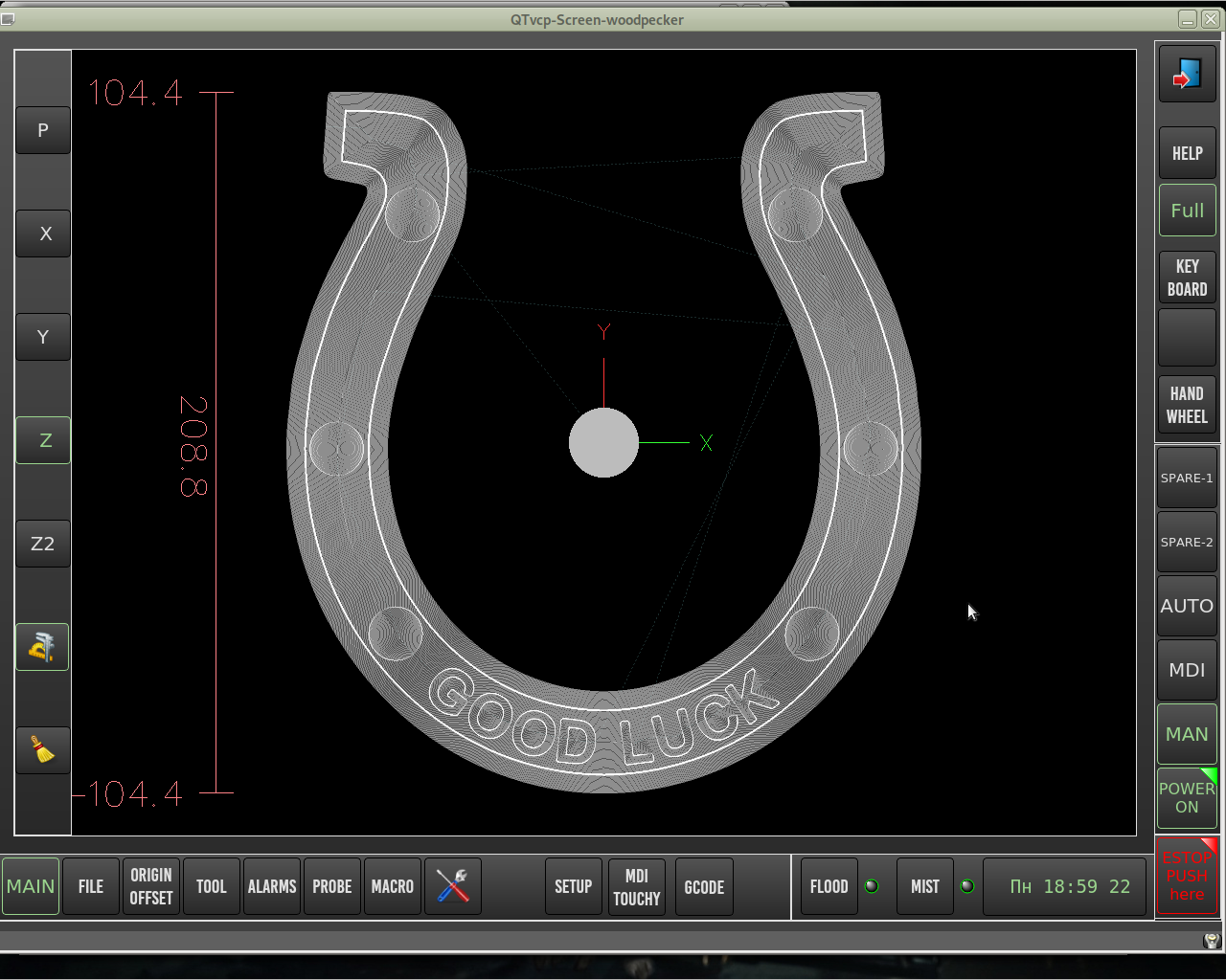

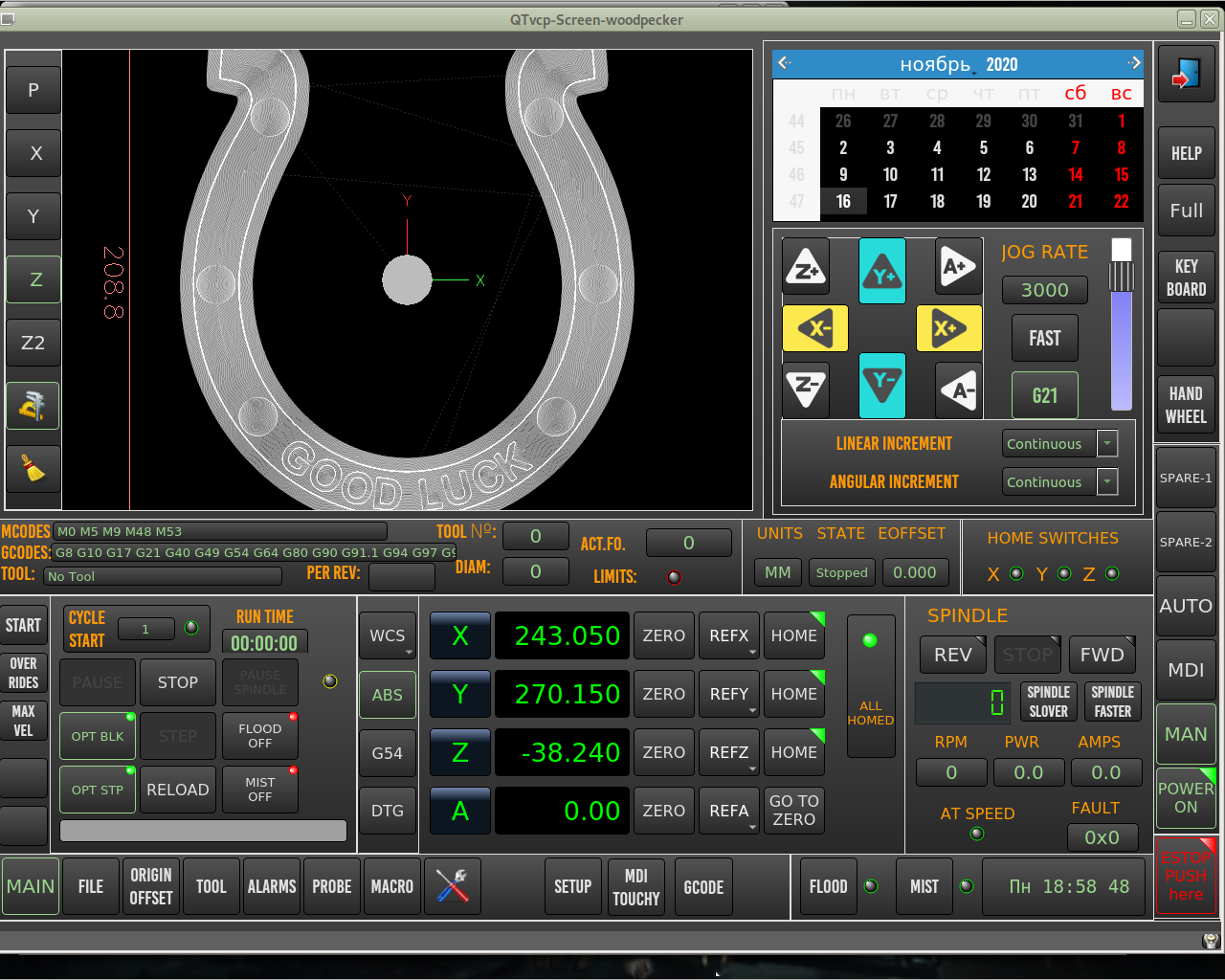

You need a better name for the screen
[/quote] Chris thank you so much for your help and science, I took your remark into account. How do you like that name?

16 Nov 2020 18:39 #189529
Replied by tommylight on topic No linuxcnc widgets in designer
I like it.
- Posts: 7368
- Thank you received: 2181
17 Nov 2020 01:42 #189572
woodpecker screen? interesting.
Looks good.
is it finished now?
Looks good.
is it finished now?
