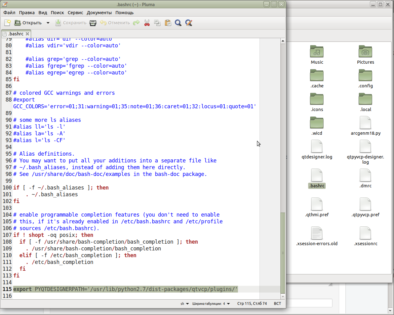

09 Dec 2020 17:36 - 09 Dec 2020 17:39 #191507
by hottabich
Replied by hottabich on topic No linuxcnc widgets in designer
Download my files and put them in addresses via mc root. Bashrc file and at the end of the file write
as in the screenshot and duplicated in the terminal. There are users who work this way.
one python
/usr/lib/x86_64-linux-gnu/qt5/plugins/designer
Last edit: 09 Dec 2020 17:39 by hottabich.

09 Dec 2020 18:01 #191508
by persei8
Replied by persei8 on topic No linuxcnc widgets in designer
Well, it's fixed.
sudo apt-get install libpython-dev
This does not appear in the instructions in section 2.2 Get Designer to include linuxcnc widgets in the qtvcp documentation. Perhaps it could be?
