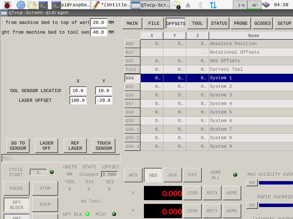

27 Oct 2020 17:13 #187480 by mgmatteo
Replied by mgmatteo on topic qtVCP not working for RPI 2.8 image
@cakeslob I searched the web but I didn't find how to install desktop-notify..
Have a suggestion?
@persei8 I did what you suggested.
- Copied tool.tbl and the qtdragon.qrc found in QtDragon-master
- Modified qtdragon.qrc
<qresource prefix="/home/jim/linuxcnc/configs/qtdragon/">
(pi instead of ijm)
- also created /home/pi/linuxcnc/configs/qtdragon/images and copied the images in it
now if i run it I have a different result (I also see for a second the UI in the xyz example, not the other ones) but still crashes.
I attach the log

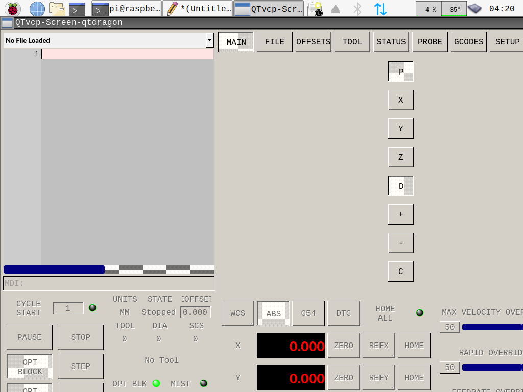

28 Oct 2020 09:28 - 28 Oct 2020 11:31 #187577 by mgmatteo
Sorry, I forgot the file..
Meanwhile I had some success!
Turnkey was to have the notification-daemon running in the background! thank you @cakeslob
In my opinion this should be a Critical output not a Warning as it mislead to think it's something.. well not critical ;-)
So I was able to start qtdragon_xyz even if there are still some warnings in the background.
It would be nice to sort them out just to have a base configuration clean.
I then tried qtdragon_xyzy (that's my machine) and it breaks. Attached the log.
It said something about a missing file (qtdragon_xyz ) so I decided to do this:
- downloaded QtDragon-master, Probe-main and unzipped in /configs/qtdragon
- downloaded vtk-master and unzipped in the same folder (overwriting some of the previous files).
Now if I launch the example configuration qtdragon_xyzy it brakes in a different position
AttributeError: 'VersaProbe' object has no attribute 'input_xy_clearance'
I have to figure it out where this values go, but I think it would be nice to have the vtk master setup in a way that it works with all the examples so that we have a starting point to explore the penalization of those configs.
Sorry for my English... I hope that what I just wrote doesn't need to be debugged :-D

28 Oct 2020 12:00 #187590 by persei8
Replied by persei8 on topic qtVCP not working for RPI 2.8 image
[QTvcp.QTVCP.QT_MAKEPINS][WARNING] Preference instance error: Cannot find directory: /home/pi/linuxcnc/configs/qtdragon for preference file. (qt_makepins.py:55)
This one is because your config dir is called qtderagon, not qtdragon
[QTvcp.QTDRAGON_HANDLER][INFO] No valid probe widget specified (qtdragon_handler.py:270)
This one is likely because the xyzy.ini doesn't have a [PROBE] section. Copy it over from the xyz one. Valid entries are USE_PROBE = versaprobe or USE_PROBE = basicprobe. If you don't want the probe routines, leave it out.
It looks like it's going to work. Chris just pushed some updates to master so some adjustments will need to be made if you update and upgrade. In the meantime, I will try to fine tune everything. Keep in mind, qtdragon with vtk on an rpi4 is NOT a finished product. It needs a proper graphics display widget. If you know OpenGL ES, this could be a project for you.
