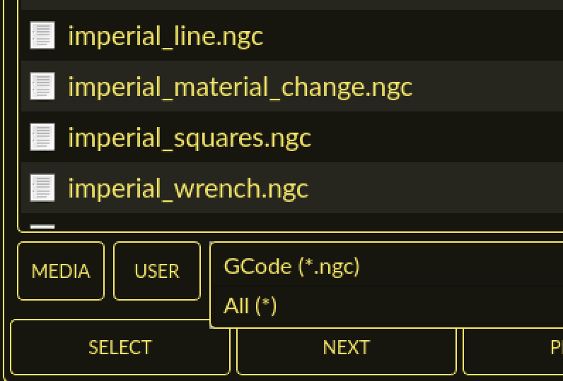

In my ini file I have:
Printing INFO.PROGAM_FILTERS_EXTENSIONS shows:
When using FileManager to open files the extensions are used individually, Is it possible to use them simultaneously, with the exception of "all files"
[FILTER]
PROGRAM_EXTENSION = .nc,.tap remove z axis stuffPrinting INFO.PROGAM_FILTERS_EXTENSIONS shows:
['*.ngc', '*.nc', '*.tap', '*']When using FileManager to open files the extensions are used individually, Is it possible to use them simultaneously, with the exception of "all files"

Replied by cmorley on topic FileManager extensions
This is something i have been just working on.
The file dialog works as you want so it is possible.
it wasn't clear to ma at the time how to apply multiple filters simultaneously.
So short answer no but hopefully in the soonish future.
Chris
Do you have the 'file dialog' option turned on in the screenoption widget?
And yes it does look like the new button doesn't clear the text as it should - i'll fix that.

Last question today. When a file is opened and run through a filter then a temp file is created and opened by LinuxCNC. Is the original filename available somewhere?
- Posts: 7368
- Thank you received: 2181
17 Nov 2020 21:12 #189642
try ACTION.prefilter_path
It should hold the last loaded file name as a string.
ok I pushed an upgrade so extensions work properly in file_manager
Chris
