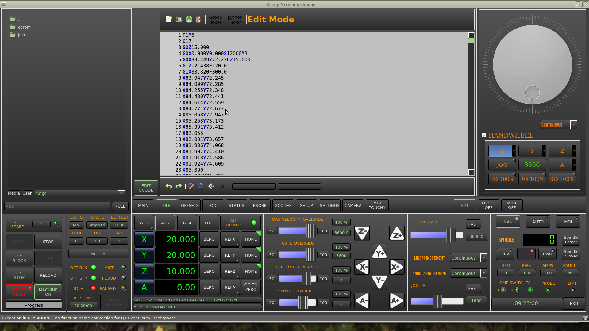

Hello! Editor file does not work. Linuxcnc from 11/18/20. Is it mine or a general question? Prompt

Replied by cmorley on topic FileManager extensions
I see this problem too. probably do to recent changes to processed_key_event__()
when I added WRITER code.
I'll look into it soon.
Chris
Chris
- Posts: 7368
- Thank you received: 2181
20 Nov 2020 23:38 #189952
try in handlerfile
if flag:
if isinstance(receiver2, GCODE):
# if in manual or in readonly mode do our keybindings - otherwise
# send events to gcode widget
if STATUS.is_man_mode() == False or not receiver2.editor.isReadOnly():
if is_pressed:

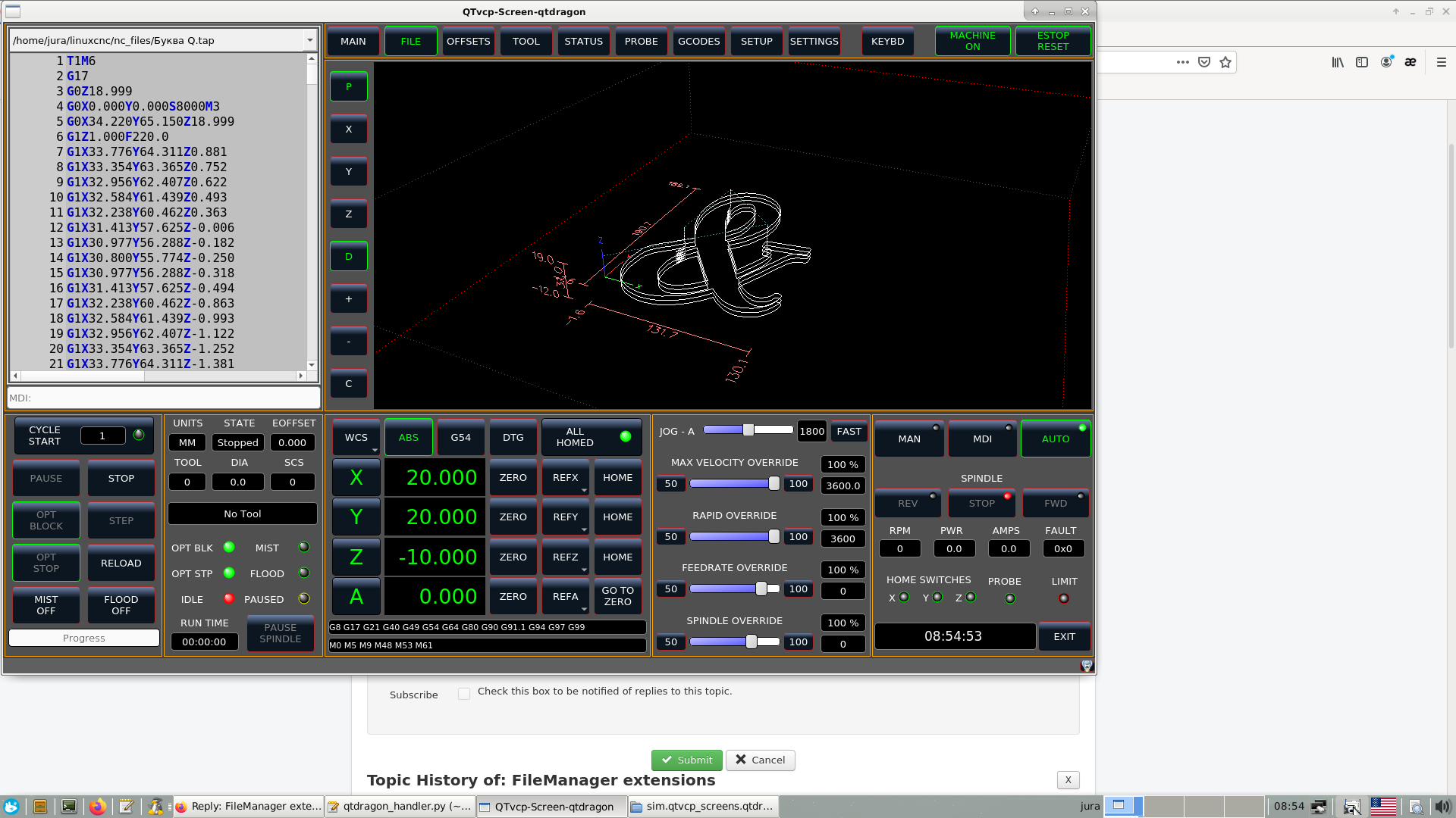

Thanks, it works! Another question before the attached file loaded well, and now the code is loading
and the picture remains the same.

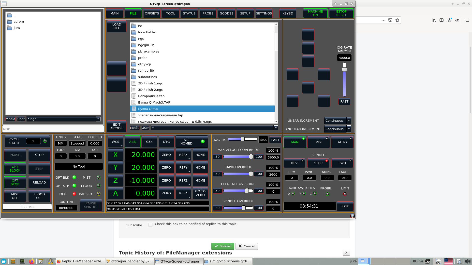

If you write in the handler like thisthen when selected, all files will be loaded ngc, tap. In the interface phillc54 must be removed USB copy file.
# GENERAL FUNCTIONS #
def load_code(self, fname):
if fname is None: return
if fname.endswith(".ngc") or fname.endswith(".py") or fname.endswith(".tap"):
Last edit: 22 Nov 2020 01:04 by hottabich.
The very first line
'Q Linuxcnc.ngc'
is not legal code
Chris
