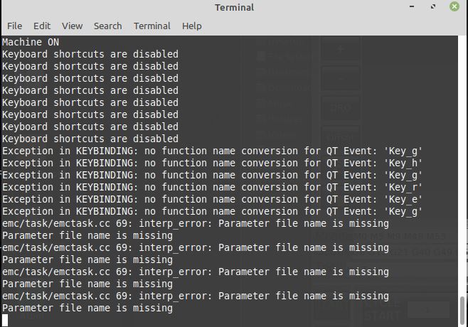

Sure, I will do that after work this evening.
Replied by snowgoer540 on topic Inconsistent Error Messages
Can you try another qyvcp sample screen to see if it's screen code related?

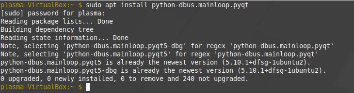

Replied by cmorley on topic Inconsistent Error Messages
parameter file missing should show. So it seems a system problem.
Are you using master?
and you have installed:
python-dbus.mainloop.pyqt
I'm sure you do but ask for completeness

25 Feb 2021 08:54 #200073
by snowgoer540
Yep, I am on master.
Looks good to go. No worries, always better to be safe!

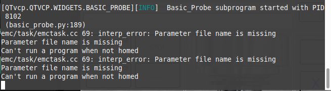

25 Feb 2021 12:08 #200085
by snowgoer540
Was just thinking that maybe I should note that in SIM on my Virtual Machine it's hit or miss as to whether or not I get the standard Latency Error message when I start any of the qtvcp screens. I think that might be independent of any screen I select.

25 Feb 2021 12:39 - 25 Feb 2021 12:40 #200089
by snowgoer540
I would wonder the same, but my actual machine for cutting does the same thing
I just used the SIM as an example since it should always show the latency message.
EDIT: Both are Mint 19.2 though, so that does seem to be a common factor. Made from Beaglebrainz images.
I wonder if it's the virtual machine doing it.
