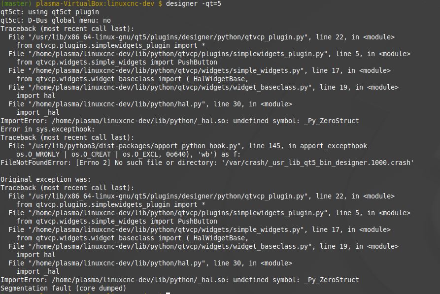

Replied by cmorley on topic Inconsistent Error Messages
I have tried mint 19 and mint 19.3 both work fine.
I use mint almost exclusively actually.
can you look up what version of qt the system has - if you open designer and click about that will tell you.
Chris
Chris

02 Mar 2021 09:28 #200790
by snowgoer540
Replied by snowgoer540 on topic Inconsistent Error Messages
Maybe it's exclusive to 19.2, or the beagle iso I am using.
It's not just one PC though, like I said SIM and my plasma PC both do (or dont do) it.
At any rate, I will get the designer version when I am home from work today.

02 Mar 2021 23:06 #200874
by phillc54
Replied by phillc54 on topic Inconsistent Error Messages
I seem to recall getting segmentation faults when the wrong version of libpyqt5_py2.so was installed.
If you used the install script recently that may be the case because I just noticed that when I added v5.11 I forgot to fix the script and it only installs the v5.11 .so file now. Oops, I need to fix that...
You could try to get the Qt version with:
dpkg-query -W -f='${Version}\n' qttools5-devPlease Log in or Create an account to join the conversation.

03 Mar 2021 05:30 #200891
by snowgoer540
I will give that a go. I haven't ran the install script, but I did install the qt dev tools because qtdragon asked me to when I was trying to see if error popups worked for other qtvcp screens. I'm guessing that's what messed it up.
You could try to get the Qt version with:dpkg-query -W -f='${Version}\n' qttools5-dev

04 Mar 2021 16:20 #201063
by phillc54
My Buster and MX-Linux machines have 5.11, I think my Stretch ones had 5.9 - probably no help to you Mint users though
Did you try running the install script to see if that helps.

04 Mar 2021 16:41 #201067
I think you have the python3 plugin running instead of the python2 (libpyqt5_py2.so).
remove the python3 plugin

04 Mar 2021 17:02 #201069
by phillc54
The install script "should" rename the python3 plugin if it sees python2 as the default.
