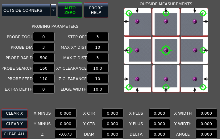

Hi all
I was wondering if someone could give me some assistance with the probe screen.
I am using the latest development version of QtDragon & everything seems to work as expected except I cannot find anywhere to enter the value of the touch plate.
I am using a ground wire connected to the spindle & a piece of pcb material on top of the work piece which is aprox 1.5mm thick.
Like I say everything works as it should except I then have to go in & manually add the extra 1.5mm to the automatically adjusted values in the DROs.
Is there somewhere to enter this value in the probe screen?

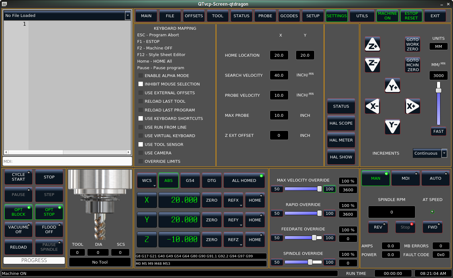

Sorry but I cannot find the screen you are talking about.
I have enabled use tool sensor in the settings screen but it doesn't seem to change anything.
The only reference to a touch plate (that I can find) is in the tool tab. I have had a bit of a play with this but I don't really understand what I am doing here.
Could you please explain a little further.

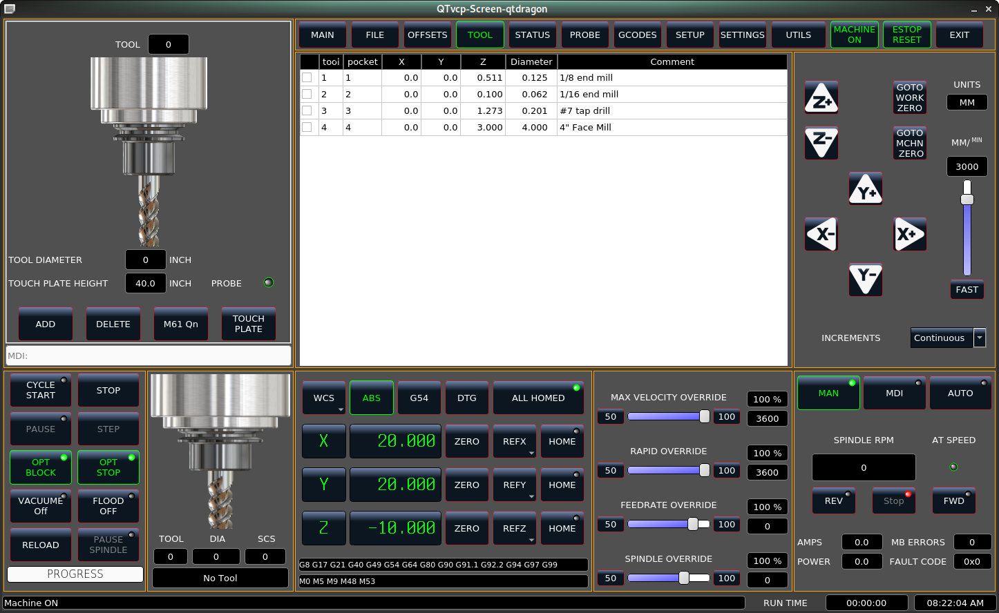

I misunderstood what you meant by "latest development version of QtDragon" On that screen, on the tool page, like you posted, enter the touchplate height in the box that says Touch Plate Height. Clicking on the Touch Plate button will then start the probe routine. If it's not working, check the status bar for a message and make sure it's in Manual Mode. (or maybe MDI, can't remember exactly)

What I'm trying to do is set the g54 z0 to be equal to the top of the work piece. I was using the probe screen to do this using the center button (as per the picture in the first post) The software sets the z offset as expected but then I have to manually subtract 1.5mm (the thickness of the touch plate) from the z.

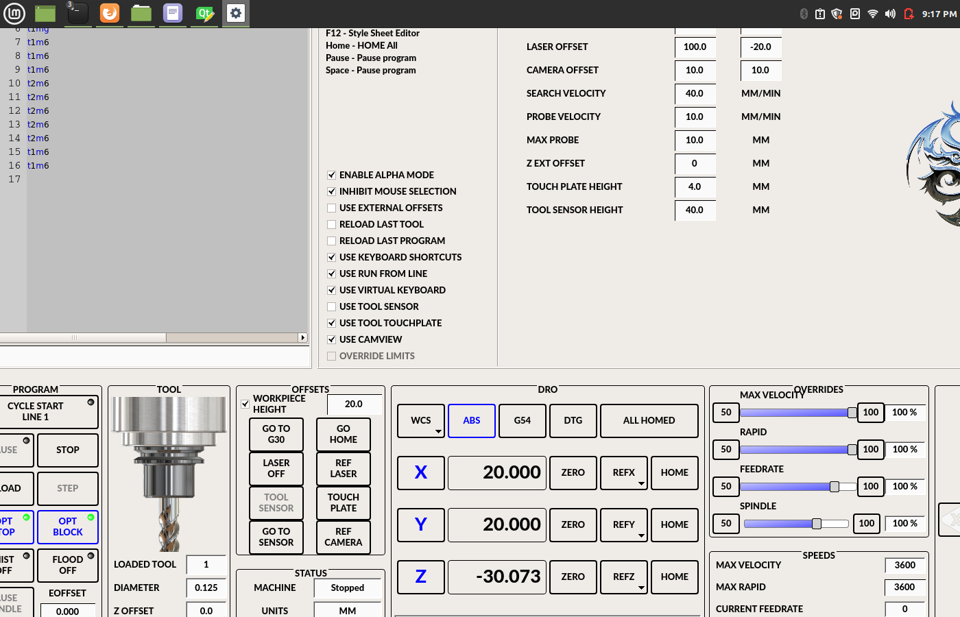

If using the linuxcnc included dragon_hd, it should look like the given pic.
Note:
-The checkbutton - 'use touch toolplate' is checked
-The entry 'tool plate height' is set to 4mm
-The button 'Touch Plate' is enabled and the button 'Tool Sensor' is not (to the right of the tool holder image)
By the way what function were you using in the probe screen to touch off with a plate?
Chris
Note:
Chris

The probe screens do not work for setting Z height via touchplate. They are only for use with a touch probe. The touch plate height setting is the thickness of your touchplate, not the height of the workpiece.
As for units, if your machine is metric, then in the [TRAJ] section of the ini file should be a line like LINEAR_UNITS = metric. Also make sure G21 is active.

PS - if you are using the probe screen to measure Z height, it doesn't know anything about touchplate height. It only uses the probe tip diameter. I suppose you could use that by setting the diameter to your touchplate thickness. Never thought of doing that before.

As for units - I can see it being confusing I see in the source the touch off plate routine is hard coded to use G21 so the height setting must be in metric as well. That makes sense if the machine is metric based but less so if imperial based.
