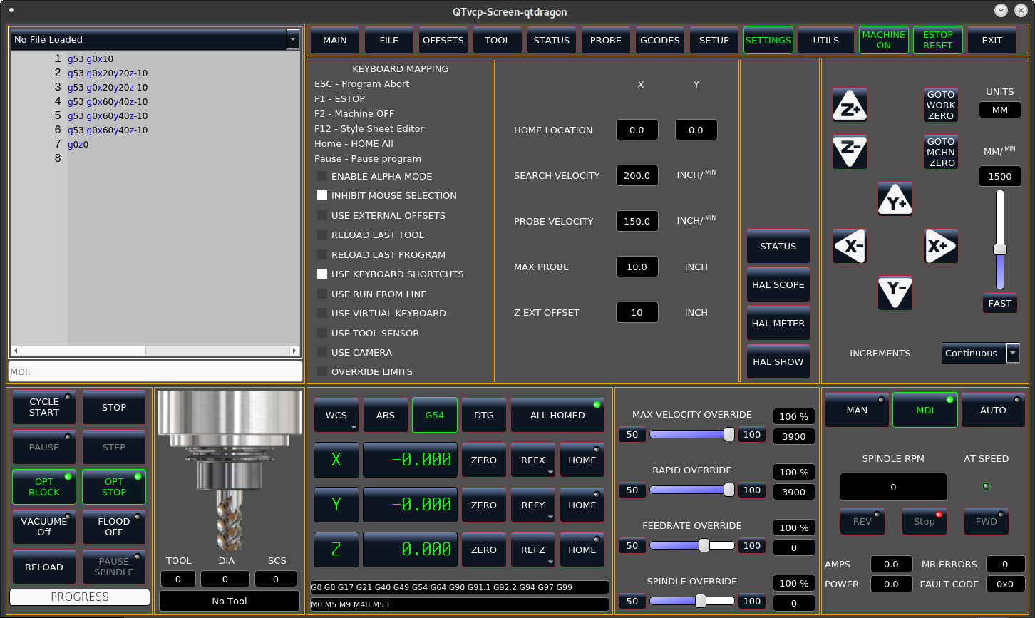

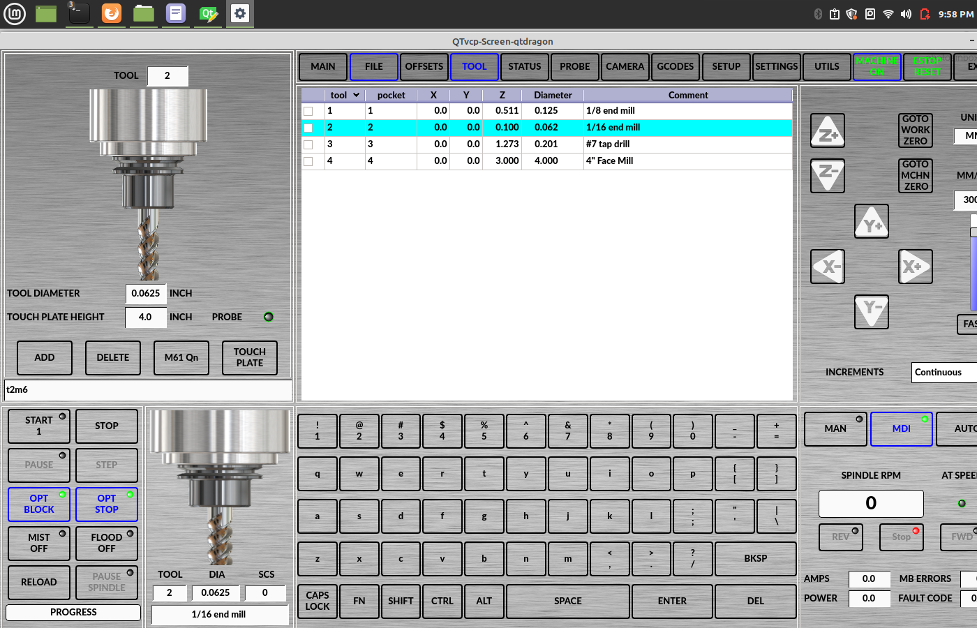

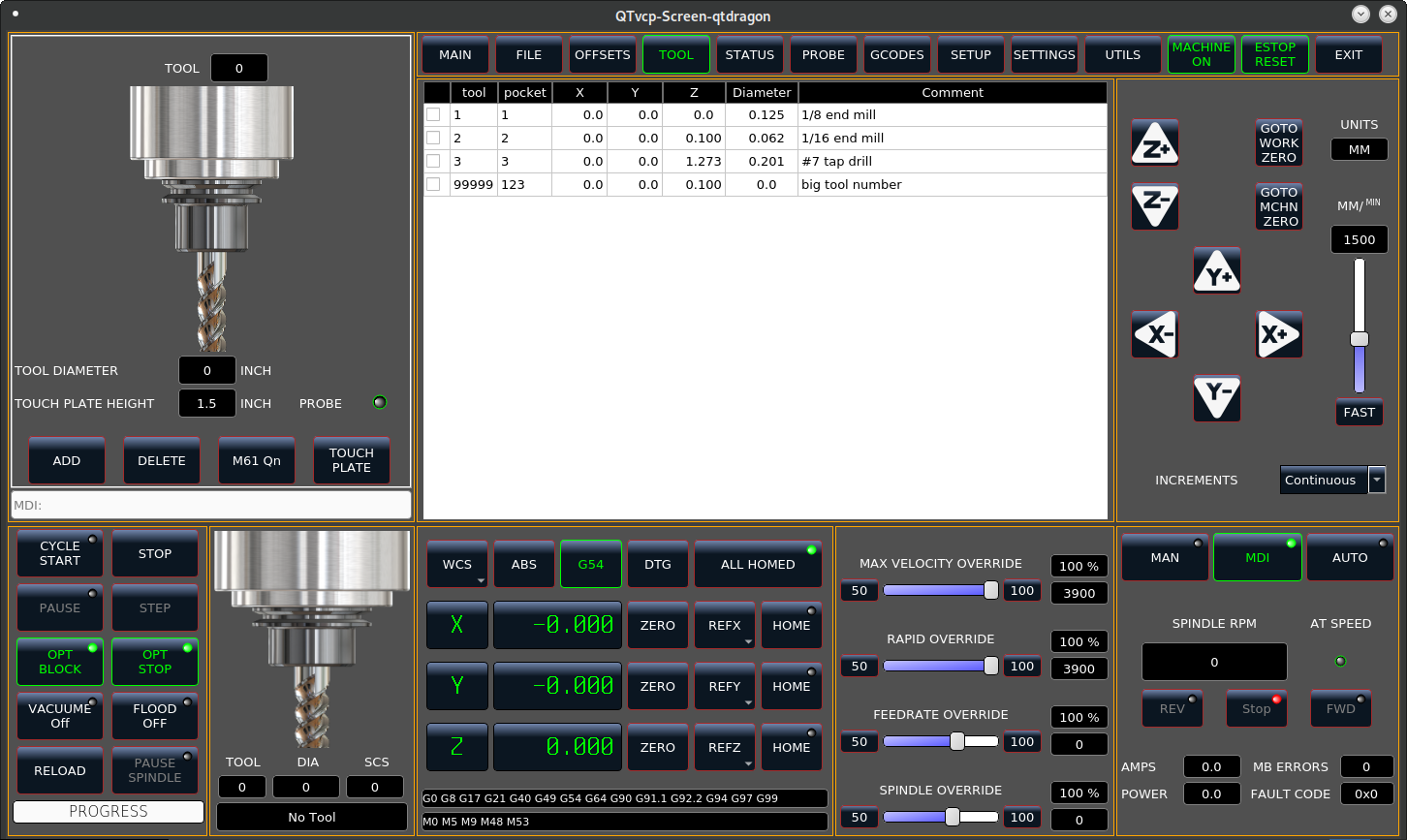

I'm not actually using the HD version, just QtDragon (standard version?!?)
Comparing with your pic it appears that those options are not available in the standard version. Please refer to pic in third post.
There is no tick box for use tool touchplate & there is no option to set touch plate height (that only appears under the tool tab)

I have done another update and everything seems to be working now. For the sake of completeness here is the status quo...
I am using 2.9-pre0-4641-.....
I have set the probe speed in the settings tab (Probe Velocity)
I have set the touch plate thickness in the Tool tab (Touch plate height)
Press the "touch plate" button in the tool tab & the G54 offset is set correctly
Prity much what you said. The screens still say they are using inches but they appear to be in mm.
I was trying to use the probe screen to do this job (as seems logical to an armature like myself) & if something could be added to this screen it could be useful for the skew correction (Edge Angle). Just a thought.
