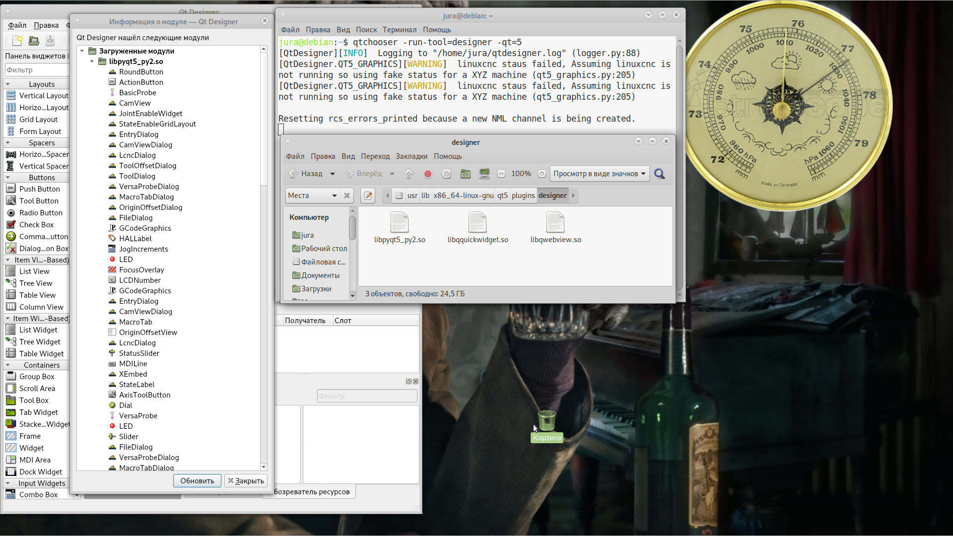

Can you run in the terminal:
designer -qt=5
It might give some clue of the problem.
designer -qt=5
The following user(s) said Thank You: partec
- partec
- Posts: 173
- Thank you received: 27
03 Oct 2021 16:00 #222138
by partec
Replied by partec on topic LCDNumber
when I enter
designer -qt=5
in the terminal, the application opens immediately without any comment
designer -qt=5

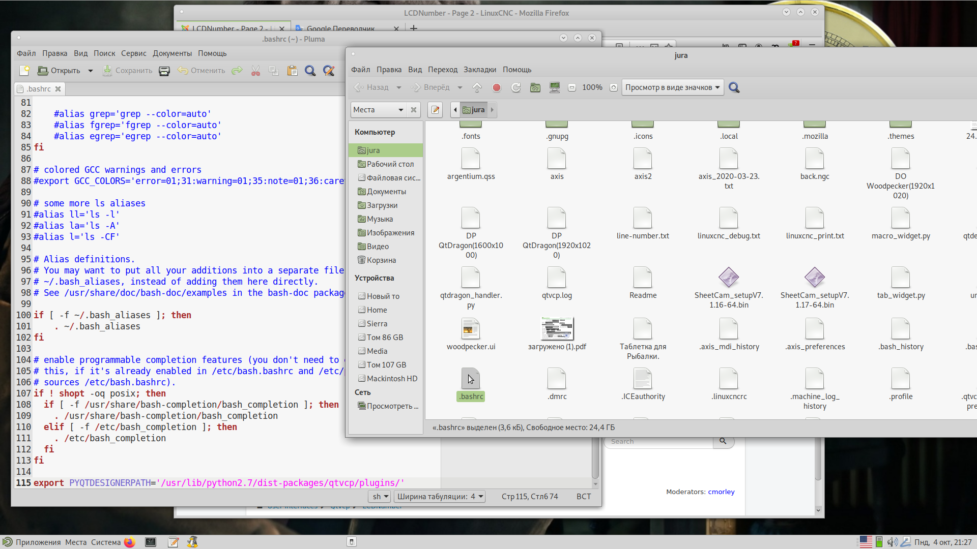

/usr/lib/python2.7/dist-packages/qtvcp/plugins/qtvcp_plugin.py -> ~/.designer/qtvcp_plugin.py
Should be:
-> ~/.designer/plugins/python/link-to-qtvcp_plugin.py
maybe this helps? (for 2.8)
github.com/LinuxCNC/linuxcnc/tree/2.8/lib/python/qtvcp/designer
Should be:

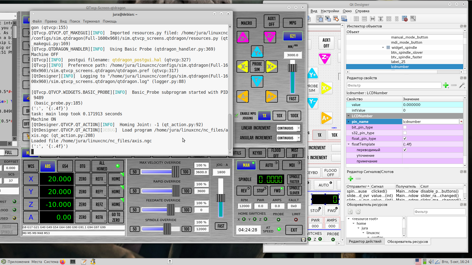

I'm back here, Chris, I changed from an iso LinuxCNC 2.8.2 installation to the following, is this okay?
Buildbot Packages List
Master branch (development - 2.9)
Buster (arch: amd64)
uspace: realtime with RT-Preempt, and simulation
deb buildbot.linuxcnc.org/ buster master-rtpreempt
deb-src buildbot.linuxcnc.org/ buster master-rtpreempt
and then to install designer qt5 in master, how should i do this?

For linuxcnc 2.8.2, I do it as in the attached instructions. The script did not work for me.
Last edit: 04 Oct 2021 13:27 by hottabich.

In master branch there is an updated script:
linuxcnc.org/docs/devel/html/plasma/qtpl...c.html#qt-dependency

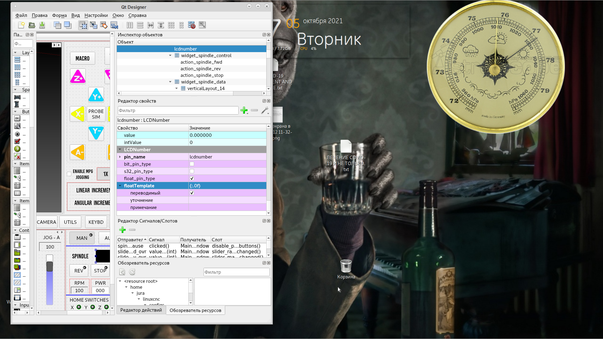

Linuxcnc 2.8.2 not working after upgrade lcdnumber. Please tell me how to fix it. Sorry, I already corrected it with the help of the designer.
