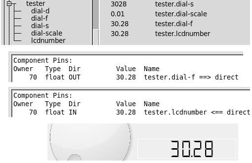

If you mean you want the formatting as it was before - change floatTemplate to an empty stringLinuxcnc 2.8.2 not working after upgrade lcdnumber. Please tell me how to fix it. Sorry to bother you already.

However, this is in 2.8.2 with corresponding restrictions, particularly with regard to formatting
please look in documentation 2.9
linuxcnc.org/docs/devel/html/gui/qtvcp_w...l#_lcd_number_widget
Replied by partec on topic LCDNumber

Thanks, I already fixed it. In the message I
gave a screenshot of how I fixed it. Linux 2.9 is not interesting to me.
