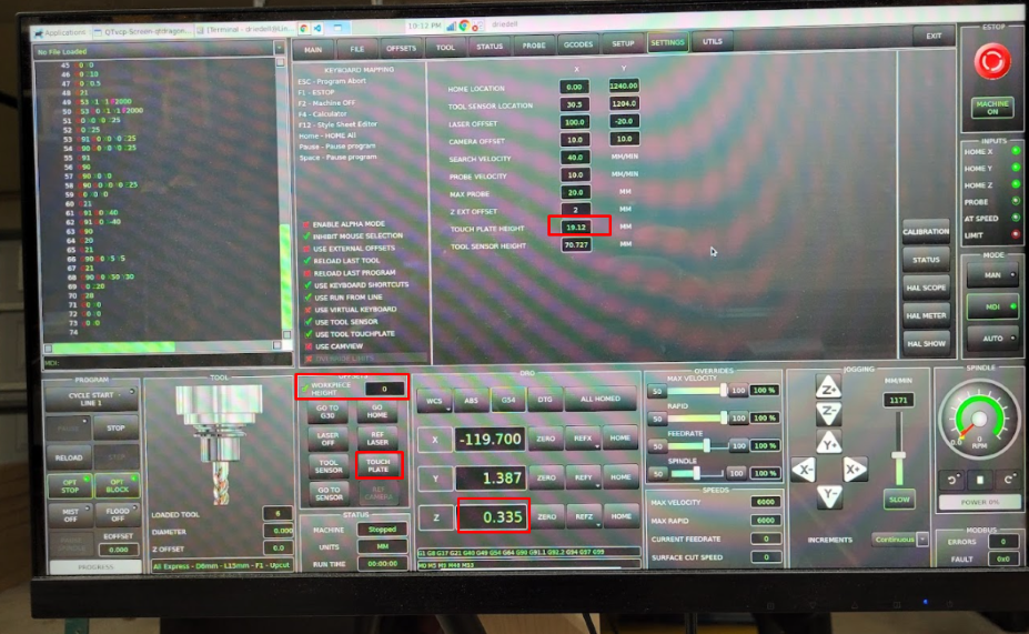

09 Dec 2021 21:38 #228752
by ucancallmebob89
Replied by ucancallmebob89 on topic How to select qtdragon_hd?
@cmorley thanks for all your help so far.
I'm seeing some weird behavior when trying to set up my touch plate. Here's the procedure I'm following:
Also, what is the WORKPIECE HEIGHT field in the OFFSETS section used for?
- Measure the touch plate height with calipers and enter it under SETTINGS > TOUCH PLATE HEIGHT (it's 19.12mm)
- Connect alligator clip to bit and put touch plate under the bit within 20mm
- Press TOUCH PLATE button
- The Z axis moves down until the bit contacts the touch plate, then backs off slightly

10 Dec 2021 04:53 #228769
Replied by cmorley on topic How to select qtdragon_hd?
First off, I'll disclose that I didn't make qtdragon so I don't always know perfectly the intentions of behavior.
Saying that - My understanding is after probing, the G54 Z setting should set zero at the bottom of the touch plate.
(so yes just as you thought)
workpiece height is used with sensor height when using a tool height sensor probe.
You can look at the python code here:
github.com/LinuxCNC/linuxcnc/blob/ca4317...n_hd_handler.py#L904
(I do see some problems if using imperial mode with probing)
Chris
Chris
- Posts: 7368
- Thank you received: 2181
10 Dec 2021 05:17 #228771
I do see an apparent error with probing...
line 923 is not right - that is the lift up move to reprobe - but it returns without reprobing.
It would leave the machine at 4mm above the last probe - which is pretty close to what your image shows.
Chris
Chris
- Posts: 7368
10 Dec 2021 06:11 #228772
I have pushed a fix for this. HD now uses the same routine as qtdragon and should work properly (and in metric or imperial)
