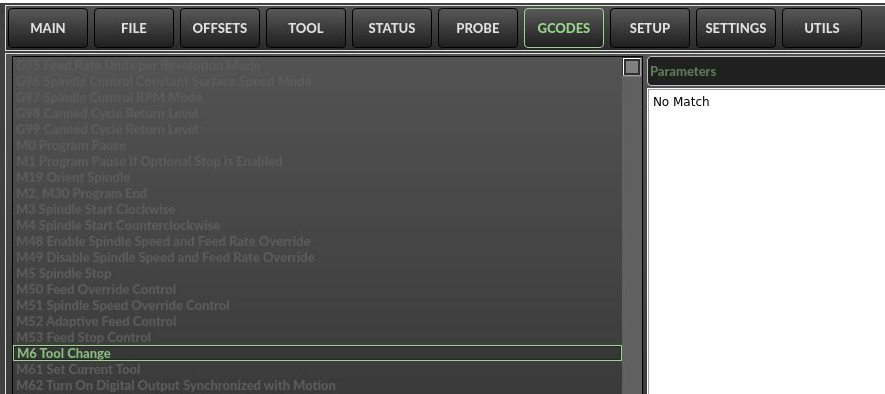

Ok so my previous post isn't right, that tab is just displaying descriptions of various gcodes from ~/linuxcnc-dev/lib/python/qtvcp/lib/mdi_text.py.
But I'm still pretty sure it has something to do with my toolchange configuration.

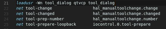

www.forum.linuxcnc.org/21-axis/42888-how...axis?start=10#213214
This fixed it. Looks like it was a problem with the dialog. This is the tool change section in my postgui file now:
Troubleshooting this only took 3 days, but hey, that's linux for you I guess.

24 Dec 2021 02:49 #229851
Replied by cmorley on topic Can't run first job with qtdragon_hd
So loading the tool_dialog is not necessary - it's included in the screen code.
I seem to remember you have multiple entries for tool change - some commented out.
I also fixed the LED color problem - the limits were like that too.
