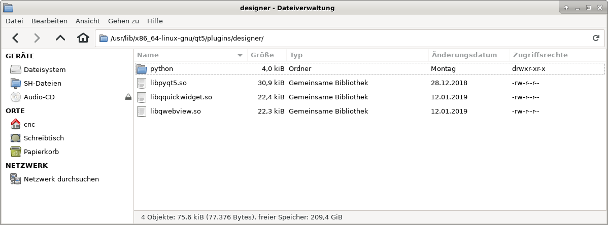

When starting qt5 in a terminal, there are no linuxcnc widgets and after closing qt5, there is following error:
File "/usr/lib/python2.7/dist-packages/hal.py, line 30, in <module>
ModuleNotFoundError: No modules named '_hal'
A file '_hal.py' didn't exist and i don't know why. How can i eleminate this error?

what do you see in the folder:
/usr/lib/x86_64-linux-gnu/qt5/plugins/designer

01 Feb 2023 01:55 #263424
by HiSH
Replied by HiSH on topic qt5 no module named '_hal'
sorry, the i try to send the image as attachment.

01 Feb 2023 22:25 #263493
Replied by cmorley on topic qt5 no module named '_hal'
Ok the file libpyqt5.so is most likely the python3 version, you need the python2 version.
you need to find out the qt version you are using, if you open designer and look in ABOUT qt, it should tell you - something like 5.7.1 version.
This is the readme that explains the problem:
github.com/LinuxCNC/linuxcnc/blob/2.8/li.../designer/README.txt
There is a file 'install_script' that can be run to automate the changes:
It should be here on your system:
/usr/lib/python2.7/dist-packages/qtvcp/designer/install_script
