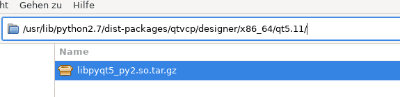

As you told me, i did:
>>/usr/lib/python2.7/dist-packages/qtvcp/designer/x86_64/qt5.11
Yes, the archive was present there. (picture1)

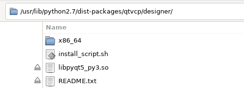

>>it needs to be extracted and put in:
>>/usr/lib/x86_64-linux-gnu/qt5/plugins/designer
>>The existing file named libpyqt5.s0 must be renamed libpyqt5_py3.so
Done. (picture2)

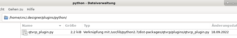

>>then you need to create a link in:
>>~/.designer/plugins/python
>>that points to:
>>/usr/lib/python2.7/dist-packages/qtvcp/plugins/qtvcp_plugin.py
Done (picture3)

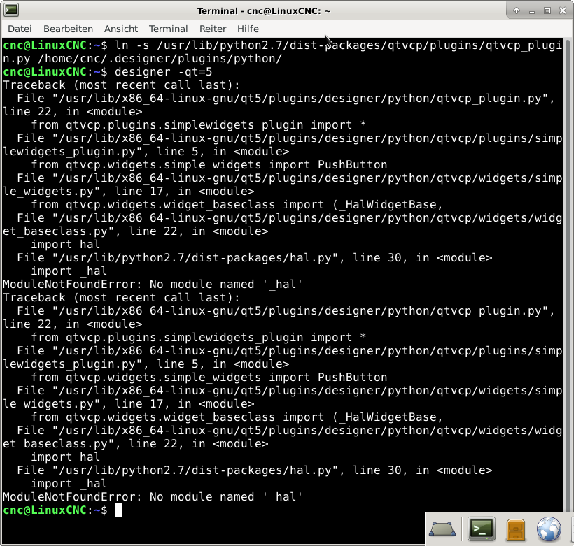

>>Then you should see the widgets in designer or some error messages about a few missing libraries, which we can address if they happen.
Unfortunately the error remains. (see picture4)

- phillc54
- Posts: 5711
- Thank you received: 2100
13 Feb 2023 04:25 #264414
by phillc54
Replied by phillc54 on topic qt5 no module named '_hal'
The directory that you show in picture2 is /usr/lib/python2.7/dist-packages/qtvcp/designer
It is supposed to be /usr/lib/x86_64-linux-gnu/qt5/plugins/designer
