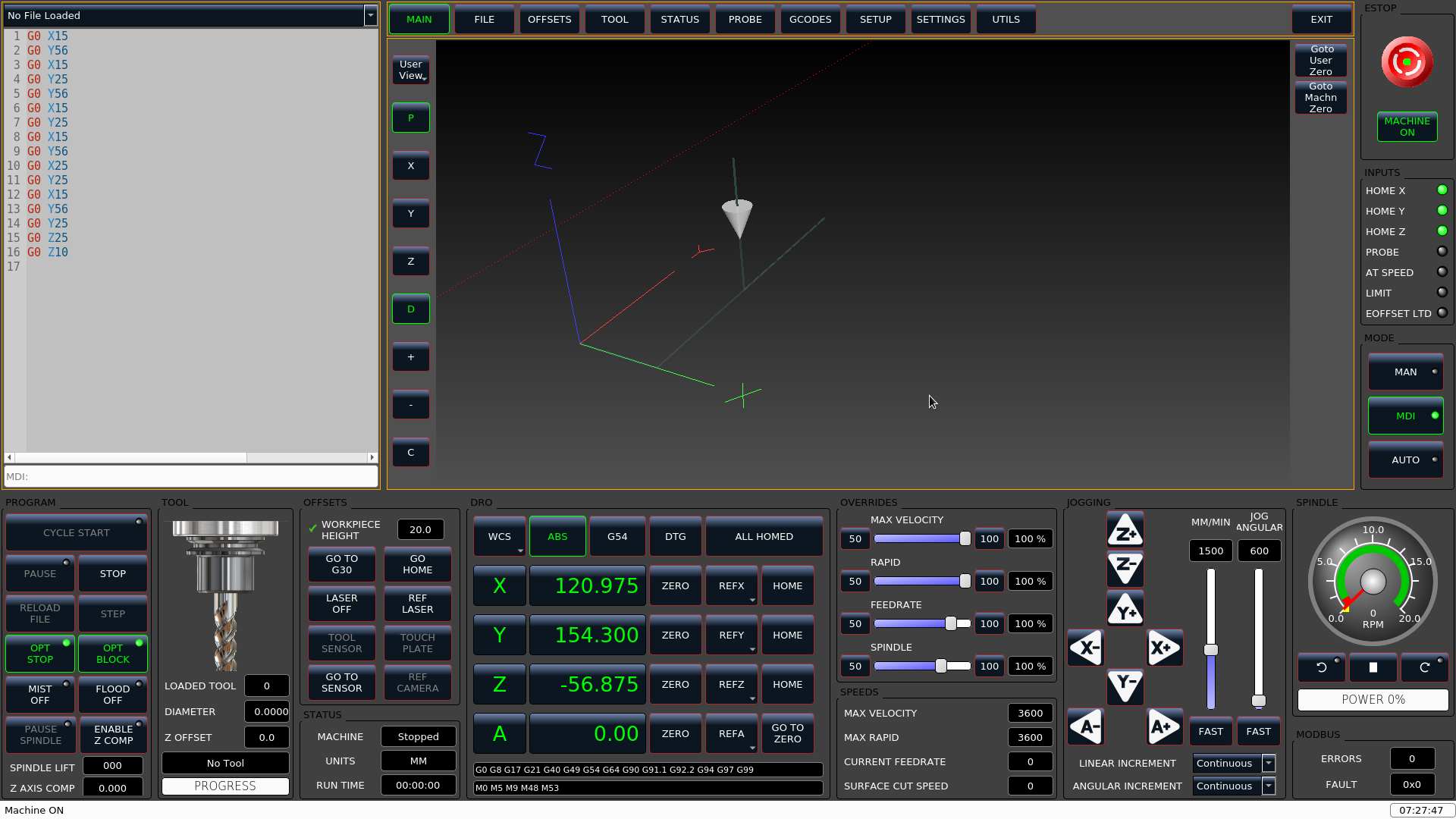

QTDragon MDI jogging strange - diagonals

Hi all
I have done an update to
LINUXCNC - 2.10.0-pre0-929-ga1380a39d
and it still seems to be doing the same thing.
Alex

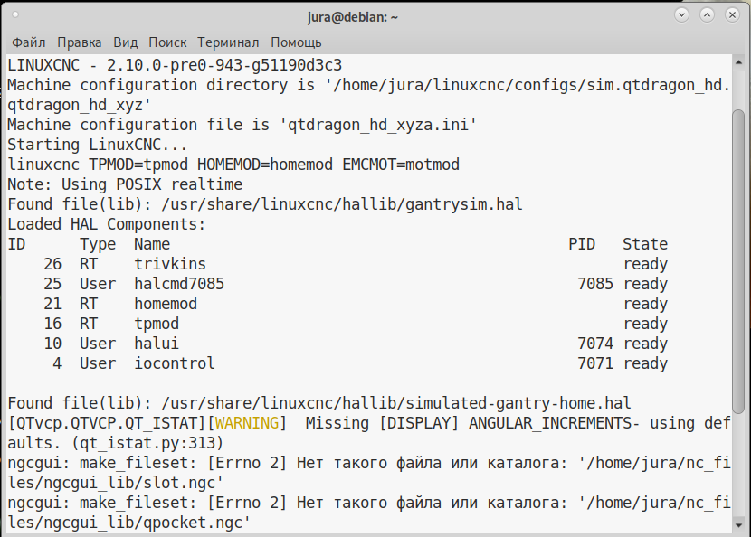

03 Mar 2023 11:38 #265789
by hottabich
Replied by hottabich on topic QTDragon MDI jogging strange - diagonals
It does not move diagonally, but it does not work correctly. Instead of +, it moves to - when moving again to +. Maybe the update hasn't reached me yet?

03 Mar 2023 12:14 #265795
Replied by cmorley on topic QTDragon MDI jogging strange - diagonals
if you post mdi_line.py , I can tell you if you have update.

03 Mar 2023 14:08 #265800
by hottabich
Thank you for your attention! Here is the widget.
