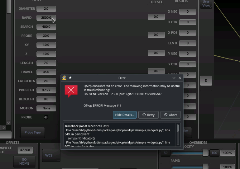

Hi, i'm running linuxcnc on bookworm and did the apt install method for linuxcnc. If i choose versaprobe in the ini and click the tab in qtvcp, i get this message and qtvcp-hd exit .
thanks, Michael
thanks, Michael

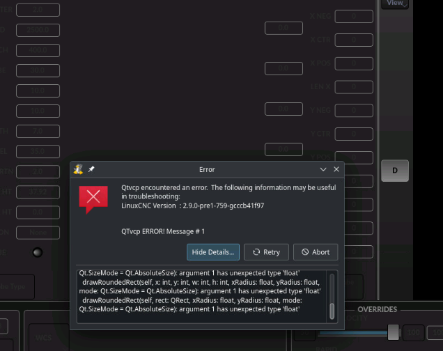

Thanks, but i have now (intel graphic):

installed linuxcnc-uspace_2.9.0~pre1.759.gcccb41f97_amd64.deb

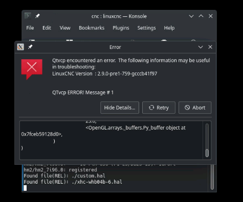

Here we go....
As additional info, i did an upgrade from bullseye. Maybe i should start with a fresh install.

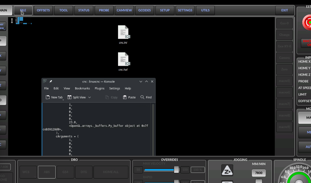

So i did a fresh install, no change. 2.9 has not the opengl error, but crashes at the versaprobe screen. 2.10 has the opengl error, starts with the retry function and has a "garbage" main window. Crashes also with the versaprobe window.
Fresh bookworm install with an intel onboard grafix chip.

Thats showing an OpenGL out of memory error so it's not related to probing.
What graphical environment are you using? SOunds like the default gnome desktop
Can you log out and; once back to the logon screen, with the cursor in the password field, click on the gear icon at bottom right and select a Xorg environment? eg gnome on xorg
I always recommend running xfce. you can install thet with
sudo apt install tasksel
sudo tasksel
select xtce and continue.
sudo tasksel
