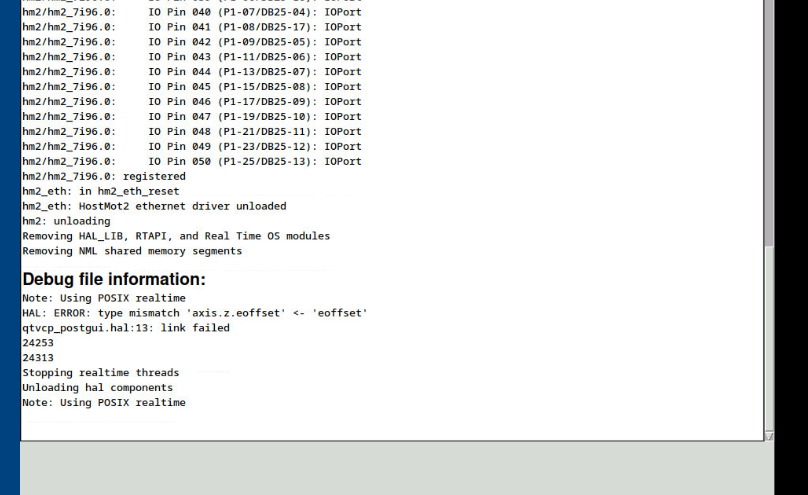

Hi, i followed the docs to include "Auto Raise Z Axis on Spindle Pause", but get an Error, when starting:
linuxcnc:HAL: ERROR: type mismatch 'axis.z.eoffset' <- 'eoffset'

12 May 2023 03:29 #271211
Replied by rodw on topic qtvcp-hd 2.10 spindle-auto-raise error
Can you comment out that problem line so you can oopen the GUI.
Then use halshow to find the pin qtdragon.eoffset-value
And check its type. It should be float.
Sounds like Chris has something wrong but it will be good to trouble shoot a bit before he gets on the job.
You might be able to use one of the conv_ components to correct it as a temporary measure.

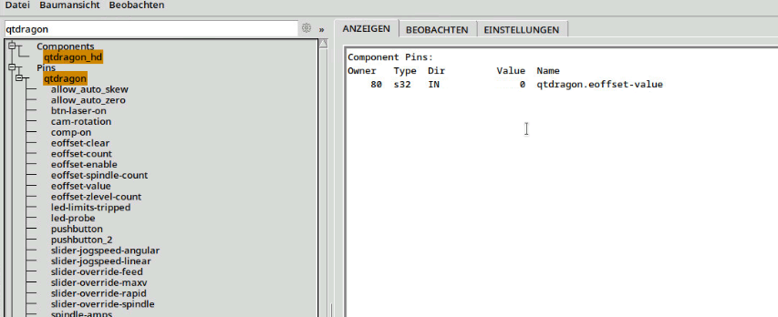

12 May 2023 03:37 - 12 May 2023 03:44 #271213
by zu4lu
Replied by zu4lu on topic qtvcp-hd 2.10 spindle-auto-raise error
s32, sounds like float? (edited: now the right screenshot, sorry)

- Posts: 12172
- Thank you received: 4154
12 May 2023 04:12 #271216
Yes, the GUI pin has the wrong type.
You can use conv_s32_float to convert to the correct type if you want to get the machine working...
linuxcnc.org/docs/2.9/html/man/man9/conv_s32_float.9.html
