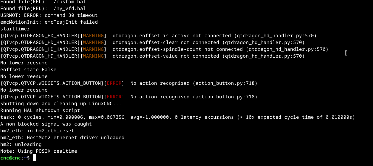

Replied by cmorley on topic QTdragon HD with MDI issue
Does the screen fail to load or is it just the messages?
- vre
- Posts: 612
- Thank you received: 17
10 May 2024 07:43 - 10 May 2024 07:46 #300317
by vre
Replied by vre on topic QTdragon HD with MDI issue
It is just in messages screen loads ok.
This message is after press exit->shutdown
/bin/sh: 1: gnome-session-quit: not found
Running HAL shutdown script
Does it shutdown though?
The button calls this:
def SHUT_SYSTEM_DOWN_PROMPT(self):
import subprocess
try:
try:
subprocess.call('gnome-session-quit --power-off', shell=True)
except:
try:
subprocess.call('xfce4-session-logout', shell=True)
except:
try:
subprocess.call('systemctl poweroff', shell=True)
except:
raise
except Exception as e:
LOG.warning("Couldn't shut system down: {}".format(e))

No it doesn't shutdown the pc only linuxcnc exits i have debian12-xfce
exception not thrown in case of missing gnome-session-quit but this is minnor
The other error message seems more serious.

Linuxcnc expects a Xorg desktop. The distribution images use XFCE for this reason
Gnome by default uses wayland which is very problematic for Linuxcnc. You can change to use Xorg from the Gnome logon screen

I have xfce with xorg.
also pause button throws some error mesages to terminal

Can you post the error messages?

One of the QtPlasmac (Greg) developers came up with.
Thanks for mentioning the problem.
A fix for shutdown (I think) has been pushed to 2.9/master today.Does it shutdown though?
def SHUT_SYSTEM_DOWN_PROMPT(self): import subprocess try: try: subprocess.call('gnome-session-quit --power-off', shell=True) except: try: subprocess.call('xfce4-session-logout', shell=True) except: try: subprocess.call('systemctl poweroff', shell=True) except: raise except Exception as e: LOG.warning("Couldn't shut system down: {}".format(e))

The [ERROR] message is after pause button inside qtdragon.
