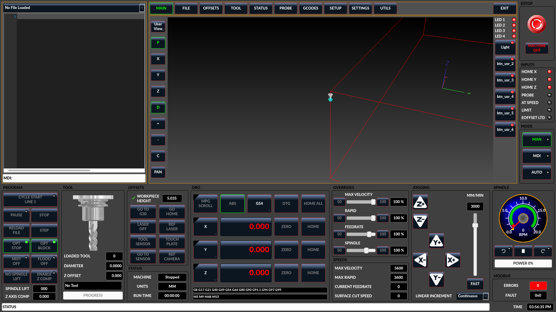

02 Jan 2025 15:04 #317883
by Muftijaja
Replied by Muftijaja on topic qtdragon additonal buttons
cmorley, that screen looks very good! Would you share this with me? How can i install it, I am running that normal QTDragon for a while and was missing some of the buttons integrated here.
Thanks in advance!
Thanks in advance!
- Posts: 7368
- Thank you received: 2182
03 Jan 2025 19:44 #318004
Replied by cmorley on topic qtdragon additonal buttons
The screen shown is a modded qtdragon_hd so requires a larger monitor.
I can't find the original topic on the forum here, but I do have a copy of the .ui file
You would put this file in YOUR_CONFIG_FOLDER/qtvcp/screens/qtdragon_hd/qtdragon_hd.ui
The following user(s) said Thank You: Muftijaja

25 Jan 2025 02:42 #319806
by Mr. Mass
Replied by Mr. Mass on topic qtdragon additonal buttons
Tried to install this modified screenset but got a lot of errors. If I understand correctly here I need a modified handler.py file too?
