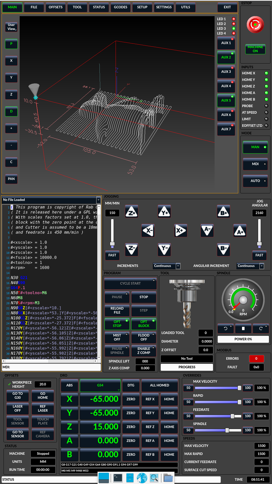

I was unclear, I meant how to increase the font size in those menus.
- Posts: 7368
- Thank you received: 2182
07 Feb 2025 01:56 #320890
Replied by cmorley on topic qtdragon additonal buttons
Look for something like:QComboBox {
font: 10pt "Lato Heavy";
set the 10pt bigger
set the 10pt bigger

Oh, Man i just rebuilt my cnc and I wanted to rebuild the screen for portrait.
But I have been trying to learn qtdesigner. And just have not had the time to give to the project. this is wonderful!

im sorry if this is a dumb question how do i implement this
i have downloaded the qtdragon_hd_vertical.ui.
how do i load i up.
how do i load i up.

In terminal "qtvcp copy", check "qtdragon_hd", name "qtdragon_hd_vertical" for your case, then ask you to create folders, agree, ask for copy, agree also. Now in your home folder will be qtvcp/screen/qtdragon_hd_vertical. Copy and replace qtdragon_hd_vertical.ui from this topic and replace/rename handler file from here - forum.linuxcnc.org/qtvcp/54731-qtdragon-...tons?start=20#320578
In your .ini file replace DISPLAY = qtvcp qtdragon_hd_vertical

thanks i will give this a try tonight.
i did not know ther was a "qtvcp copy" tool
i duplacated the directory and replaced the ui fie and renamed one ot two others.
that obiously did not work.
thanks for your help.
