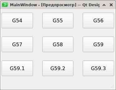

Replied by cmorley on topic qtdragon additonal buttons
Ahh OK I get it - interesting.Yes, the G5x button works when long pressed, thanks.
Well, I thought you could call up a calculator-like window, something like that:
perhaps for now adding this to the stylesheets will suffice:
QMenu::item {
padding: 2px 25px 2px 20px;
font: 24pt "Lato Heavy";

02 Feb 2025 02:24 #320395
by Mr. Mass
Replied by Mr. Mass on topic qtdragon additonal buttons
Almost perfect, thank you!
A couple minor issues:
1 - the calculator call works only for X Y and Z axis, but 4 and 5 axis are not, still drop-down menu
2 - if you enable the virtual keyboard, the “set X origin” window appears instead of the calculator window and the virtual keyboard does not work at all
If possible, make the calculator window appear regardless of whether the keyboard is enabled or not, it is much more convenient.

04 Feb 2025 00:42 #320578
Try these:

04 Feb 2025 07:32 #320605
by Mr. Mass
It works, thanks a lot for your help!
