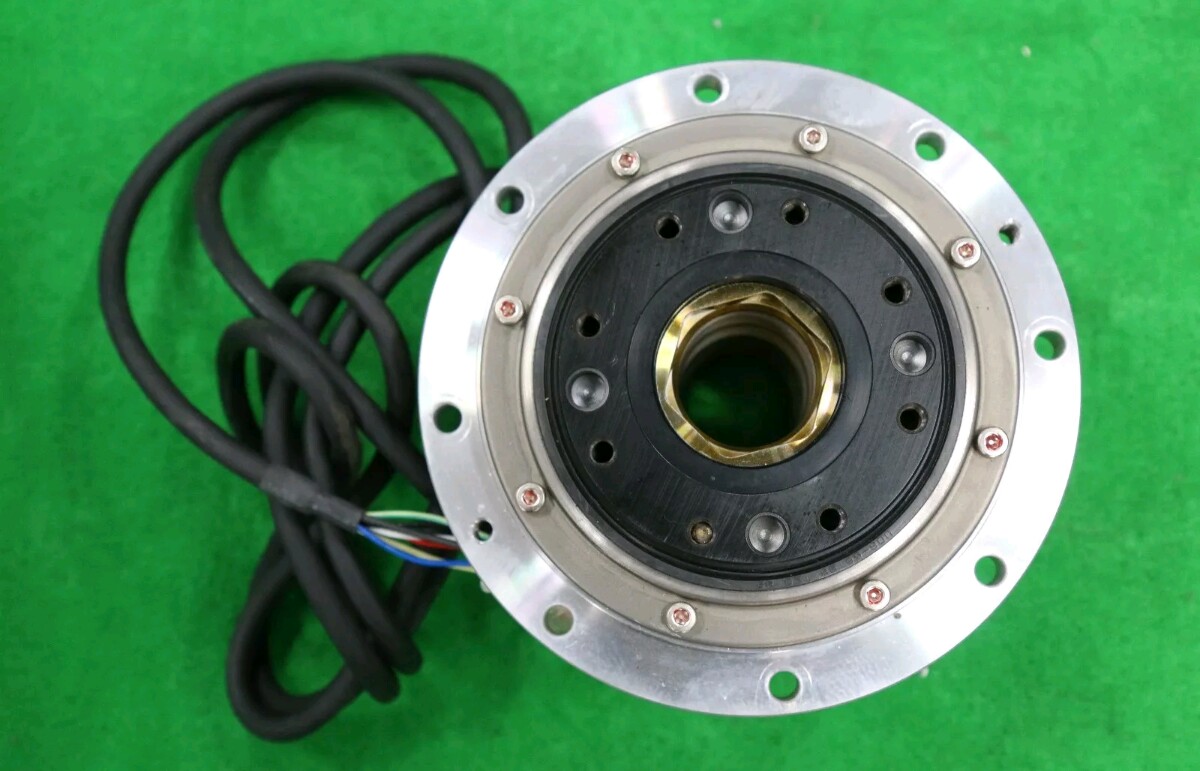

13 Oct 2016 12:43 #81620
by Lcvette
Yeah that's what I'm thinking too! Here is one of the units in considering:
Replied by Lcvette on topic 4th Axis Build
The united I've been looking at are different, they appear to be a housed unit with a cross t roller bearing
Those sound perfect.
- Posts: 19904
13 Oct 2016 13:57 #81624
Replied by andypugh on topic 4th Axis Build
The FHA look like they make a rotary axis almost too easy.
- Lcvette
- Posts: 1682
- Thank you received: 784
13 Oct 2016 17:14 #81626
by Lcvette
I know right! That was exactly what I thought where I saw it.. I just received a step file of the FHA 25-100 e250 which looks perfect for an 8" rotary table build. If you would like a copy let me know! Email This email address is being protected from spambots. You need JavaScript enabled to view it..
Chris
Chris

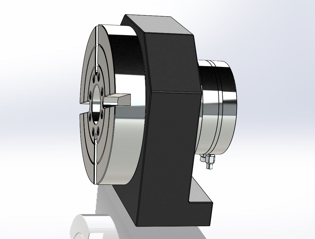

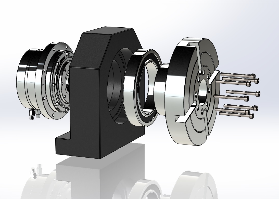

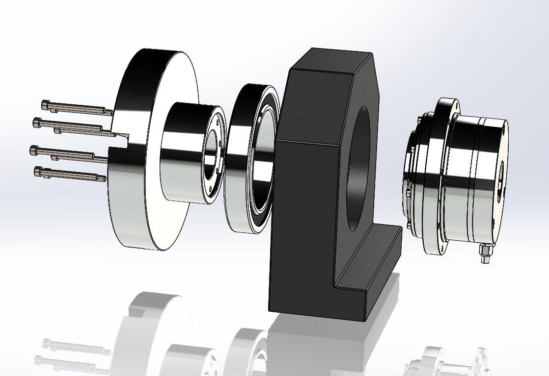

13 Oct 2016 23:58 #81634
by Lcvette
I whipped this up, it is an 8" Rotary Table design, it isn't finished, but it works out to be 4 parts, the harmonic drive, the frame casting, the table and a cylindrical roller bearing for table support right at the frame edge behind the table. the thrust load will be on the cross roller bearing in the harmonic drive to keep things compact. depth from the table face to the back face of the harmonic drive is 6" pretty good. from the table face to the back edge of the frame casting is 5". I think this is about as simple of a design as you could have, the table would be made from a solid casting and machined to finish. it bolts directly to the harmonic drive so no slop can be introduced into the system. the only backlash in the system will be what the harmonic drive has in it which should be very very low. I think this is a winnder! Thoughts?
- Posts: 19904
14 Oct 2016 04:12 #81636
What is your lathe spindle nose? (assuming you have a lathe). If it is camlock then you could consider adjusting the T-slot number to fit camlock pins between them. (you could have a loose spigot for centering).
Consider tool access to the work for small diameters too.
You might want to copy your milling machine spindle taper in the centre of the rotary. You can then hold smaller work in collets easily.
This is a real-world 4th-axis job I had to use an overlength piece of stock to get the tool to the work. Often you are likely to end up with a small spigot on the stock held in a collet just to get tool access to the end.
