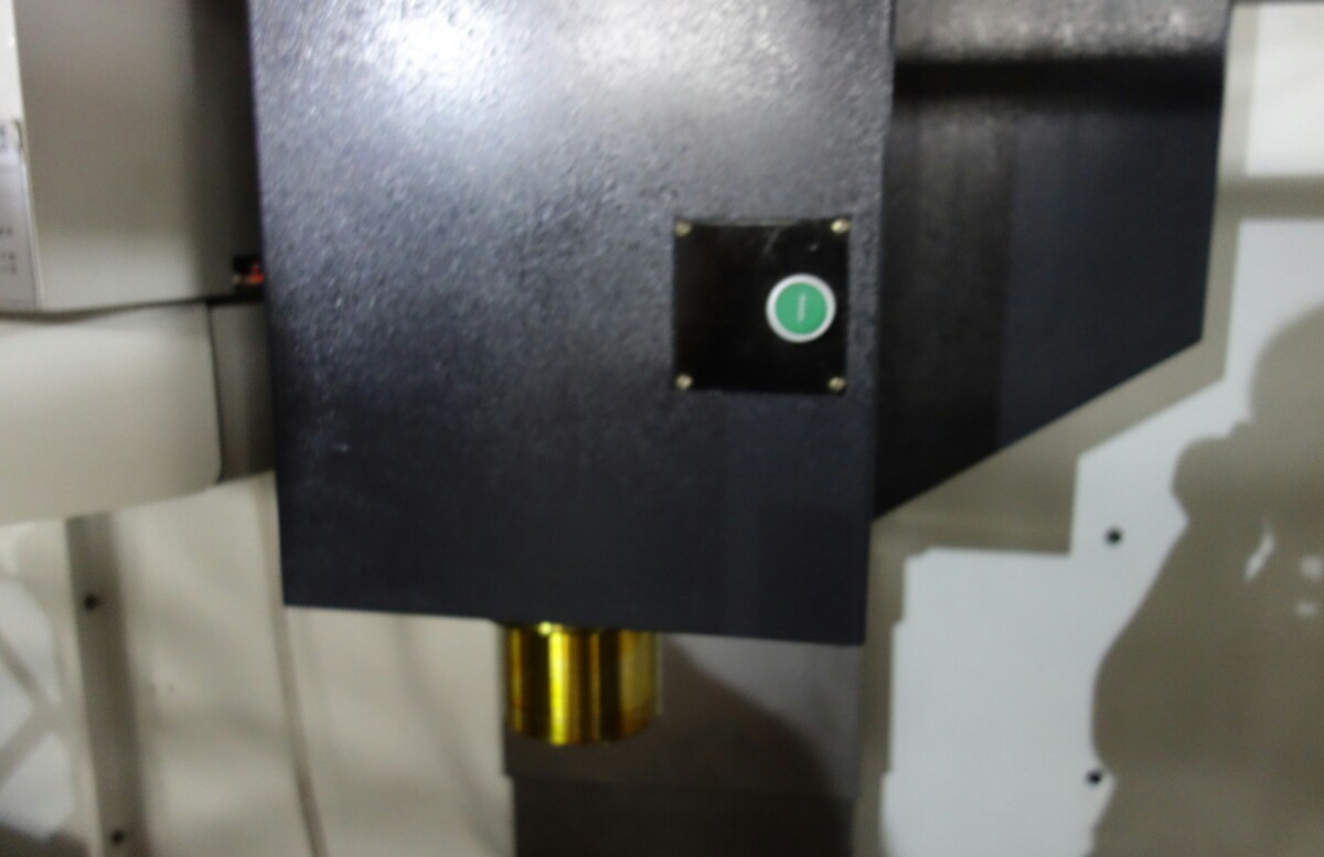

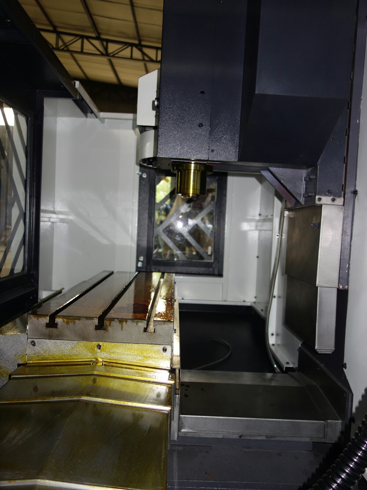

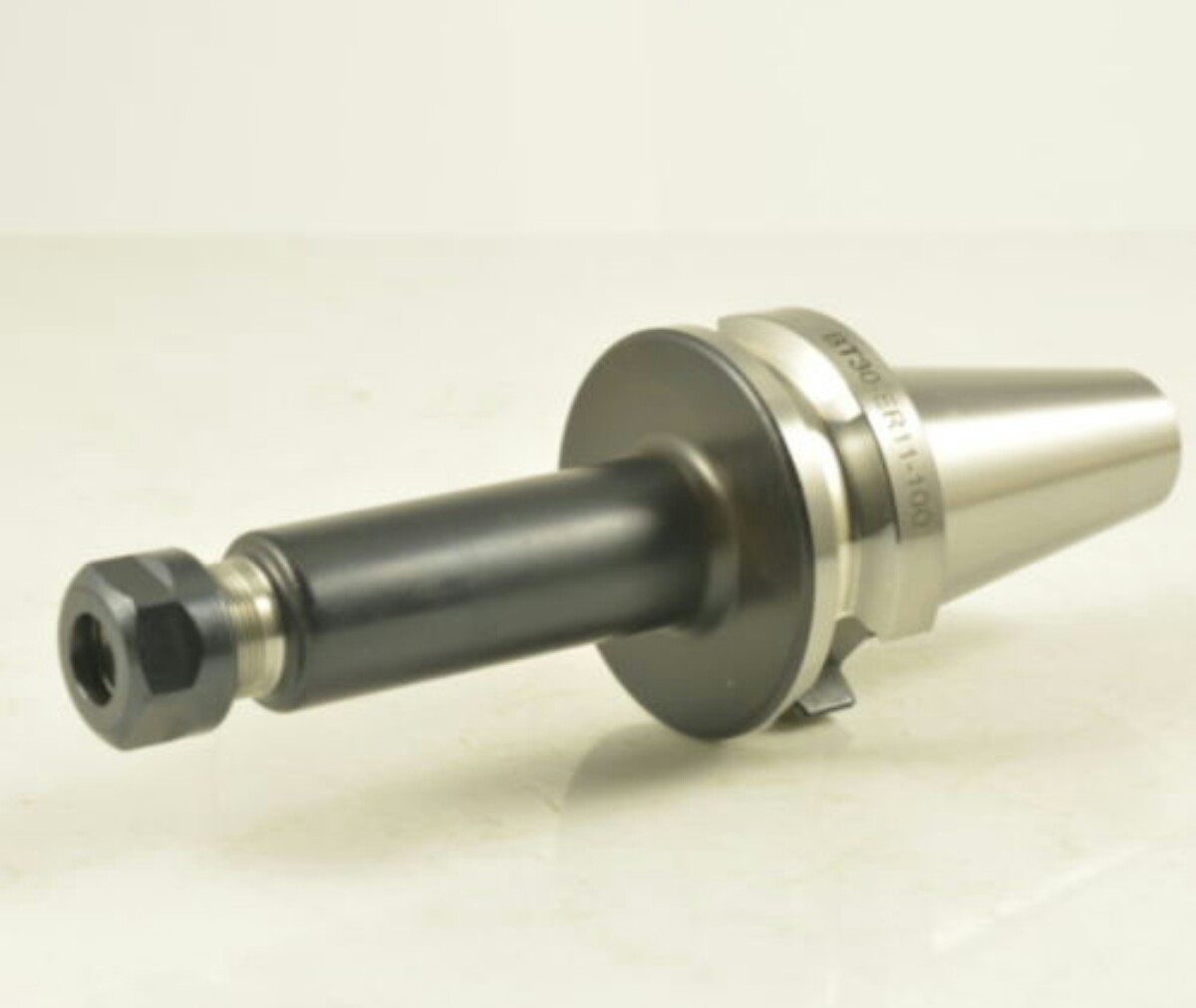

For my application the rotary is going to be used for a 6" X 6" X 24" tombstone for production work. So I won't have to get down toward the center for this setup. But those are excellent points. My mill spindle is a BT30. My lathe is a bolt on stud and nut (benchtop machine). I do like the idea of a camlock setup, just have no experience with them. Will have to take a look at it and do some research. I will also play around with mounting a 5C chuck on the table face send see how the spindle clearance looks, that may give some extension to get a tool down near the center without interference from the spindle nose. Worst case scenario i soul grab some BT30 extended ER11 tool holders for small diameter 4th axis work.
Here are some pictures of the mill spindle and the tool holders I was thinking about to solve being able to f do both fine small work and larger tombstone production work:
