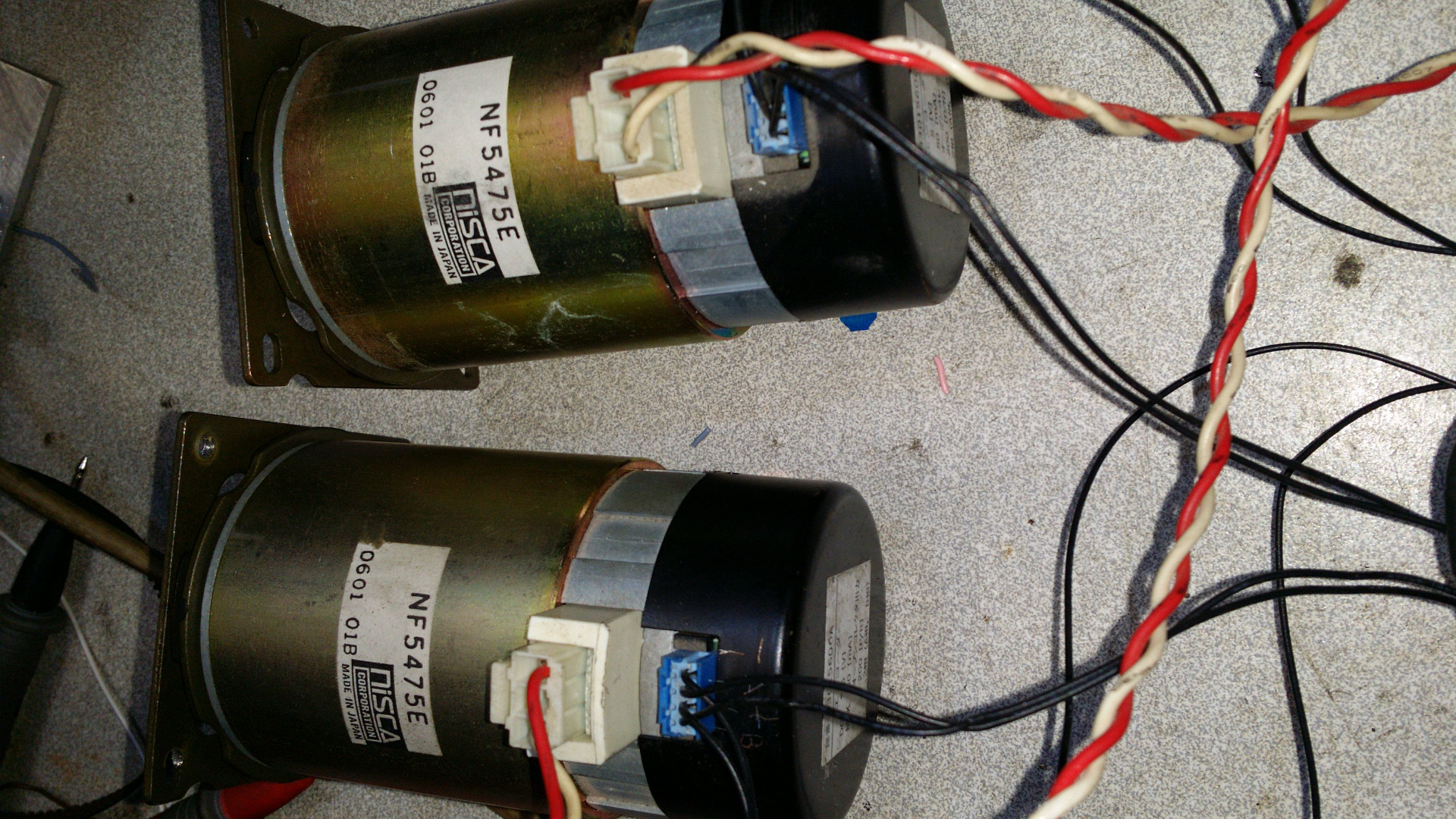

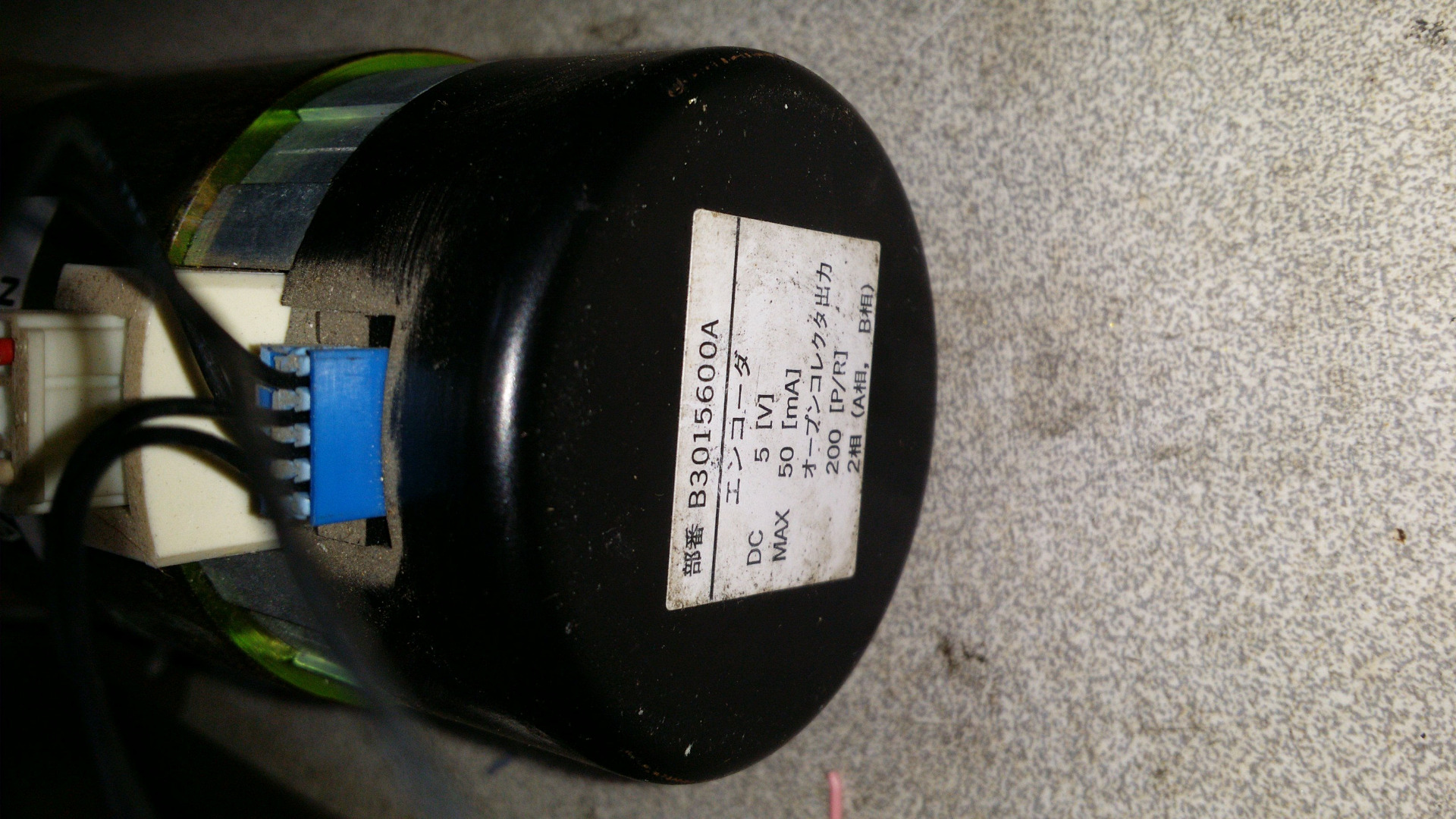

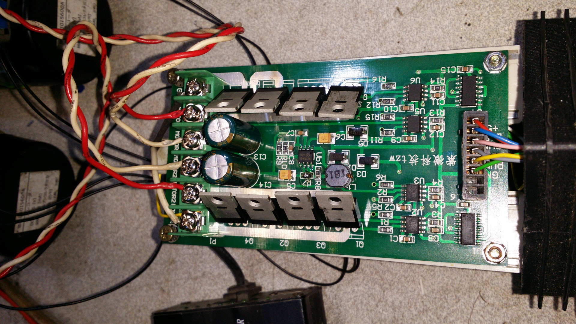

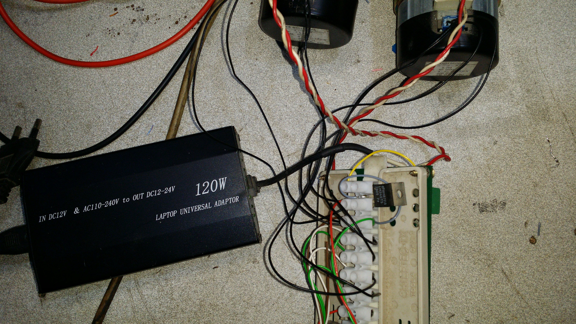

Here are some PWM drives bought on ebay for 22 euro a piece and it drives 2 motors at 36V and 10A with no cooling, or over 30A with proper cooling.
Used the "etch servo" config as a base for it and modified it with PWM and encoder monitoring.
Took a lot of trial and error, but they do work quite nicely and i think they can do a decent job on a small hobby machine, and as a useful tool to understand servo drives and PID loops etc.
Video
The following user(s) said Thank You: coolfox, snoozer77

24 Oct 2016 23:03 #82017 by tommylight
Replied by tommylight on topic Servo drives costing 22 euros for 2 motors
so this is basically a H bridge that the pwm is controlled by the PID of linuxcnc? It should be interesting attach a load to the motors ans see how it preforms.
recently I bought a IGBT module with hope of some of this days start to build a servo drive, something like that to start :)
Yes and i did connect them on a mill i am building, it takes quite some time to set them up properly, but it does pay off as they do work nicely and stop at 0.02mm max difference. I can live with that!
Then again they do not have current limiting, so i have to use power supply and motors that do not draw over 7-8 amp at stall.

24 Oct 2016 23:18 #82020 by tommylight
I use stmbl servo drives for some of my stuff. This are servo amplifieres for AC servos of aprox 1kW and does support mot feedback systems.
If you build them yourself yo will have to spend about 70 Euro for parts
stmbl servo
Norbert
Damn, those are nice.
I do have professional servo drives from NORWIN collecting dust, this is something i like to do, not something i need. I have around 20 of those small motors so it is useful for smaller machines that i build. I can also use one of those as a stepper drive, and configure Linuxcnc to drive it at half step, but then again i have plenty pf Gecko drives and other very powerful stepper drives i modified to push 15A per phase easily with current limiting and everything.
This was more to show other forum members that they can use Linuxcnc with some work a very little money to drive stepper motors ( there is an thread on this forum i did for cheapest stepper drives ever using 4 Darlington transistors and 4 resistors to drive one motor) or servo motors, at least they can have the control and drive system on the cheap, some scavenging for motors required ! At 2$ for a stepper and at 11$ for a servo, there is nothing cheaper.
Question: Those drives you mentioned, they use a IC for the power stage, right?
I intentionally chose exactly these drives as the mosfets can be replaced if the magic smoke escapes, in most cases the gate drive IC survive.
